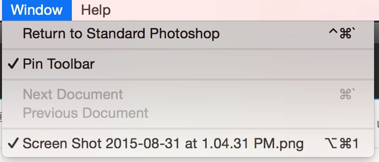

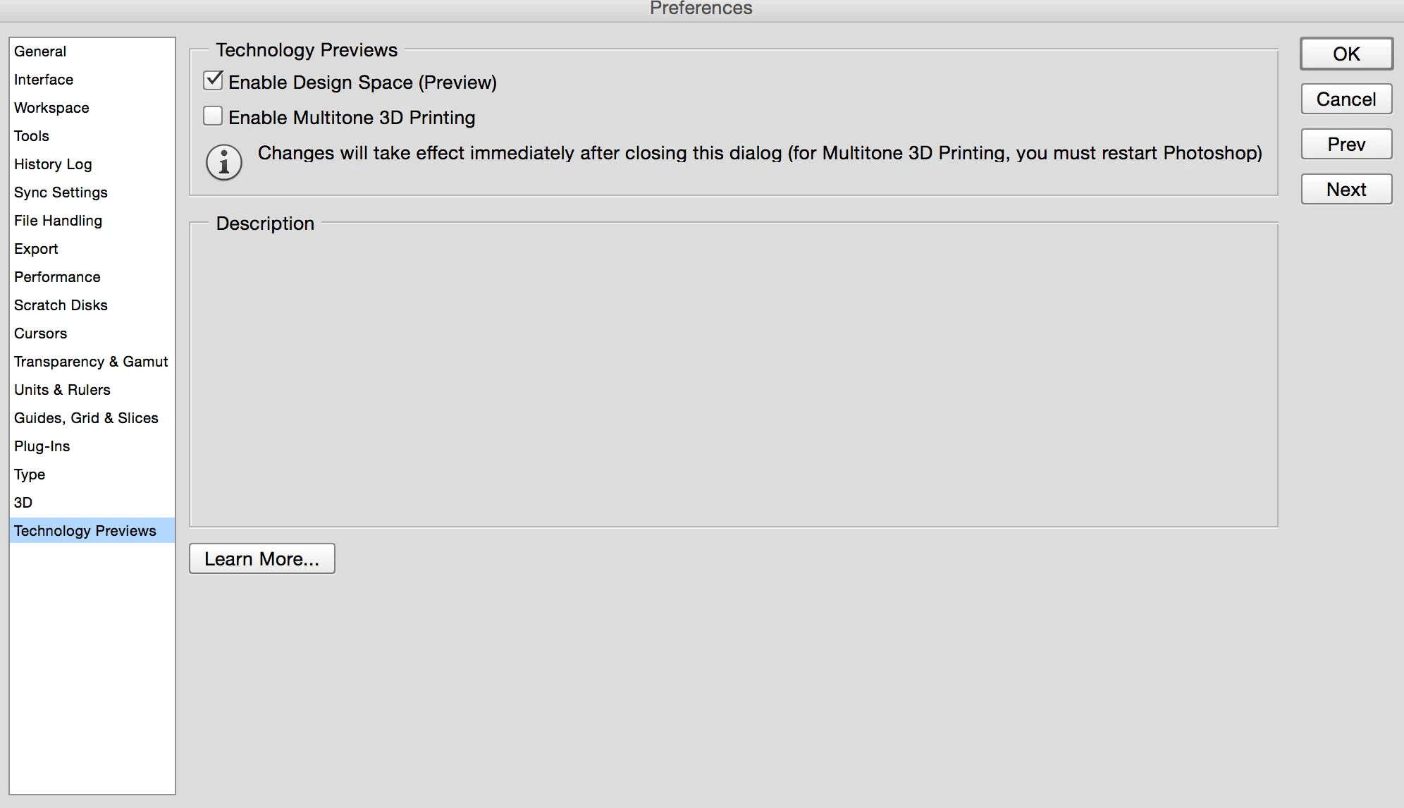

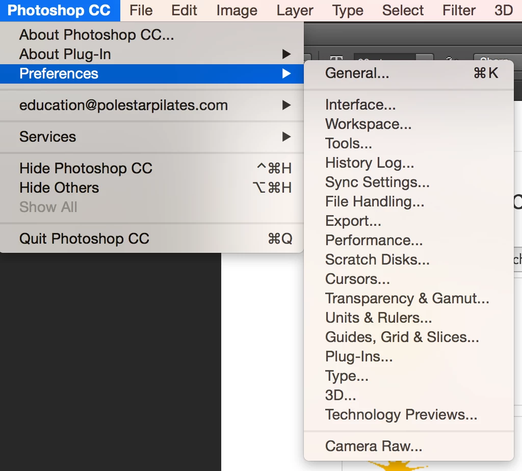

Hi guys! I know this is an old thread but as I see I am not the only one who had to look this up, I thought I'd fill you in on a feature Adobe added specifically for this reason.
If you check your preferences (at least in CC), there's a Technology Previews section. If you check the box next to "Enable Design Space (Preview), it'll send you to a photoshop workspace specifically for mobile/web. It'll look weird at first, and once you skip the tutorial, you can go to Window > Return to Standard Photoshop. Voila! 100% preview in the same reign as your browsers. This isn't a true 100% due to the explanations above on how retina screens work, but it is the 100% we need as web developers/designers and it isn't blurry.
