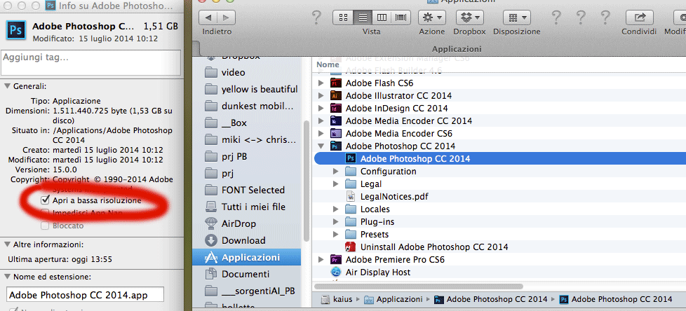

Jul 23, 2014 12:01 PM UTC
My friends found the real solotion to fix this problem.
Here the easy steps:
1) Close Photoshop.
2) In the finder open the Application folder.
3) Open the Adobe Photoshop CC 2014.
4) Select the file "Adobe Photoshop CC 2014" then push Apple+I (information). A small info window will be open.
5) Check the firt checkbox "Open in low solution".
6) Open Photoshop and enjoy.
I attach a printscreen, is in italian but you can understand the position of the checkbox.
Enjoy and thanks to Luca e Niccolò to have found the solution
Noel Carboni
Jul 23, 2014 2:01 PM UTC
Kaius, setting the application to open at low resolution throws away your ability to use the full resolution of your wonderful Retina display.
To each his/her own, I guess.
-Noel
Jul 23, 2014 2:15 PM UTC
Yes but it fix the problem mentioned.
Without this metod is very uncomfortable working with 200% of zoom for a web project.
It's the best solution in my opinion.
