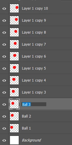

I didn't want to confuse things too much back up the thread, but there a few tricks to help  keep the right frames sync'd to the right frames.
An obvious tip would be to have layer names tally with frame numbers.  Unfortunately, Photoshop does not have a layer batch rename function, but you can streamline the process  a bit.
  1. Double click the first layer to highlight  its name, and give it a name plus a space.
  2. Select that text, and copy to clipboard  (Ctrl c)
  3. Double click again, and paste (Ctrl  v) and add the number
  4. With the name still highlighted, use Shift Tab which will move to the next layer and highlight its name.
  5. Paste in from the clipboard again, and add the next number
Make all but the last step into an action, and you can move up through the layers really quickly.
Or, if you don't mind a wee cost, install the Renamy extension  (Note:  I don't use this extension myself, so I am only guessing that it will increment the layer name.)  It does appear to have this feature according to the FAQ
http://www.klaia.com/Renamy/

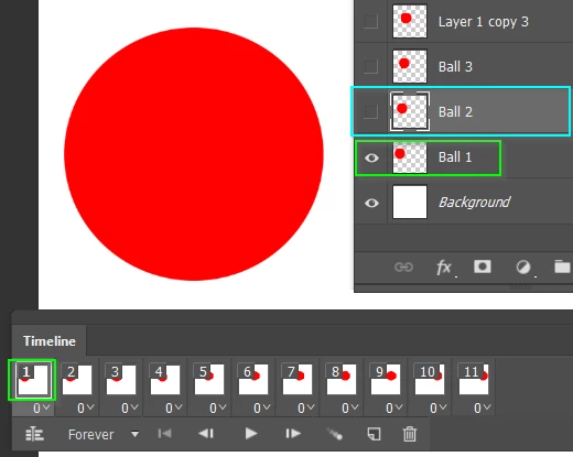

This is how I sync secondary moving objects.
Frame 1 is selected, and the Ball 1 layer is turned on.
I then select the next layer,  (cyan highlight) before returning to the timeline to select the next frame.
Then back to the layers panel, where the appropriate layer is selected, and so on.
If  you have 40 frames, it is very easy to get out of sync!
