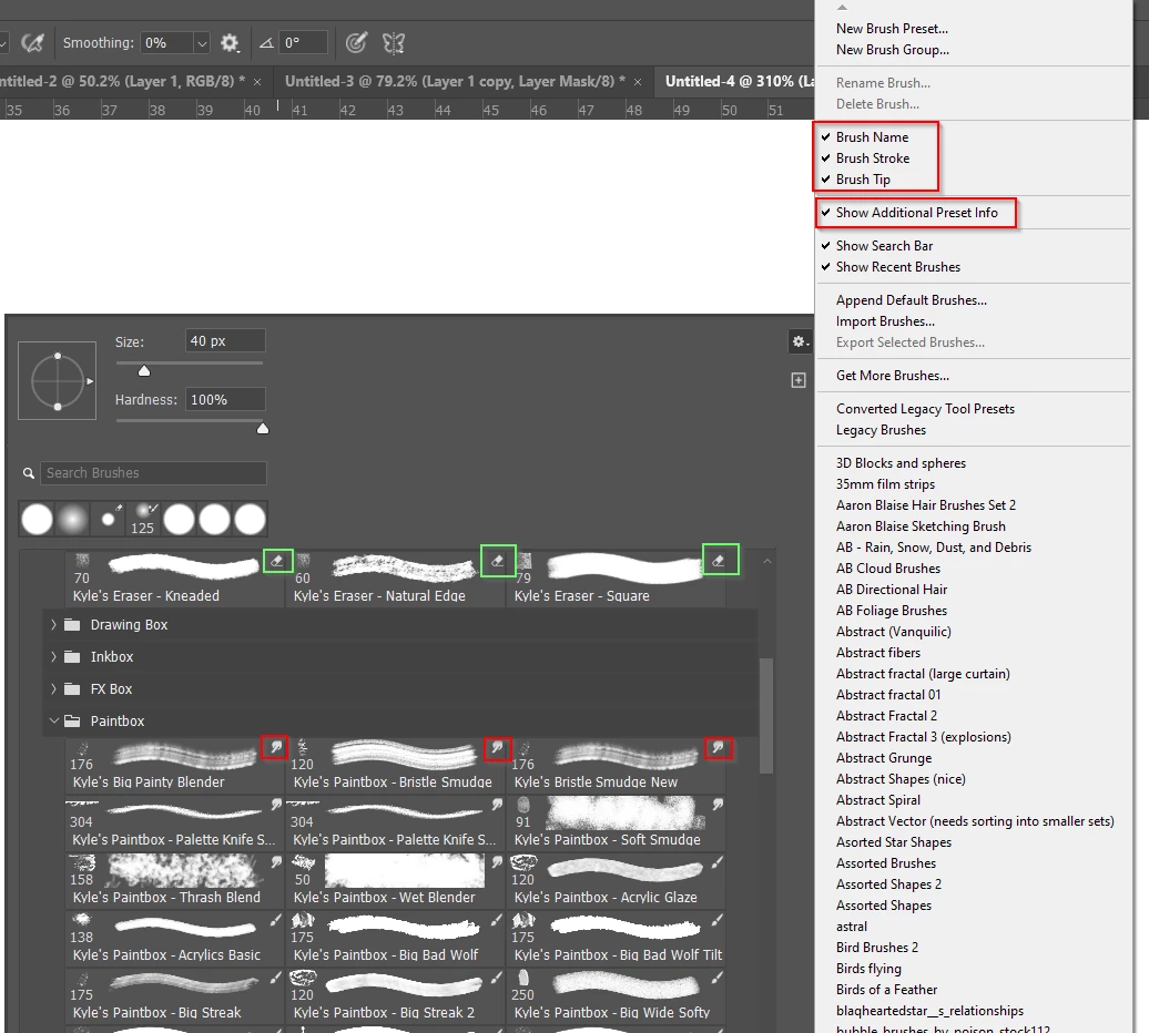

How do you have your right click brush panel set? If you have Show Additional Preset Info checked then you can see when presets have spcific tools set, and can chose to Ctrl click those presets if you absolutely want to use it for another tool type.  Or you can select presets better suited to that tool.

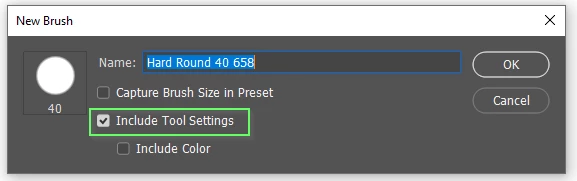

Do you appreciate how powerful the Photoshop brush engine is nowadays?  When creating new presets you can chose to Include Tool Settings  which will include tool types.
So if you like a preset that was designed for another tool, Ctrl click to select it maintaining your current tool, and choose New Brush Preset and check Include Tool Settings.  You then have a version of that prest that uses your chosen tool.
Note:  In order to keep such new tools you MUST create a new brush group and drag your new presets to that group. Then open the Preset Manager and SAVE that new group will save it as an .ABR file in the brush presets folder on your OS.
