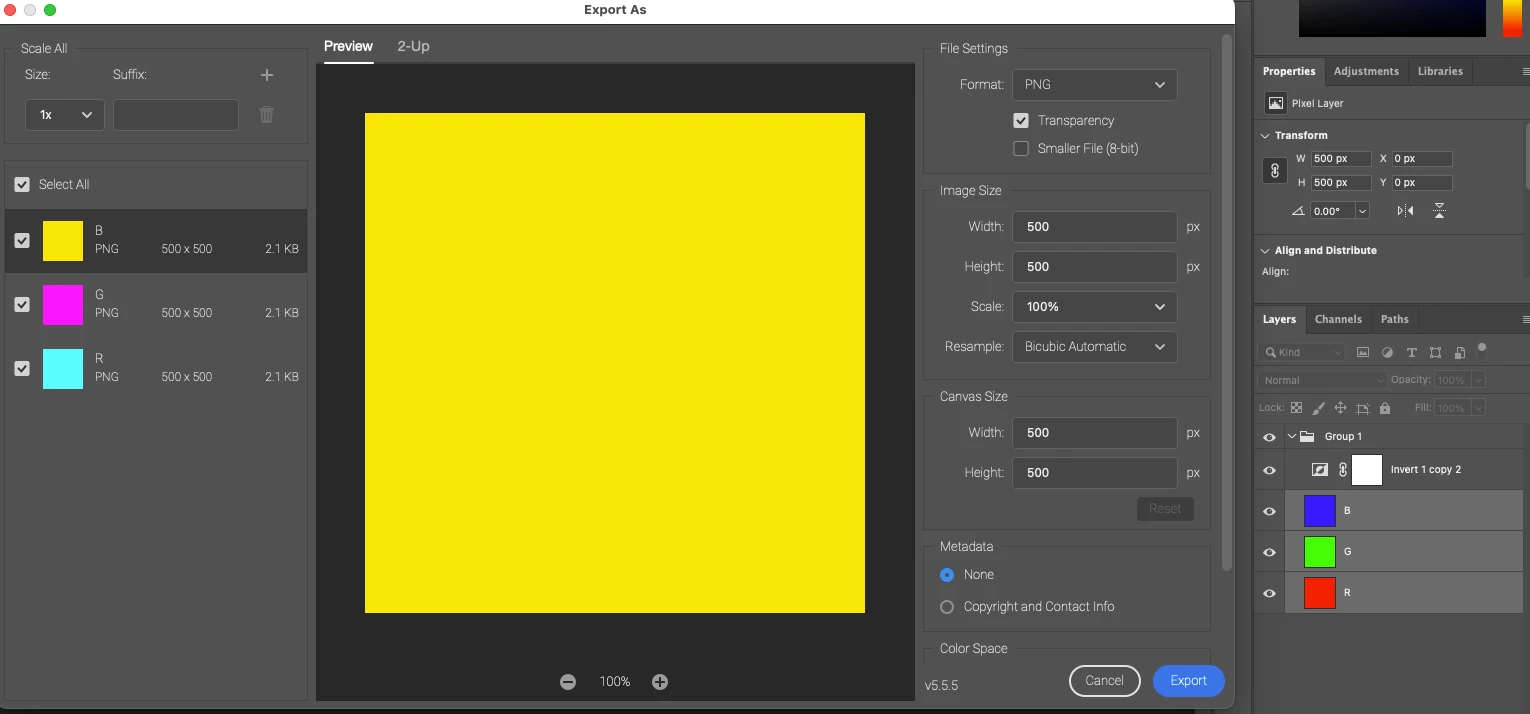

It should also be noted that right clicking on the layers panel and selecting export as will apply the adjustment layer to all layers without needing to "bake it in":

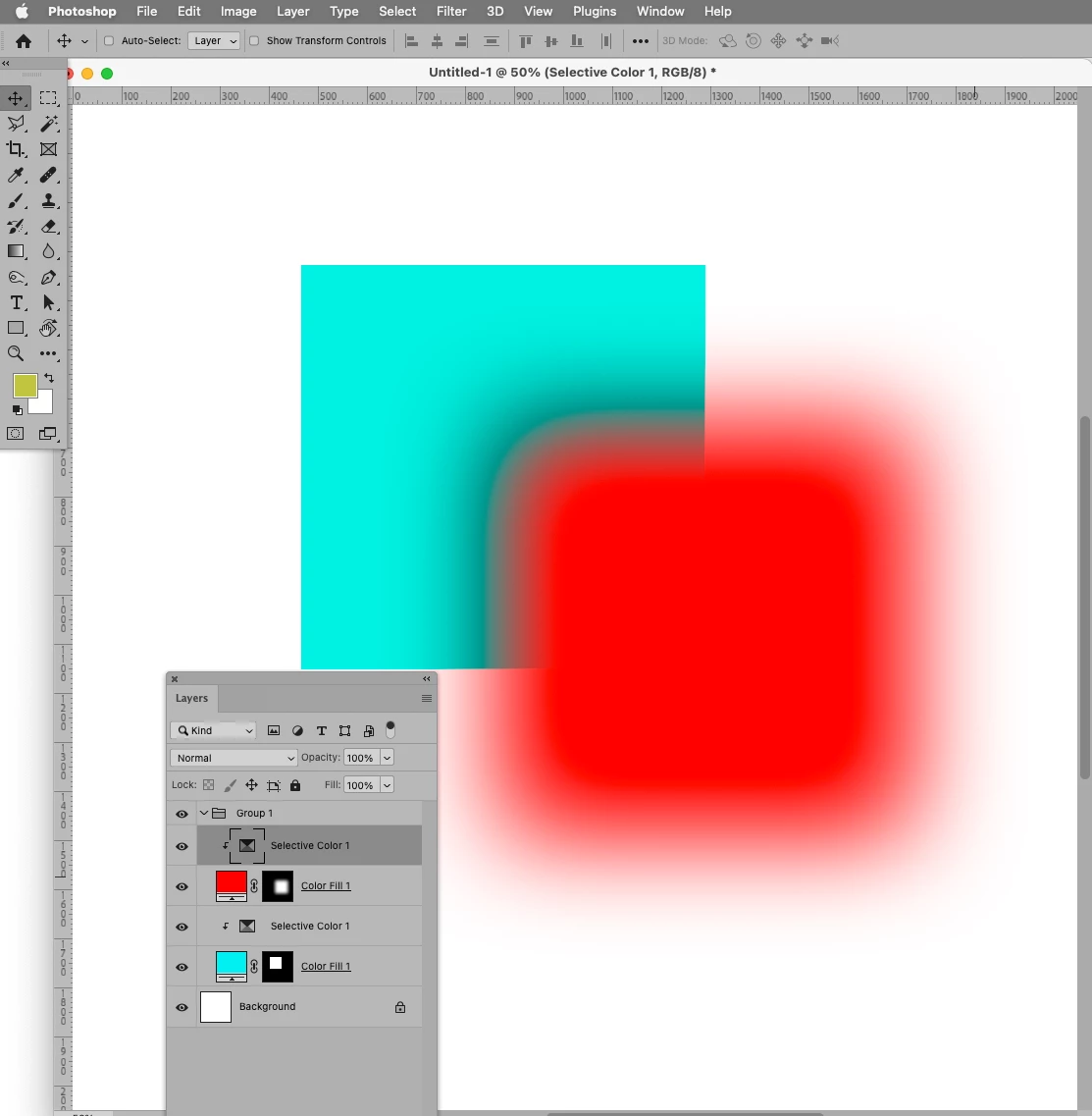

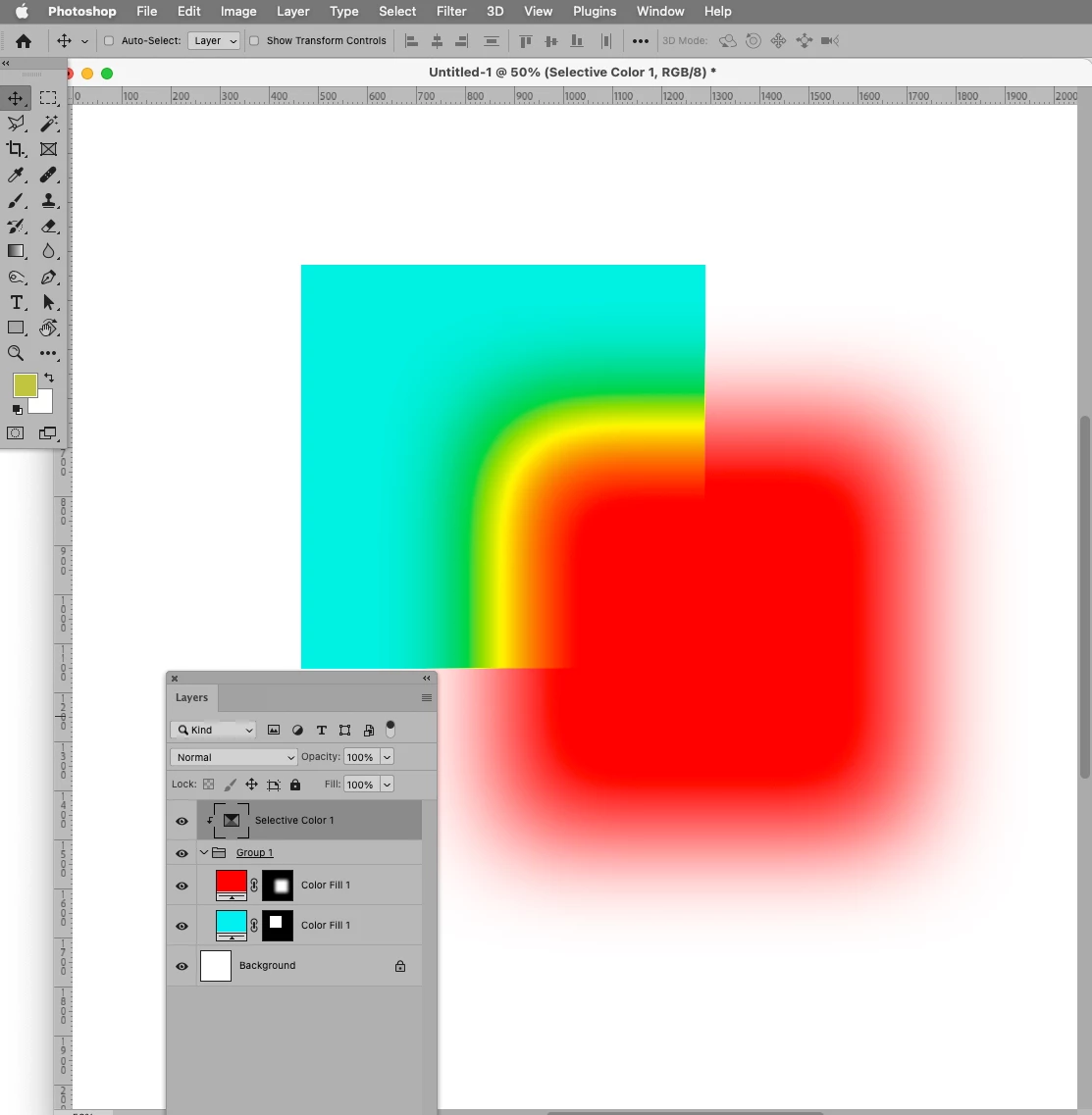

The whole idea seems problematic anyway as applying an Adjustment to several Layers together and applying it to the Layers individually does not necessarily yield the same result.

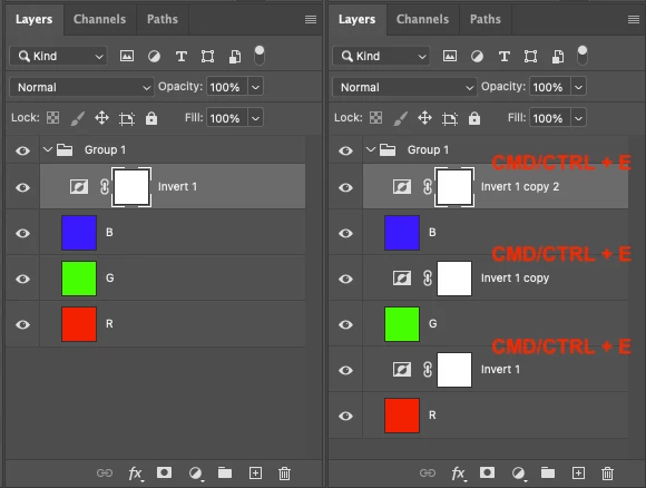

@kornelijek – If I'm understanding you correctly, another option would be to duplicate the adjustment layer N times, with N being the number of layers in the group that need the adjustment applied. Then merge each adjustment into each individual layer, one at a time.
A script could automate this task, however, it would likely be very specific to the layer structure inside the group and wouldn't be very flexible.
