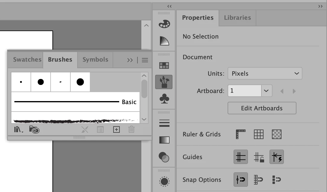

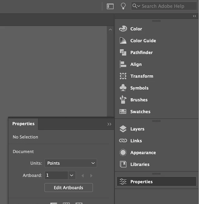

I have the same problem all of the sudden and it's accross all of my Adobe programs.  I assumed it was the 2021 update.  I first noticed in Photoshop, but it's the same in Illustrator and InDesign as well.  I can only have one panel from the right side open at a time.  VERY frustrating to have the layers dissappear every time I try to use the properties panel...
I do not see any way to reset the properties (per some of the suggestions) for InDesign and I tried the reset on Illustrator and it did nothing.  Also the "auto-collapse icon panels" is not and was never selected for any of the programs.
I was thinking it may be because the panels on the right became "pop out" ones (forgive my ignorance of the terminology).   I was able to resolve the issue of only one panel at a time by expanding the panels (clicking the double arrow at the top right, see photo), though they still only open one at a time when collapsed...

What you are seeing is the normal behavior for panels. The icon you circled in "expand.png" will collapse or expand the panel dock. When the panels are collapsed, you will see one panel at a time as in "before.png". When they are expanded, they will be stacked as in "after.png".
Your second screen shot, btw, is called "expand" and that is what Adobe uses instead of "pop-out", although as a user you are not bound to that. 😊

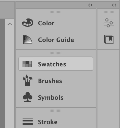

"I thought even in the collapsed form I could have both the preferences Properties and layers (for example) visible simultaneously. "
Hi Nora,
You can if they are in separate Docks.
(preferences is not a panel — I think you meant properties)
You are asking about PS, AI, and ID in the Photoshop forum. I've left it here, but your images are in Illustrator, so I'll use that. Notice that in your screen shot the Properties panel is in the same dock with the other panels.
Here (in AI) I have just reset the Essentials workspace. Notice there are two docks. The one on the far right has one panel group consisting of two panels that extend top to bottom. The one on the left has multiple panels. When you click these, only one will appear at a time. This is what you remember.
In addition, you can click the double arrows to expand/collapse each dock. You can also resize each dock wider or narrower.
Play with this a bit. Choose the Essentials workspace > Play > Reset the workspace > Repeat.
