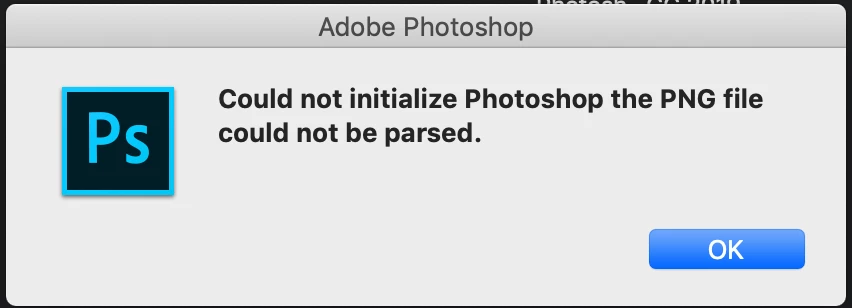

I'm having the opposite problem.  I'm trying to save a file to a png file but get the error: Could not save a copy as "\..file name.png" because the file-format cannot parse the file.  Have you seen this problem.  This is my first time on the community help, so don't know the protocol on how to send this, except as input to your comment.

Joe Sears
February 25, 2017
I resolved the problem. I had many layers that I saved as a .tif file successfully but when I tried to save it as a .png file, I received that error message that it couldn't be parsed.  I checked the size of the picture and the resolution was 1200 pixels.  I changed it to 300 pixels and that allowed me to save it as a .png.

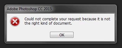

February 14, 2016
In the spirit of experimentation, I took an existing JPG, deleted the extension, attempted to open it in PS and got:
I replaced the extension and it opened right up.
FWIW, right-clicking on the file does not produce the "Open with > Adobe Photoshop CC 2015" option, either. This is on Win7 SP1.
So I don't know how you're doing it. There's something else going on.

February 22, 2016
I do not have anything on hand that PS can't parse. I hate to say it (well, no, that's not true, I don't hate to say it), but in 15 years of Photoshopping I've never had a file it couldn't parse.
So-o-o, what I did do was I duped an image, dragged it into a hex editor and randomly mucked with the code, tried to open it in PS and got the "cannot parse" message, deleted the extension, tried to open it in PS again and got the "not the right kind of document" message as above.
Of course, at this point nothing wants to open it because the code is deformed.
None of which addresses my other observation, that "right-clicking on the file does not produce the 'Open with > Adobe Photoshop CC 2015' option". If the file has an extension, it does. If it doesn't, it doesn't.
There it stands at my end. Someone else will have to jump in because I can't reproduce your experience.
