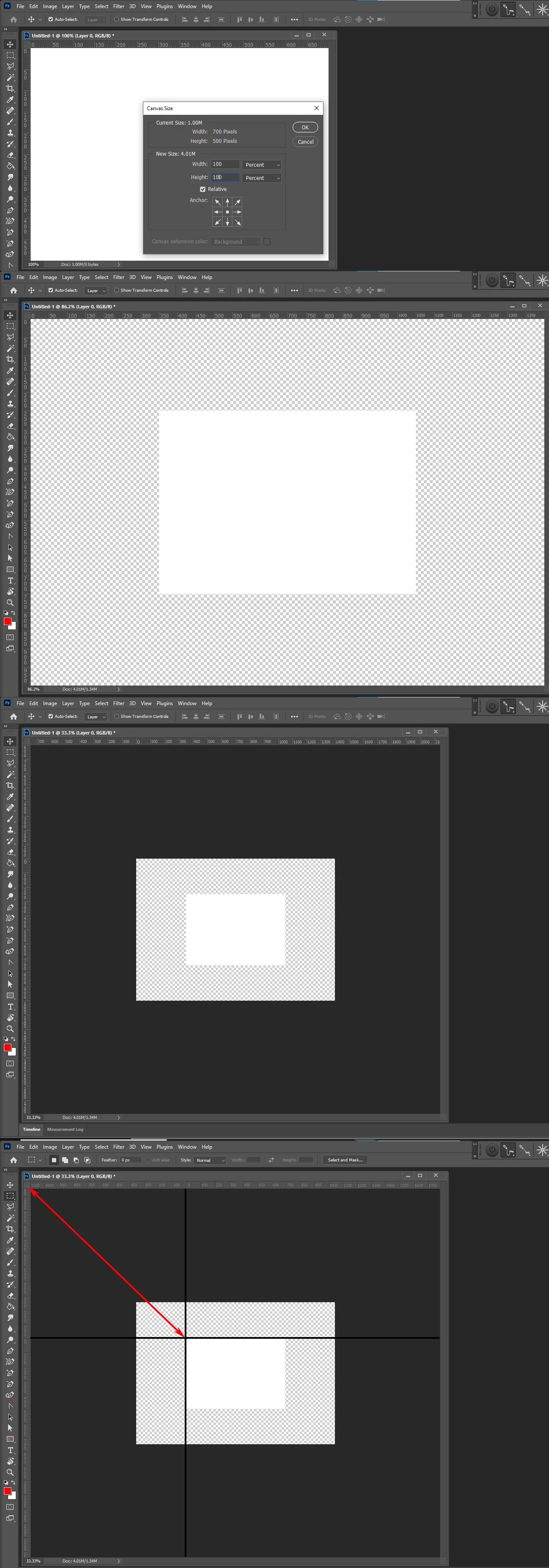

"I would like to keep an image in place with reference to the ruler's 0,0 point. The problem I am having is that when I increase the canvase size on the left, the image moves right accordingly thereby also shifting the point in the image I would want to stay on 0,0."
That is not possible in our universe.  In our universe the image will only stay put if you add canvas to the right and bottom you neeed to anchor the image to the top left. Here is a 4x expansion.  Easy to do in an Action.

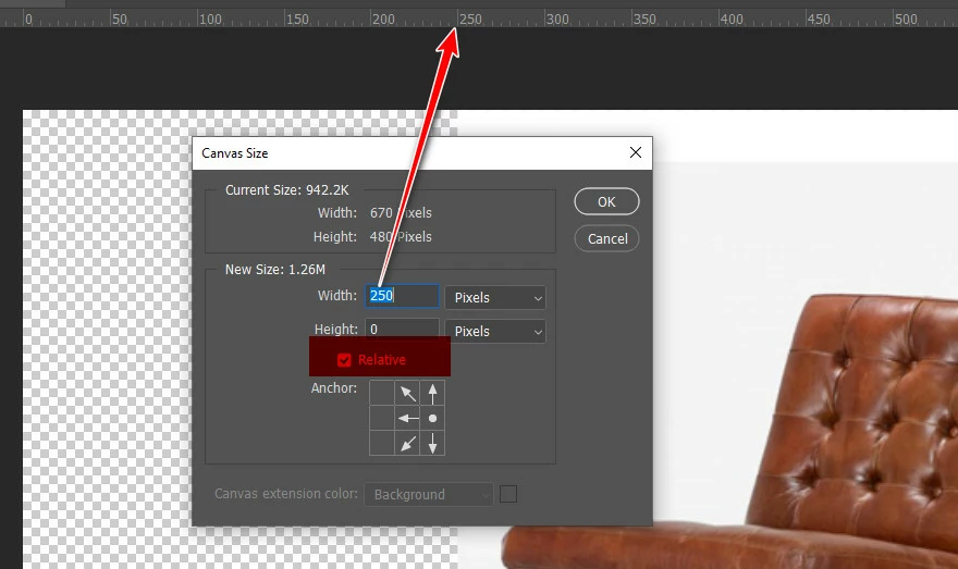

Just wanted to say thank you for leading me on the right track. I managed to get the action working by creating pseudo reference points.
After resizing the image without enlarging to a height of 480px I then, use the relative option of the canvas size where I make it so that the image starts at X value as defined by the width in the canvas size dialogue. In my case 250px was good enough though I will tweak if QA needs more centering. Doing this allowed me to then select the area I wanted to do content aware scaling on. With the 250 X value, I select the area around pixels 251 --> 256 for example. This will always be a known value irrespective of the image in use (similar to the known value of 0,0 but in this case its 250,0).
Then for adjusting the opposite side, I just flipped the canvas horizontally and once again set the X value in the canvas size dialogue and again do the content awareness. Several flips and adjustments later and we have a final image of 1920px X 480px.

(0,0) origin is normally the canvas top left. However ,you can drag it to be anywhere so you can use the rulers relative to that point.
