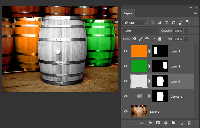

    Put each color on a separate layer and set the color layers to Color blend mode. For the white area you may need to add a curves or levels adjustment layer.

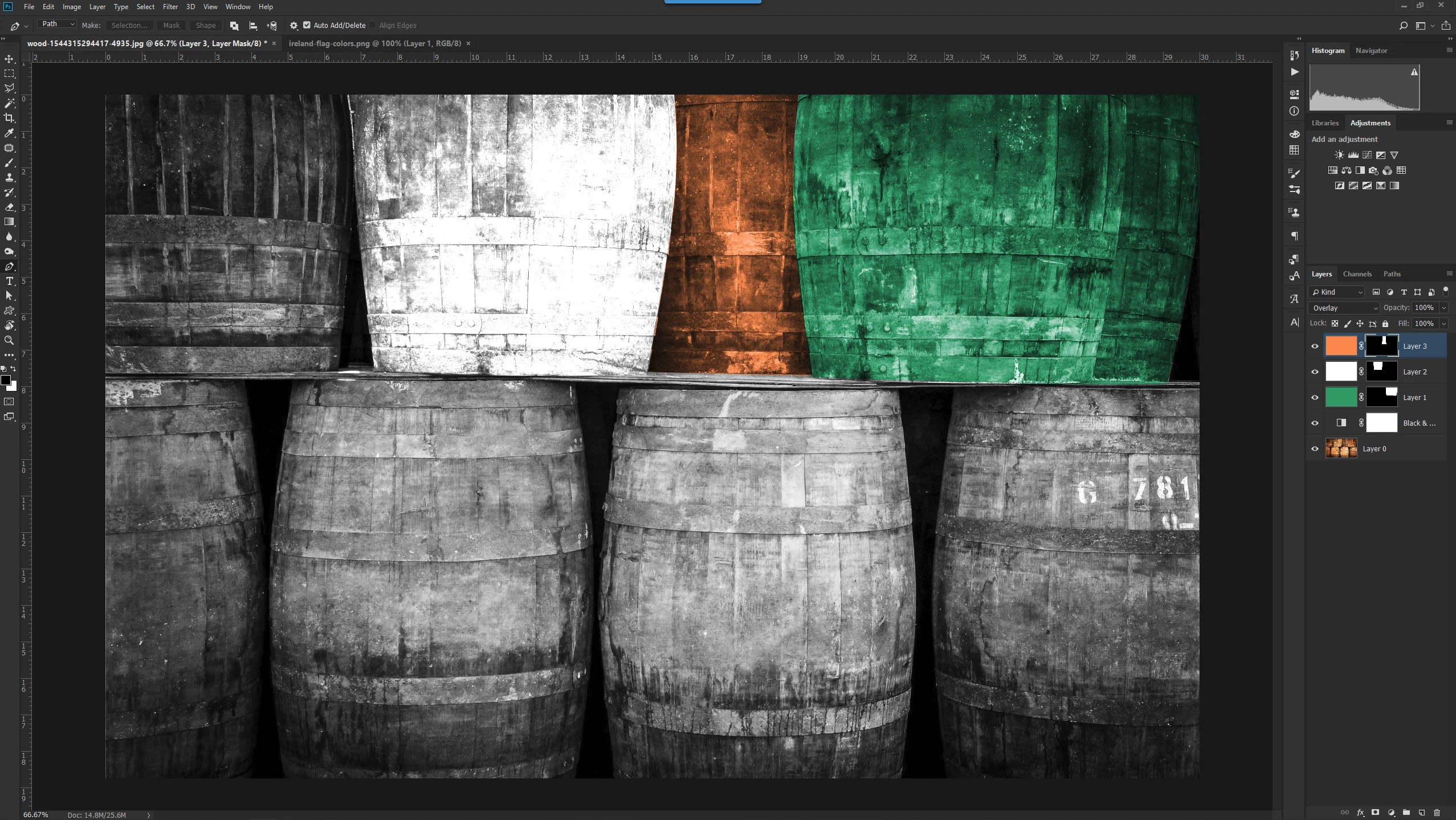

    I'm going to take a stab in the dark at what you're up to.
    I would make the barrel staves B&W. Make selections of the staves. And apply masks to them.Using different layers with the flag colors.
    Then, use a blending mode like overlay to apply the color. You can adjust the fill or opacity level to taste.If the color is overwhelming.
    Blending modes preserve shadows and details.
