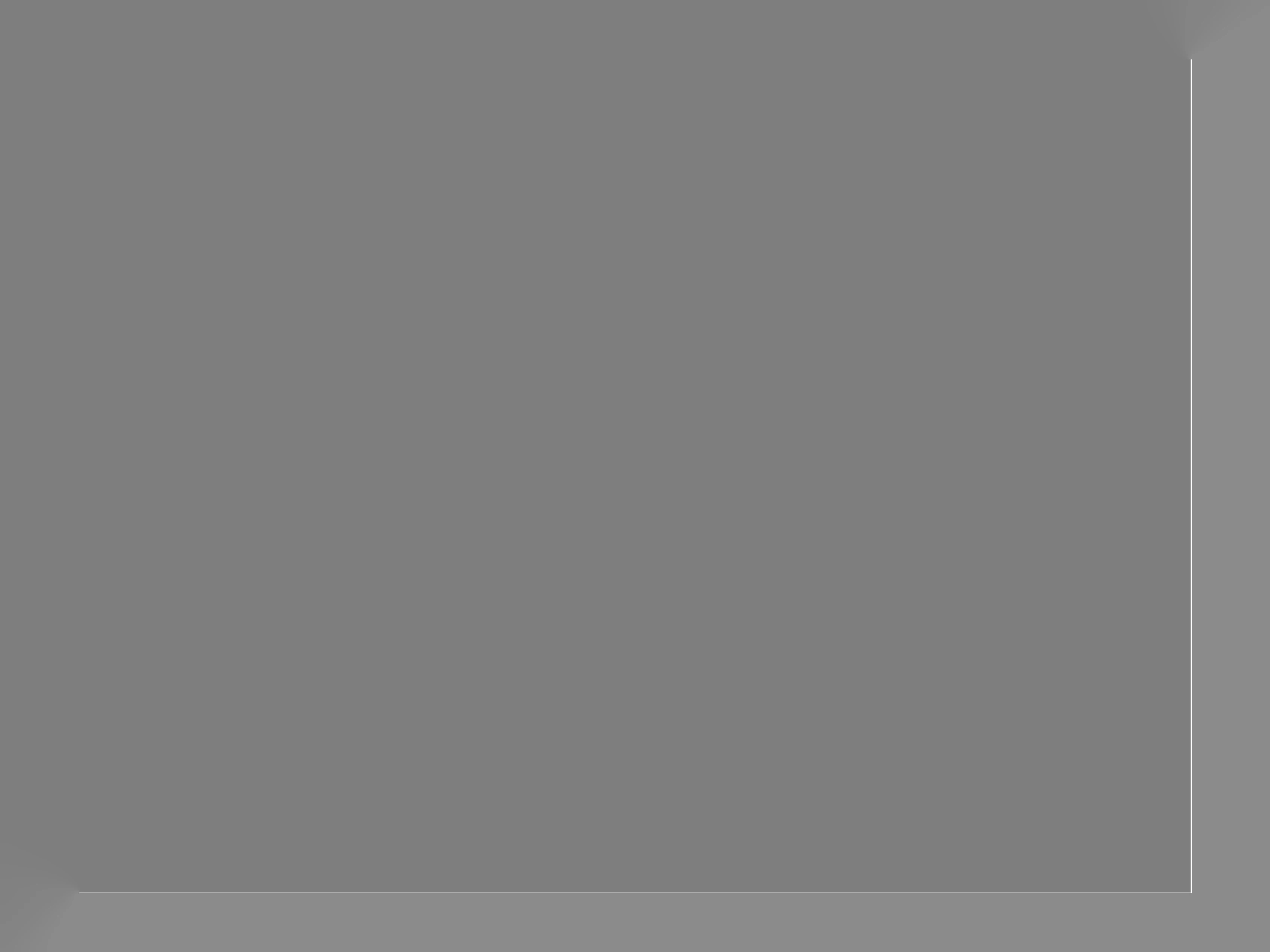

Expanding the image while using the Crop Tool (the color in this case, about a solid gray) using Content Aware Fill - makes wrong color, in my case after expanding a lighter frame at the previous image edge borders and a lighter gray color is used for the expanded areas. Is this a known bug? I’ve downgraded to 27.8, no issues there.
Thank you,
Patrik

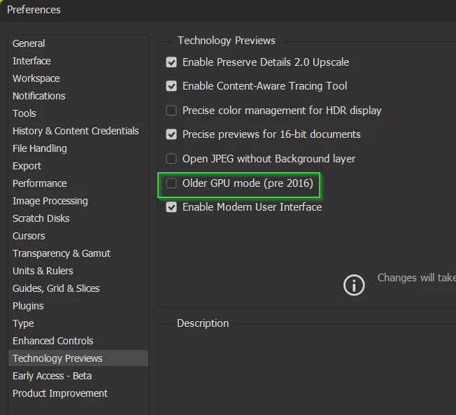

This sort of issue is often GPU related, so have you tried this setting?
Note: I have no idea what hardware you are using.

Well, do you got available a Mac Studio M1 to try, as I do. It does not work on my machine. Frustrating indeed. Could you please report to developers. Ive been reporting earlier and work full time as a retoucher and this a very major issue at my side. (25+ years user of PS, so I’m aware of having the latest updates of the software, Mac OS and so on, not sure it will help at this moment to upload all info etc.) I attach a video + a still image of an expanded background below, please forward to developers. Thank you.

Content Aware Fill since version 27.9 in does not work in 16bit mode.
I hope for a quick bug fix as I’m working always in 16bit.
Try replicate by make a solid color image in 16 bit, expand the image (on all sides) by using CAF and the issue appears.
Thank you!
