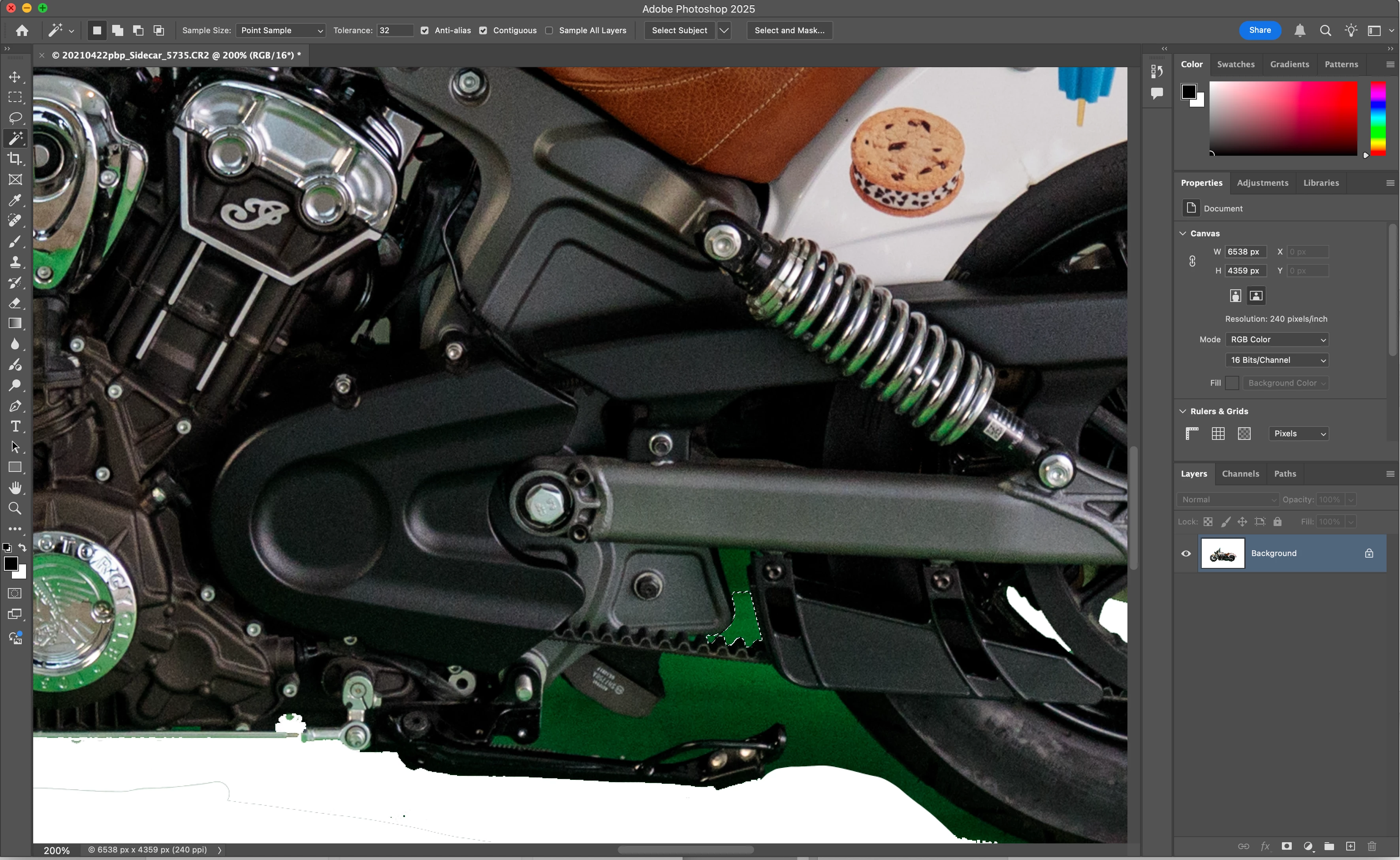

Full window:
Selection made:

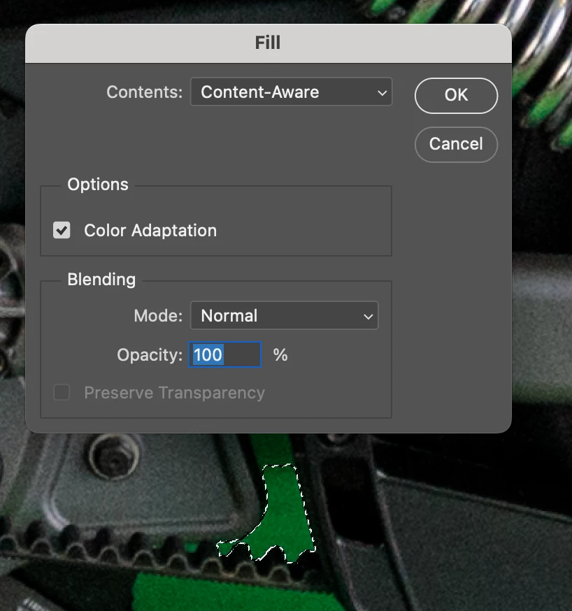

This comes up when I hit delete, as in I take my finger and press the delete key.

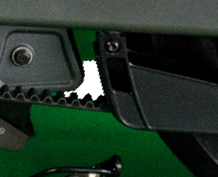

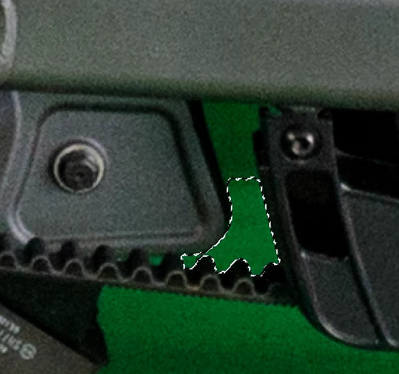

After I dismiss that dialogue, because I don't want to Fill anything, I just want to delete it, I press command-delete and this is the result: (What I would expect when pressing just the delete key.)
