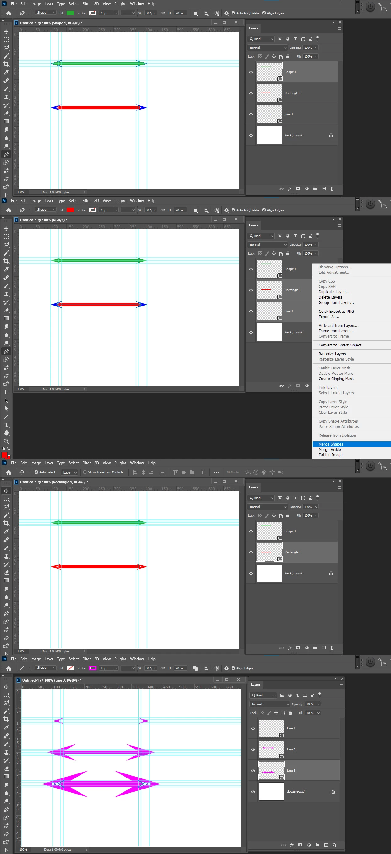

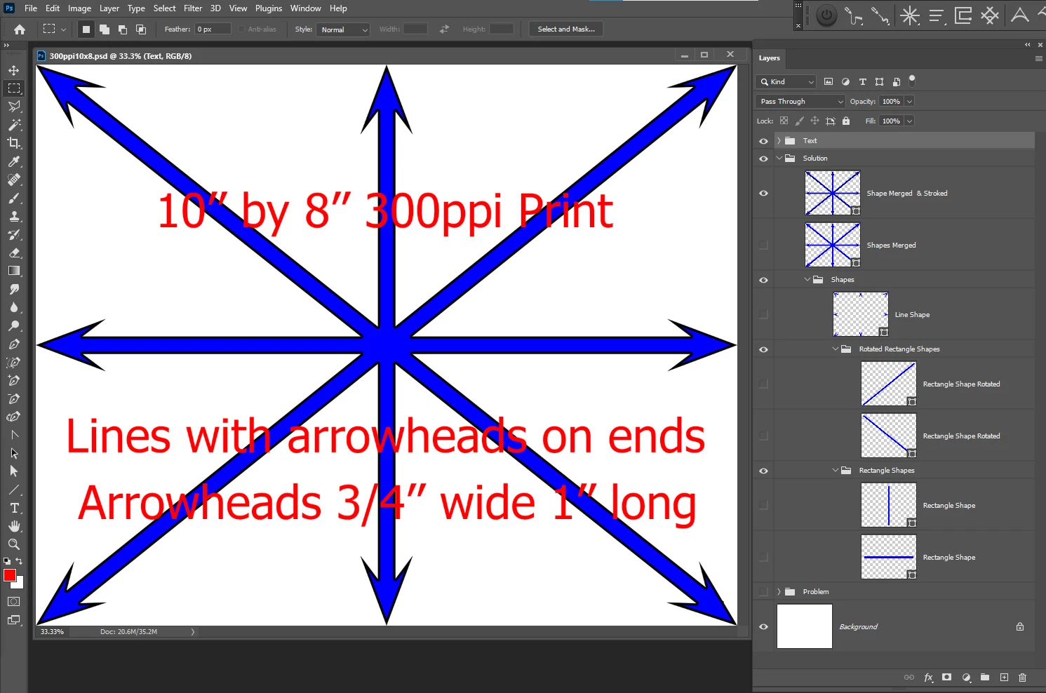

Is it a problem? Adobe had it right but made the change for some unpublished reason.  They removed line weight also. Use the rectangle shape tool to create line shape layer rotate then and use the Line shape tool to add Arrowheads then merge the shape layers into your pixel layer you can still add lines ins Photoshop.

Adobe broke the line shape tool when they removed line weight. The Line Shape tool can only create arrowhead Shape layers. You have to use the rectangle shape tool to create line weight shape layers. Use both tool and merge the two shape layers to create shape layer with arrowheads you want. For if you Stroke the Arrow Shape Layers the arrow line stroke will be a 0x wide stroke line,  or a 1x wide stroke line or a 2x wide stroke line.  None of these will be the arrow shape layer you want. For only 0x wide line arrow layer arrowheads point to the correct location you do not get an arrow shaft you have been shafted.
