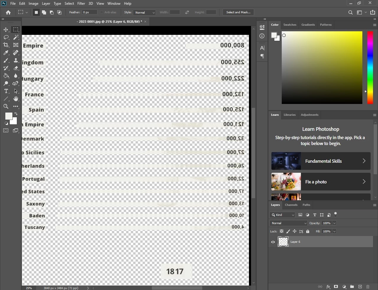

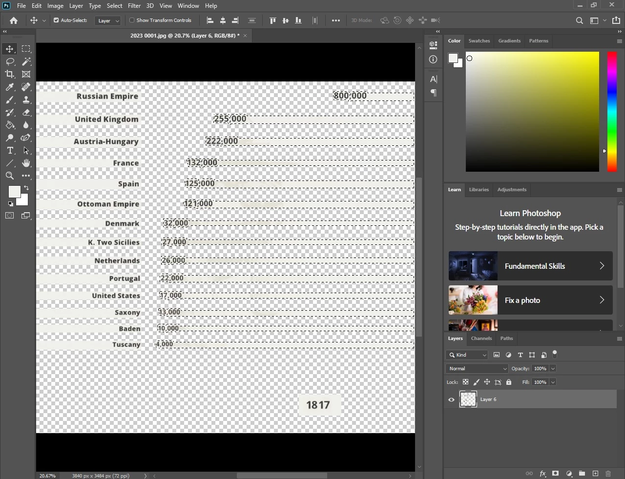

Here is the original post with the original pictures inserted.
quote
Sometimes i have selection like following that i must flip from top to down one by one:
now i want to flip only selected areas without separate layers like following:
please note that i don't want to separate selected area to multiple layers. If this is not possible without separate selection, please provide code with separate selection to multiple layers.
Preference is given to without separate selection.
I have following script to flip all layers:

But the above code has the following two problems:
  1. it flip all layers (i want to flip only selected areas).
  2. If the selected areas are not divided into dedicated layers, the above script will only flip the main layer.
If it possible help to solve following two problems.
PNG sample for test attached to post.

pixxxelschubser
July 1, 2023
quote
… Sometimes i have selection like following that i must flip from top to down one by one …
… But the above code has the following two problems:
  2. If the selected areas are not divided into dedicated layers, the above script will only flip the main layer …
By @abolfazl29032603daba
Sorry.
Unfortunately, you are subject to a fundamental error.
It is not the script that has the two problems. You are trying to use a script that was not written for the purpose you intended.
You are trying to mirror multiple non-transparent parts of a single layer that have been bounded by a selection. But that's not the problem either. In addition, you still want to align the individual non-transparent parts within the same selection (each separately) to the right.
This can only work if you distribute the individual parts on separate layers and then go through the layers in a loop and mirror them and align them to the right.
No longer applicable, as the original post has been completely revised several times and the question is now a completely different one.
[ edited by pixxxelschubser ]
