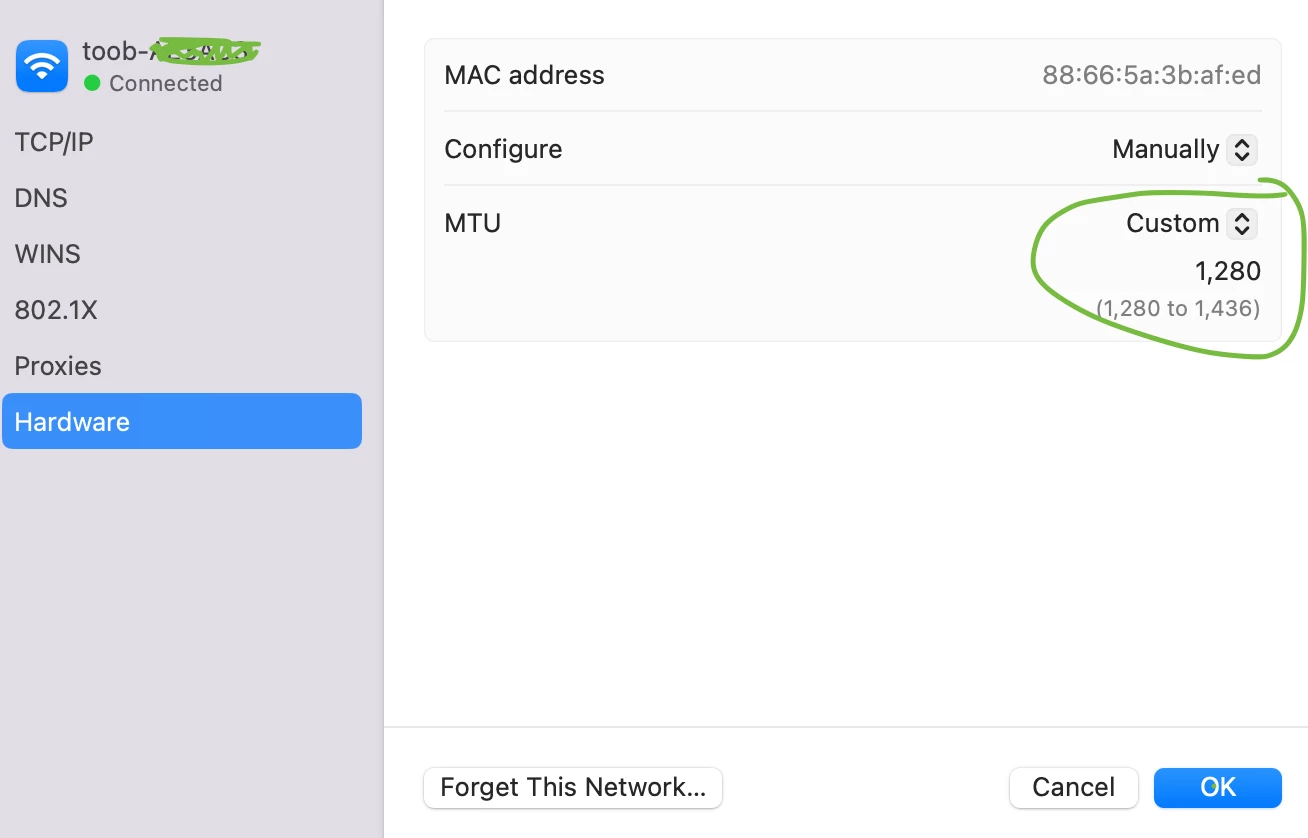

Mac Sequoia changed this - so I had to change back to 1280 and upload restriction was gone and generative fill worked again
