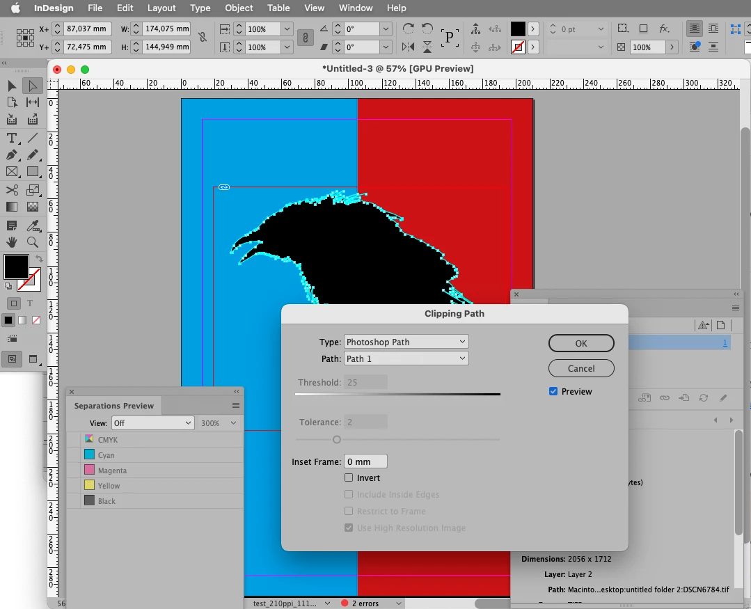

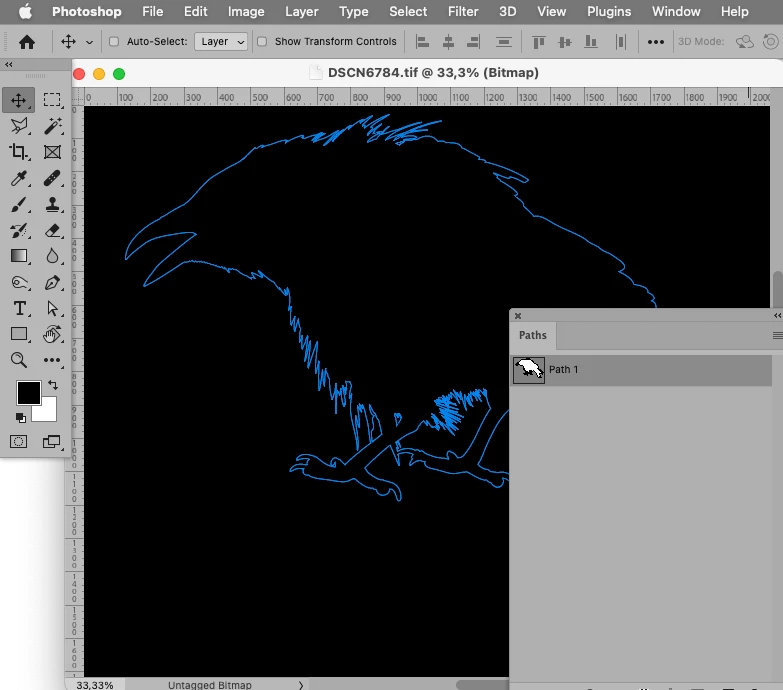

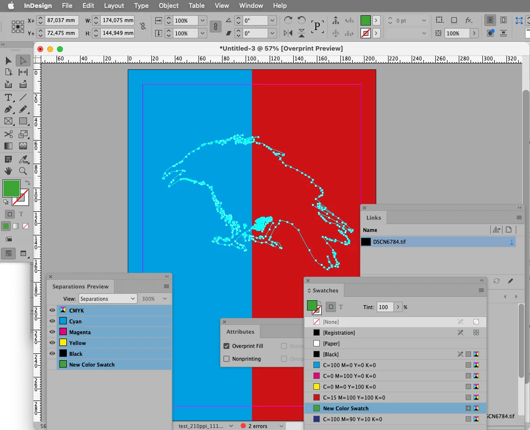

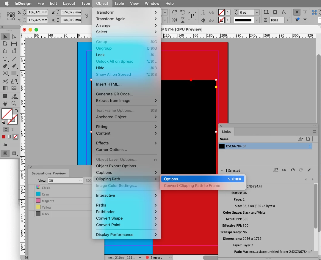

Alternatively you could use a completely black Grayscale- or Bitmap-tif with a Path, use the Path in Indesign (Object > Clipping Path > Options > Type > Photoshop Path) and apply the Spot Color to the image.

Bitmap-tif with a Path:
Placed in Indesign:
