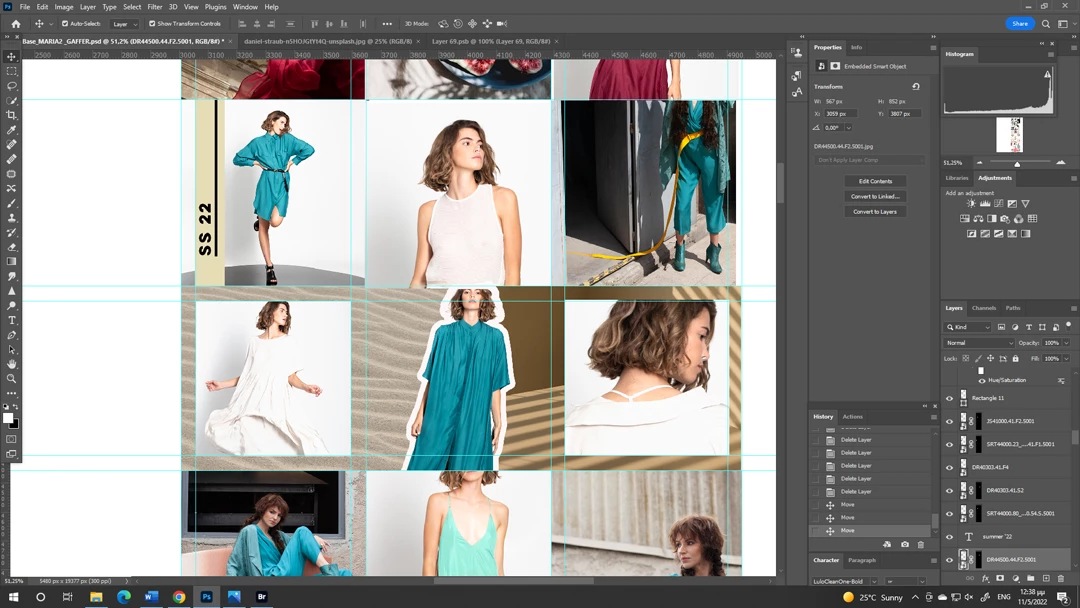

How to center 2 layer masks at selection in photoshop
When i try to center two images that are smart objects with layer masks with the align buttons in photoshop it alignes it according to the whole image and not only my selection. How can i center only my selection to an other mask and not the whole images?

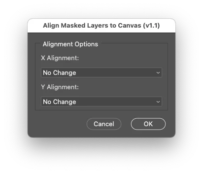

This 1.2 version should work correctly to align masked layer groups to the canvas.
Align Masked Layers to Canvas Using Mask Bounds ScriptUI v1-2.jsx
Stephen Marsh
v1.0 - 24th May 2022:  Initial release using a Radio Button UI
v1.1 - 7th April 2025: Revised to use Dropdown Menus
v1.2 - 7th April 2025: Revised to process layer groups (requires Photoshop 21.0)
https://community.adobe.com/t5/photoshop-ecosystem-discussions/how-to-center-2-layer-masks-at-selection-in-photoshop/td-p/12934857
Features: * Unlike the standard align feature, this script works correctly with layer masked content
          * Works with selected standard, smart object or layer groups containing layer masks
          * Single history step undo

                var dlg = new Window("dialog", "Align Masked Layers to Canvas (v1.2)");
                dlg.orientation = "column";
                dlg.alignChildren = "left";
                dlg.preferredSize.width = 300;
                // Add the panel for the dropdowns
                var dropdownGroup = dlg.add("panel", undefined, "Alignment Options");
                dropdownGroup.orientation = "column";
                dropdownGroup.alignChildren = "fill";
                dropdownGroup.margins = [10, 15, 10, 10];
                dropdownGroup.alignment = "fill";
                dropdownGroup.add("statictext", undefined, "X Alignment:");
                var xDropdown = dropdownGroup.add("dropdownlist", undefined, ["No Change", "Left", "Center", "Right"]);
                xDropdown.selection = 0;
                dropdownGroup.add("statictext", undefined, "Y Alignment:");
                var yDropdown = dropdownGroup.add("dropdownlist", undefined, ["No Change", "Top", "Center", "Bottom"]);
                yDropdown.selection = 0;
                var btnGroup = dlg.add("group");
                btnGroup.orientation = "row";
                btnGroup.alignment = "right";
                var cancel = btnGroup.add("button", undefined, "Cancel");
                var ok = btnGroup.add("button", undefined, "OK", { name: "ok" });
                ok.preferredSize.width = 80;
                cancel.preferredSize.width = 80;
                // Button event handlers
                var result = null;
                ok.onClick = function () {
                    result = xDropdown.selection.text + "," + yDropdown.selection.text;
                    dlg.close();
                cancel.onClick = function () {
                    result = null;
                    dlg.close();
                dlg.show();

        function alignByMask(userInput) {
            var parts = userInput.split(",");
            var xAlign = parts[0];
            var yAlign = parts[1];
            var canvasLeft = 0;
            var canvasTop = 0;
            var canvasRight = activeDocument.width.value;
            var canvasBottom = activeDocument.height.value;
            var canvasXCenter = activeDocument.width.value / 2;
            var canvasYCenter = activeDocument.height.value / 2;
            var bounds = activeDocument.activeLayer.bounds;
            var layerLeft = bounds[0].value;
            var layerTop = bounds[1].value;
            var layerRight = bounds[2].value;
            var layerBottom = bounds[3].value;
            var layerWidth = layerRight - layerLeft;
            var layerHeight = layerBottom - layerTop;
            var dx = 0;
            var dy = 0;
            switch (xAlign) {
                case "Left": dx = canvasLeft - layerLeft; break;
                case "Center": dx = canvasXCenter - layerLeft - layerWidth / 2; break;
                case "Right": dx = canvasRight - layerRight; break;
            switch (yAlign) {
                case "Top": dy = canvasTop - layerTop; break;
                case "Center": dy = canvasYCenter - layerTop - layerHeight / 2; break;
                case "Bottom": dy = canvasBottom - layerBottom; break;
            activeDocument.activeLayer.translate(dx, dy);
activeDocument.suspendHistory("Align Masked Layers to Canvas (v1.1)", "main()");
studio KLOROFORM
Nov 8, 2023 11:07 AM UTC
Yes, it works. Cool
Thanks, man

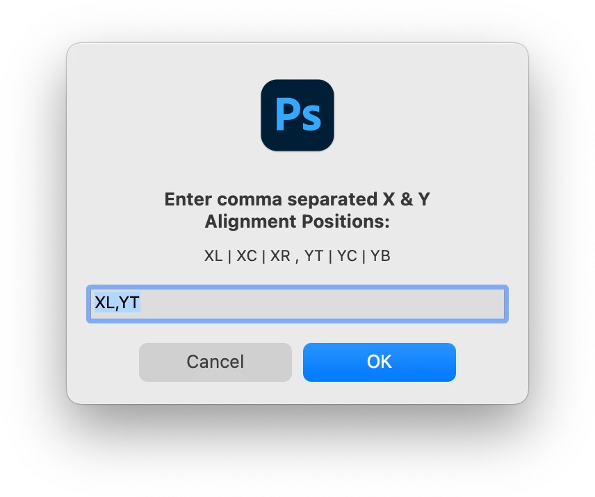

May 15, 2022 9:13 AM UTC
I couldn't find an existing script to align using the mask vs. unmasked content, so here is a basic script to do so...
Select all layers to align to the canvas and then run the script.
It uses a CLI or "command-line interface". One must enter a two-character code for the X-axis, followed by a comma, followed by a two-character code for the Y-axis. Code entry is case insensitive and word space insensitive.
Example: To centre align to the canvas, one would enter:
XC,YC
X/Horizontal codes:
    XL = Left
    XC = Centre
    XR = Right
    NO = No change
Y/Vertical codes:
    YT = Top
    YC = Centre
    YB = Bottom
    NO = No change
    YU = Upper (optional, equates to Top)
    YL = Lower (optional, equates to Bottom)
I plan to add a more user-friendly, graphical ScriptUI interface, however that will take more time than I have for now. Edit: Done!
Additionally, I will also need to put in more work to make this work with a selection rather than the canvas.... This is proving to be harder than expected! The workaround is to ensure that the crop tool has "Delete cropped pixels" unticked, crop the image, run the script, then use Image > Reveal All to undo the non-destructive crop.

        // Prompt for input
        var userInput = prompt("Enter comma separated X & Y canvas alignment positions:" + "\n" + "XL | XC | XR | NO, YT | YC | YB | NO", "NO,NO");
        if (userInput === null) {
            //alert('Script cancelled!');
        var userInput = userInput.toString().toUpperCase().replace(/[^A-Z,]/g, '');
        // Validate user input
        if (/X[LCR]|NO,Y[TCBUL]|NO/.test(userInput) === true) {
            processSelectedLayers();
        } else {
            alert('Invalid command entered!');

May 11, 2022 10:12 AM UTC
In the Layers panel, click the first layer that you want to center (or align), press and hold the Command (PC: Ctrl) key, and then click any other layer that you want. Want to put them in the middle or align them to select. Also, I often align things in the document by selecting the first background layer.

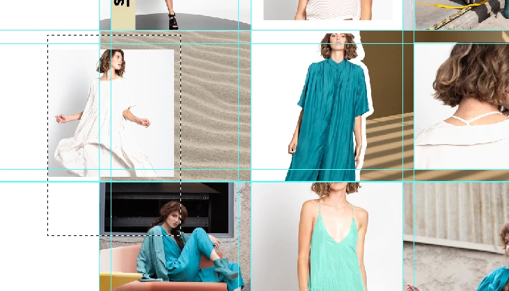

KssndrahAuthor
May 11, 2022 10:30 AM UTC
 the proble is it selects the whole image like this
mark@headTrix
May 11, 2022 5:36 PM UTC
So when selecting a layer, it does depend on where you click. While holding the command key down, if you click on the thumbnail preview then it will create a selection based on the contents of that layer. If you click on the blank part of the layer (not the thumbnail) then it will just select the layer, which might solve your issue.
So you are trying to center each photo within its individual square? So the pattern and image are two different layers. It also might help to Right-Click each layer, and convert each layer with a mask to a Smart Object, then it might be easier to align and you wont have to worry about the mask moving.
Try again first selecting the 2nd layer, but avoid clicking on the thumbnail and that might just solve your issue. Make sure there is no selections.
Cheers,
mark

KssndrahAuthor
May 11, 2022 9:44 AM UTC
Hello mark, thank you for your reply
I tried what you suggested and it still aligns the whole image and not just the masked area.
Maybe my explanation of the problem isn’t clear so here is print screen.
KssndrahAuthor
May 11, 2022 9:48 AM UTC
