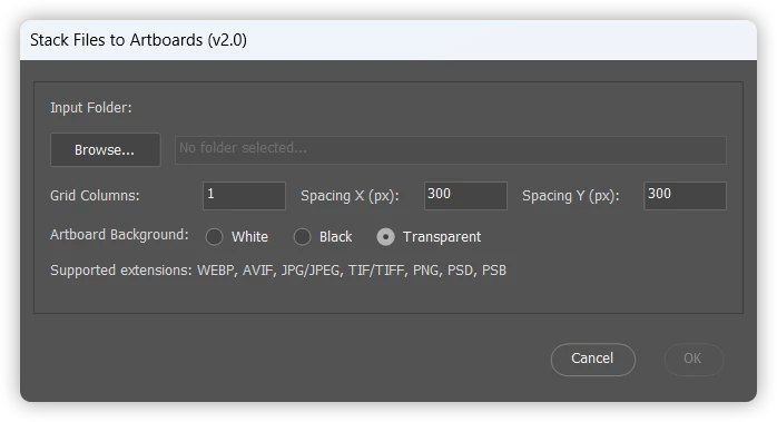

@Lucas347275917lt9
Assuming that you have a folder containing layered PSD files created from the data sets, you can try the following script to stack each PSD as an artboard, retaining the original layers from each separate PSD. This script is only intended for later CC versions and has been successfully tested in v2021, v2024 and v2025 on Mac and Win.
EDIT: Original code upated to v1.7 (20th August 2025)
Stack Layered Files to Artboards.jsx
Stephen Marsh
v1.0 - 8th May 2024: Initial release.
v1.1 - 9th May 2024: Added code to set the artboard background colour.
v1.2 - 13th August 2025: Reworked the selectAllLayers function. Reworked the smart object conversion code.
v1.3 - 14th August 2025: Added a step to unlock all selected floating layers before converting to a smart object. Various UX enhancements.
v1.4 - 15th August 2025: Artboard creation reworked to correctly handle content extending out of the artboard bounds. Smart objects are no longer used to dupe artboards.
v1.5 - 16th August 2025: Added checks to abort the script if artboards are detected in the input files.
v1.6 - 19th August 2025: Artboard arrangement modified: 0 = one single row, 1 = one single column, 2 = two columns etc. Digit validation check added to the column number prompt.
v1.7 - 20th August 2025: Code refactored, hopefully it's not broken! :]
https://community.adobe.com/t5/photoshop-ecosystem-discussions/how-to-export-to-artboards-using-the-photoshop-variables/td-p/14603249
Originally based on:
https://community.adobe.com/t5/photoshop-ecosystem/combining-mulitple-photoshop-files-into-1-photoshop-file-with-artboards/td-p/12218200

function createDialog() {
try {
var dialog = new Window("dialog", "Stack Files to Artboards (v2.0)");
dialog.orientation = "column";
dialog.alignChildren = "fill";
dialog.spacing = 10;
dialog.margins = [10, 15, 10, 10];
// Main UI panel
var mainPanel = dialog.add("panel", undefined, ""); // Blank panel/group heading
mainPanel.orientation = "column";
mainPanel.alignChildren = "fill";
mainPanel.spacing = 10;
mainPanel.margins = 10;
// Input folder UI selection
var folderLabel = mainPanel.add("statictext", undefined, "Input Folder:");
var folderGroup = mainPanel.add("group");
folderGroup.orientation = "row";
folderGroup.alignChildren = "center";
var browseBtn = folderGroup.add("button", undefined, "Browse...");
browseBtn.preferredSize.width = 80;
var folderPath = folderGroup.add("edittext", undefined, "No folder selected...");
folderPath.alignment = ["fill", "center"]; // maximise the field width
folderPath.enabled = false;
// Grid UI settings
var gridGroup = mainPanel.add("group");
gridGroup.orientation = "row";
gridGroup.alignChildren = "center";
var columnsHelpTip = "(0 = one single row, 1 = one single column, 2 = two columns etc.)";
var columnsLabel = gridGroup.add("statictext", undefined, "Grid Columns:");
columnsLabel.helpTip = columnsHelpTip;
columnsLabel.preferredSize.width = 100;
var columnsInput = gridGroup.add("editnumber", undefined, "1");
columnsInput.helpTip = columnsHelpTip;
columnsInput.preferredSize.width = 60;
columnsInput.justify = "center";
gridGroup.add("statictext", undefined, "Spacing X (px):");
var spacingXInput = gridGroup.add("editnumber", undefined, "300");
spacingXInput.preferredSize.width = 60;
spacingXInput.justify = "center";
gridGroup.add("statictext", undefined, "Spacing Y (px):");
var spacingYInput = gridGroup.add("editnumber", undefined, "300");
spacingYInput.preferredSize.width = 60;
spacingYInput.justify = "center";
// Background color UI options
var bgGroup = mainPanel.add("group");
bgGroup.orientation = "row";
bgGroup.alignChildren = "center";
var bgLabel = bgGroup.add("statictext", undefined, "Artboard Background:");
bgLabel.preferredSize.width = 100;
var bgRadio1 = bgGroup.add("radiobutton", undefined, "White");
var bgRadio2 = bgGroup.add("radiobutton", undefined, "Black");
var bgRadio3 = bgGroup.add("radiobutton", undefined, "Transparent");
bgRadio3.value = true; // Default to transparent
// File format UI info
var infoText = mainPanel.add("statictext", undefined, "Supported extensions: WEBP, AVIF, JPG/JPEG, TIF/TIFF, PNG, PSD, PSB", { multiline: true });
infoText.preferredSize.width = 400;
// Buttons
var buttonGroup = dialog.add("group");
buttonGroup.orientation = "row";
buttonGroup.alignment = "right";
buttonGroup.spacing = 10;
buttonGroup.margins = 10;
var cancelBtn = buttonGroup.add("button", undefined, "Cancel", { name: "cancel" });
var okBtn = buttonGroup.add("button", undefined, "OK", { name: "ok" });
okBtn.enabled = false;
// Store references for global access
dialog.folderPath = folderPath;
dialog.columnsInput = columnsInput;
dialog.spacingXInput = spacingXInput;
dialog.spacingYInput = spacingYInput;
dialog.bgRadio1 = bgRadio1;
dialog.bgRadio2 = bgRadio2;
dialog.bgRadio3 = bgRadio3;
dialog.okBtn = okBtn;
dialog.selectedFolder = null;
dialog.inputFiles = [];

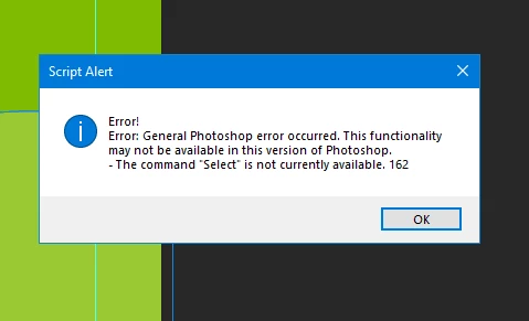

Todd_Morgan
Aug 12, 2025 12:18 PM UTC
Using latest version of PSD 26.9.0
Stephen Marsh
Aug 13, 2025 10:54 AM UTC
@Todd_Morgan
Please try the revised 1.2 version updated above.
