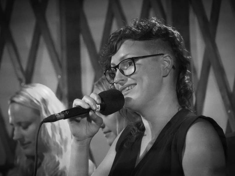

How to remove horizontal banding caused by LED lighting
Hi, does anybody knows how to remove horizontal banding caused by LED lighting when we shooted using silent mode with mirrorless cameras ?
does you know a method using Photoshop to do this? Or a photoshop or lightroom plug-in that works for this problem?
this is an example of the problem:
Picture was taken with a Sony A6300 digital camera.

    I was not aware of this affect.  Do you know what causes it?  Is some sort of artefact that happens with Mirrorless cameras and LED lighting panels?
    It's not going to be an easy fix.  I tried using curves, but it was tricking getting the layer mask to align with the darker areas.
    The best I could come up with was slow and careful use of the Dodge and Burn tools.  Set the strength really low (10%) and use a fully soft brush set to Midtones, and about the size of the dark bands.  Then slow brush out the shadows.
    I have pasted this in the same size you uploaded it

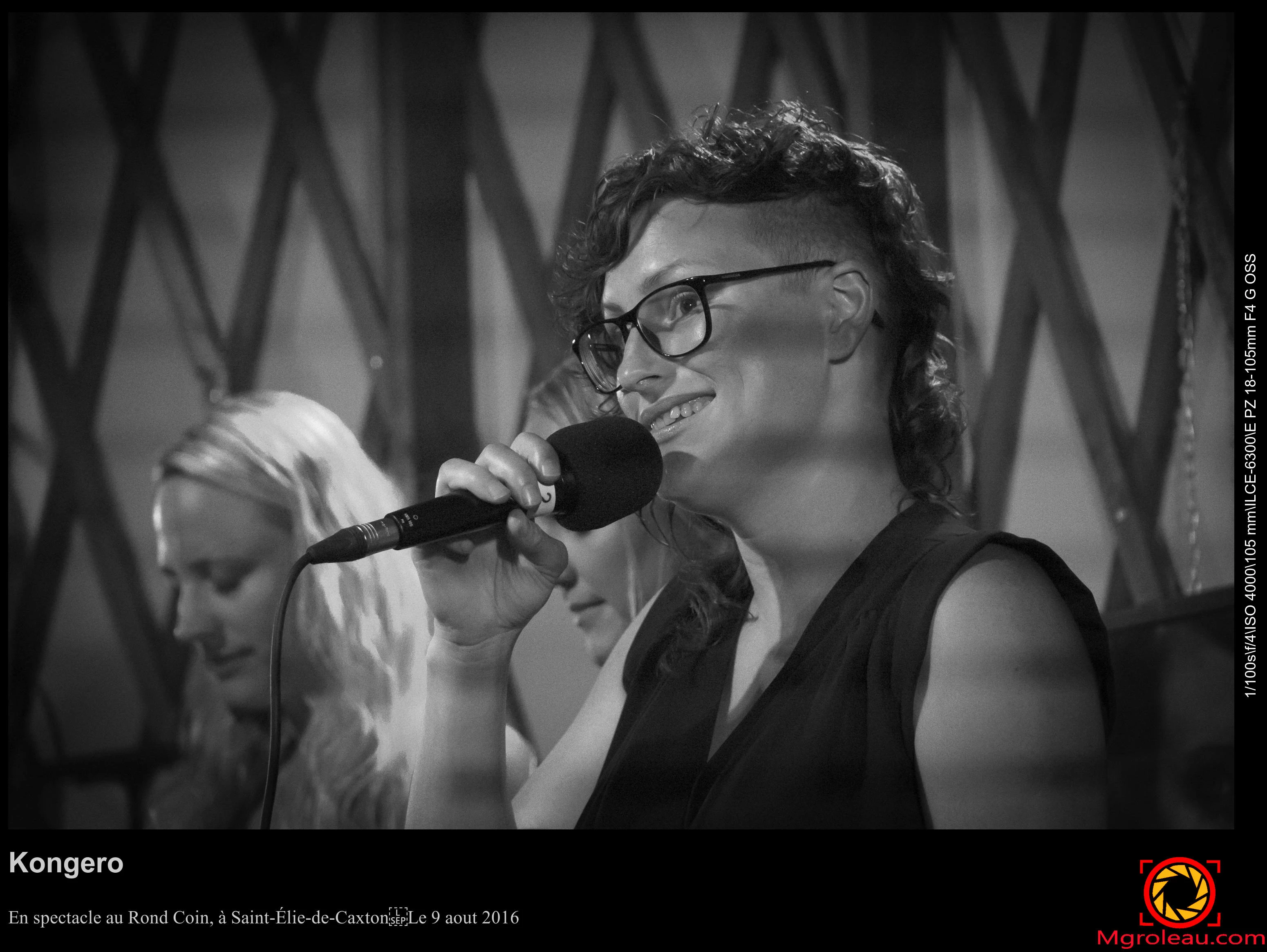

    Hey! Yeah, that horizontal banding from LED lights is a pretty common problem, especially when shooting in silent or electronic shutter mode with mirrorless cameras like your Sony A6300. It happens because the LED lights flicker faster than the camera sensor reads the image, which causes those annoying bands.
    One way to fix it in Photoshop is to use the Dust & Scratches filter along with some noise reduction:
    1. First, duplicate your photo layer so you keep the original safe.
    2. Then go to Filter > Noise > Dust & Scratches. Try setting the radius around 3 to 5 and the threshold around 10 to 20. This helps smooth out the bands.
    3. Next, go to Filter > Noise > Reduce Noise to clean up what’s left.
    4. If the photo looks a bit soft after this, you can add a layer mask and paint over the parts you want to keep sharp or just lower the effect’s opacity.
    This usually helps a lot without messing up the details. Another option is to carefully use the Dodge and Burn tools at a low strength to lighten or darken the bands manually it takes a bit more time, but gives you more control.
    Check out the result below!

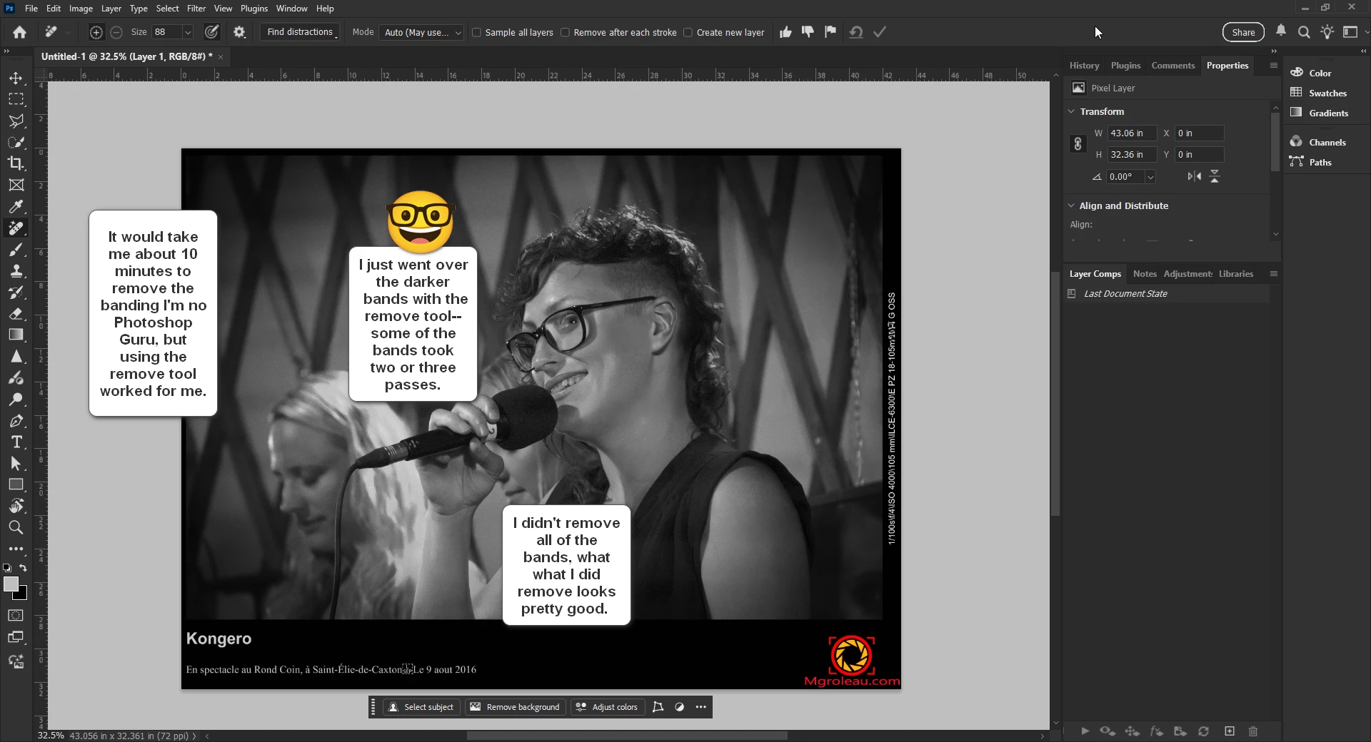

    Glenn 8675309
    Aug 4, 2025 10:56 PM UTC
    That looks pretty good.  I'm lazy:  I just used the remove tool and it did a pretty good job on what I did do.
