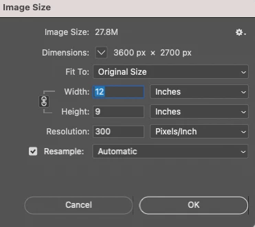

If you have an image that you want to save, share, or print at a different size, setting the Width and Height in the Image Size is a simple way to do it.
  • From the main menu, choose Image > Image Size.
  • Choose your preferred unit of measurement to the right of Height and Width, such as Inches.
  • Ensure the link between Height and Width is checked to constrain the proportions. You will see a chain link icon connecting Width and Height. This keeps you from making a tall skinny, or short wide image when resizing.
  • To change Width and Height without changing the total number of pixels in the image and have Resolution automatically recalculated, deselect Resample Image.
  • Enter the value for either Width or Height and the other will automatically change.
  • If you only want to change Resolution, and keep the current Width and Height settings, continue on to step 3.
Change the resolution
In some cases, you may want to specify the Width and Height as well as Resolution. In this case, you will need to Resample the image. It is fine to downsize an image, but if you try to make it larger, you should be aware that it will reduce the quality of the image. You either already set the Height and Width above or want to keep them the same and skipped that part. Now you need to choose the interpolation method to use if you want to Resample, and then set the Resolution
  • Check Resample if you want the total number of pixels in the image to adjust automatically.
  • Choose the desired interpolation method if you checked Resample. You can read about the choices in the resampling options section here.
  • Enter the desired Resolution.
Make the adjustment
  • Click on OK to accept the new values and have Photoshop make the adjustments.
  • The new image file size now appears at the top of the Image Size dialog box and the old file size is displayed in parentheses.

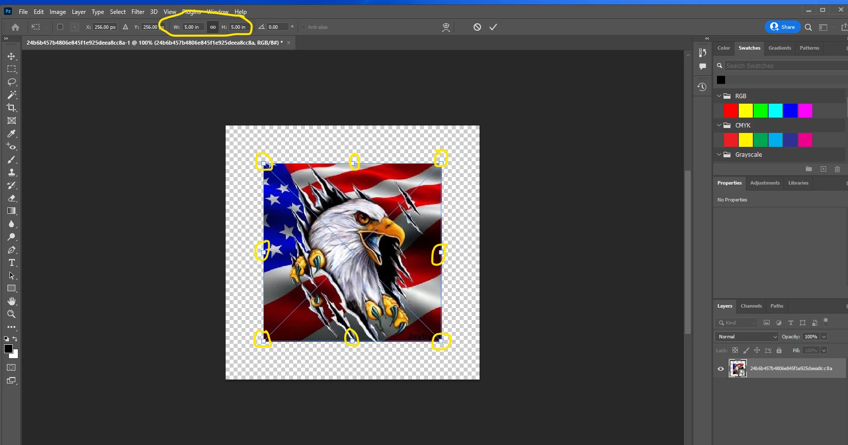

 please help
I am having issues with sizing .If I go in and size my design the way you show here it changes my canvas size only .With that being said I resize my image like the pic I have added here. The thing is I upgraded and purchased a new Dell yesterday with a graphix card and now the sizing is off in photoshop. ( example ) photoshop will say my image is 8x8 but when i print the image its actually 7x 6.25 .  Im assuming my version upgraded when I redownloaded it. I am going to attempt insalling a previous version of photoshop to see if that fixes it but...is it a bug and how do we fix this because I rely on this before i print my images. I sublimate shirtsand tumblers so my sizing is a huge factor here.
March 15, 2022
I rolled the update backwards and it did NOT fix the problem. I reinstalled the newer verion.
