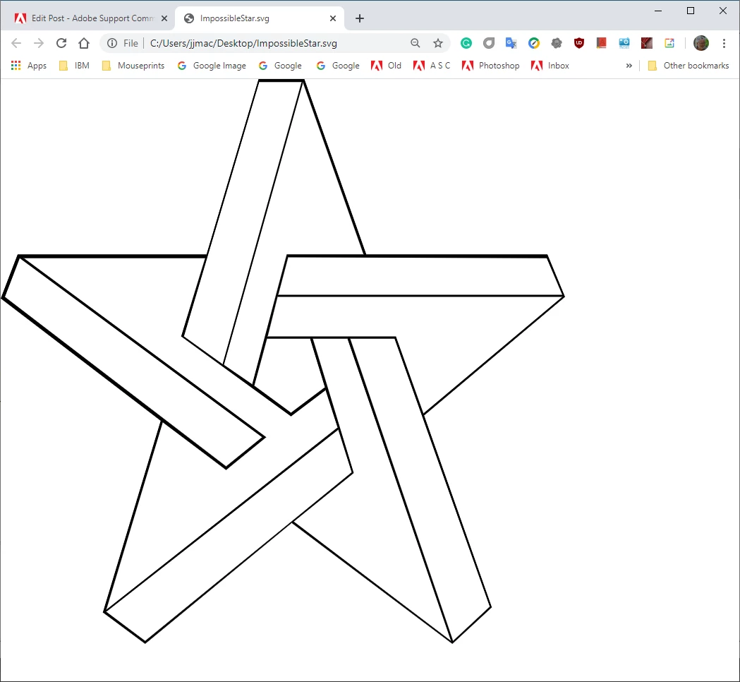

The thing is a Photoshop script will lose control if the script open a smart object layer that is a AI vector file.  For Adobe Illustrator will be started by your Operating systems file association for the temp vector file Photoshop will create for the object file either Linked or embedded in system temp space.   You would need to saved that files from Illustrator.  When you do that if you do not save the system temp work document created by Photoshop. Photoshop will not update the documents smart object and the script would have no idea if you save to file somewhere else from Illustrator. This script could most likely access the temp vector file created by Photoshop and use JavaScript do a file copy to some location that you programmed into the script. If it exist either replace or add a sequence  number to the file name. You can not export the Ai file from Photoshop for Photoshop does not support AI vector file formats.  Photoshop may be able to export shape layers as a .svg file and the .svg file may well contain vector graphics.  You can open the .svg file in a text editor to see if any Paths are recorded in the text .svg file.
Photoshop can rasterize AI files and process the raster layer. Photoshop can not process AI files.
Here is a Shape layer I exported as a .svg file. Included here in text format.
<svg xmlns="http://www.w3.org/2000/svg" width="3200" height="3200" viewBox="0 0 3200 3200">
  <defs>
    <style>
      .cls-1 {
        fill-rule: evenodd;
    </style>
  </defs>
  <path id="Impossible_Star_1" data-name="Impossible Star 1" class="cls-1" d="M1862.17,400h259.68l351.56,993.39H3500.12L3600,1634.35l-799,672.12,383.52,1086.4L2960.8,3600l-910.86-684.81L1218.98,3600l-239.7-177.54,327.594-1086.4L400,1642.8l95.88-249.41H1566.54Zm4,16.909L1438.7,1858.39l219.73,156.41L2105.87,416.909h-239.7Zm247.69,4.227L1666.42,2019.02l159.8,109.91,195.75-735.54h435.46Zm-83.9,989.164-55.93,211.36H3584.02l-87.89-207.13Zm-1498.125,4.23L1906.12,2429.06l-227.72,186-359.55-270.54-319.6,1061.03L2309.61,2374.11l-67.91-211.36L2045.94,2310.7l-623.22-452.31,135.83-443.86H531.835Zm-23.97,0L423.97,1634.35,1678.4,2593.92l203.75-164.86ZM1970.04,1634.35l-55.93,224.04H2641.2l155.8,435.4,787.02-659.44H1970.04Zm-59.93,236.72-71.91,266.31,207.74,152.18,191.76-143.72-83.89-274.77h-243.7Zm259.68,0,231.71,760.9-339.58,274.77,890.89,676.35L2365.54,1871.07H2169.79Zm211.73,0,583.27,1712.02,207.74-194.45L2633.21,1871.07H2381.52Zm-67.91,515.72L999.251,3418.23l219.729,164.86,1170.53-955.35Z" transform="translate(-400 -400)"/>
</svg>
Here is how Chrome displays thet .svg

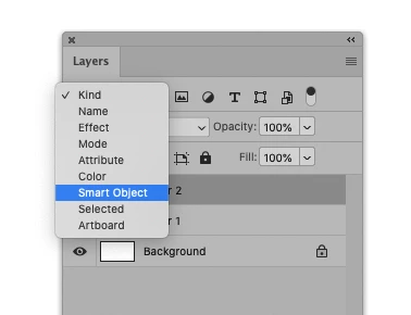

Maybe it would help you do it manually if you hid all non-SOs with the Layers Panel’s Filter.
And a warning: If you created the Vector SOs by pasting content copied in Illustrator that will export contents not as ai but as pdf.
