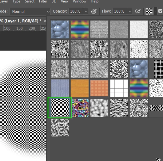

    Trevor.Dennis
    April 16, 2018
    David, that would not cause the brush to expose the transparent chequerboard.  It might be that what the OP is seeing is not in fact the transparent chequerboard, but that the OP is using the Pattern Stamp tool....
    and that the selected pattern is chequerboard like.
    If all else fails, reset the tool from the left end of the Options bar.  In fact, reset ALL tools because there is usually no reason not to.
