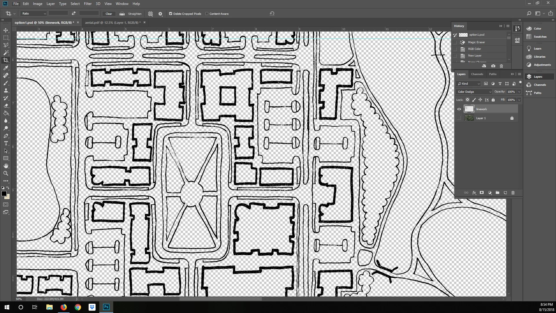

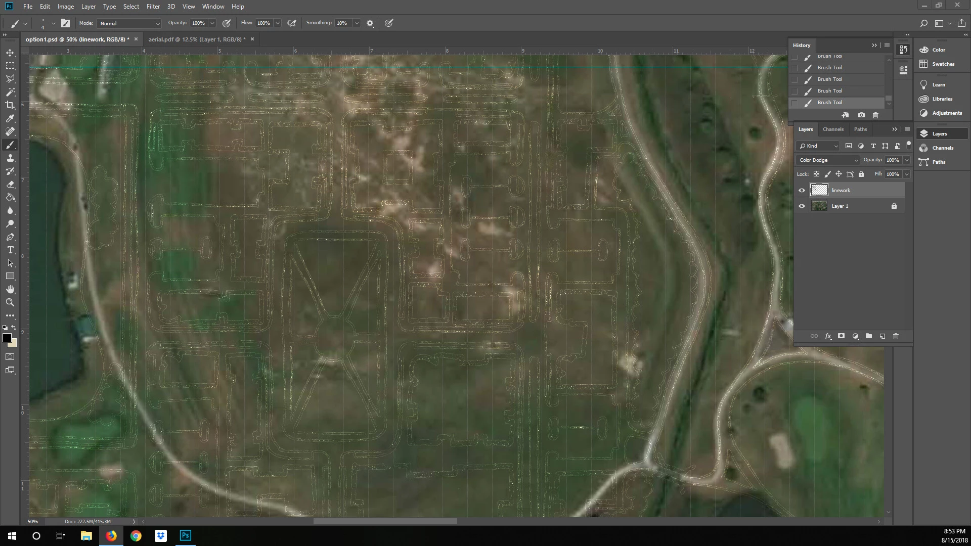

Hello!  I have some scanned-in hand-drawn linework that is black with a transparent background.  I need to add a raster aerial image underneath the linework.  Whether I embed the aerial file, or place it as a linked file, or even just copy the image and paste it in as a new layer, the layer with the hand-drawn linework goes from black to kinda gray and transparent.  The linework looks fine if I turn off the aerial.  And then looks weird again if I turn the aerial back on.

This shows how weird the linework looks when I turn on the aerial:
This shows the linework looking correct when the aerial is turned off:

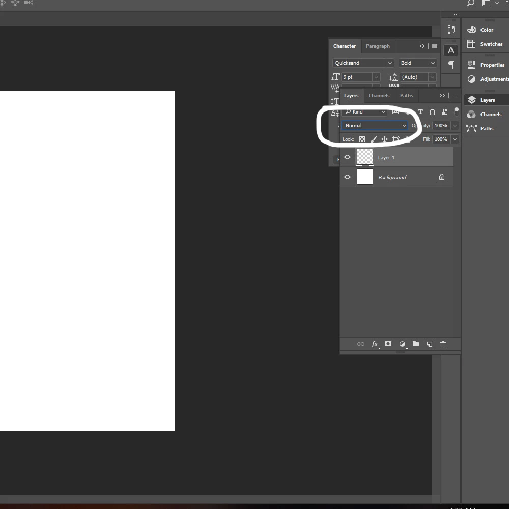

If you see in your layers panel you have the blending mode color dodge
change to normal
Regards
E
lambiloon
August 16, 2018
hi yes check the image you will see the mistake at your side
change to normal
