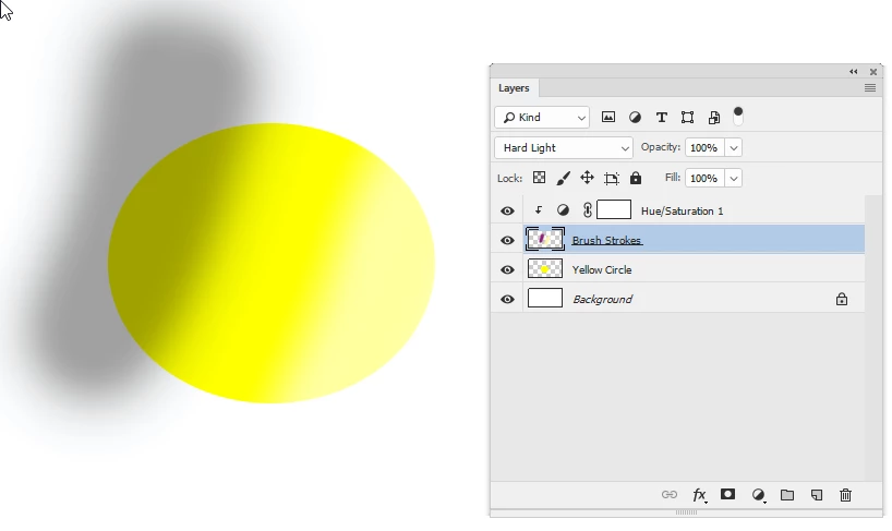

    Thank you Mylenium. I do appreciate the help. This is a little complicated so bare with me. This might be painful lol:
    Your suggestion to use a hue/value adjustment layer on top works! It's perfect. But there's one last hurdle.
    Let me try to explain this:
    On the bottom layer I have painted a solid circle with a hard brush, using a yellow color.
    The layer above is set to Hard Light. Now when I paint on this layer, it adds highlights or shadows to the yellow circle beneath, and the intensity of those shadows/highlights depends on the value of the color I am using. Using grayscale colors(shades) work perfect for this. But if I use anything other than grayscale colors (i.e. any other color), then the shadows/highlights that I am painting become saturated with color - not what I want. So, I want to restrict this hard Light layer to grayscale only when painting on it, so that even if I paint with colors on it, it forces those colors to completely desaturate and become grayscale only.
    So, your trick worked - above the Hard Light layer, I added a Hue/Sat adjustment layer, and pulled the saturation slider all the way to the left - and it works. So I now have 3 layers in total. The bottom is the solid color, the middle is the Hard Light layer for painting highlights/shadows, and then the top layer which is the adjustment layer which forces the Hard Light layer to be desaturated. Perfect.
    Here's the problem:
    I need the the shadows/highlights to be clipped to the bottom layer (yellow circle). So, I added a clip to the two top layers and the clipping works, but the yellow circle on the bottom is now desaturated - no color shows through.  The problem here is within the clipping masks, but I don't know how to solve this.
    I know there are other ways to do this very easily, but for the time being I need to go this route (I'll explain later).
    Still with me? Thanks! Is there a way to do this?

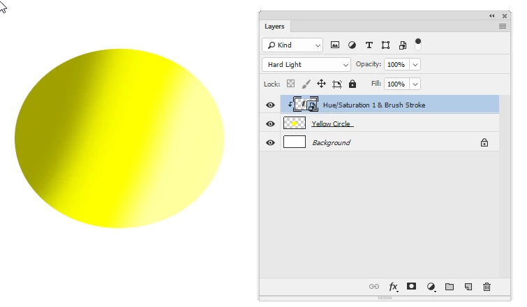

    davescm
    May 19, 2018
    Hi
    Starting with this
    Make the Brush strokes and Hue/Sat a smart object. Then change the blending mode of the smart object to Hard Light and clip the smart object to the Hue/Sat layer
    Dave
    May 19, 2018
    Thanks Dave! But how do i do this:
    I can't figure out how to do that - also, can I paint on a smart object layer?

    Hi
    https://forums.adobe.com/people/boo+radley+2013  wrote
    Question 1: If I switch a layer's blend mode to Hard Light, is there a way to make it so that the layer is also desaturated at all times? So that if I paint on the layer with a saturated color (green for example), that it will only paint the *value* of that green?
    I don't understand what you mean by the "value of green" - the Lightness value , the Hue …..? You could combine an adjustment layer e.g. Hue and Sat ,clipped to the pixel layer (Alt-Click on the border between the two in the layers panel) , then set the blending mode of the pixel layer to Hard Light
    Question 2: If I use an adjustment layer, then painting on it using a black color will *show* the adjustment, and white will *hide* it. Can I reverse this somehow, so that white will hide it and black will show it?
    Any layer mask - shows the layer (or adjustment ) where white and hides the layer (or adjustment) where black. You can't change that - although you can of course use Ctrl+I to invert the layer mask
    It is not clear what you trying to achieve with this. Can you post a description with images that show what you are trying to achieve - that way we may be able to suggest the best way
