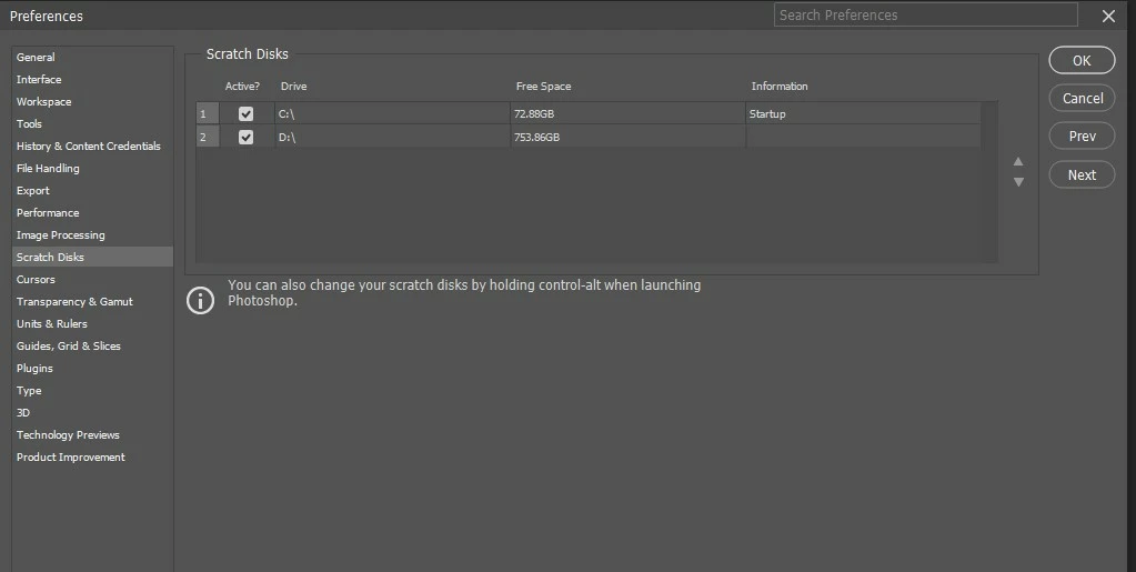

bet1947
August 8, 2023
I Updated my graphics driver to the latest, and I now have 141 GB of scratch disk now. I moved my Lightroom catalog to the 😧 drive. I did a settings reset, Uninstalled and re-installed several times. Problem still exist with the Adjustment layer panel .

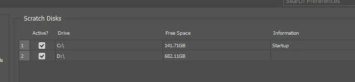

August 8, 2023
Hi Cory
When I set PS into a default state it also reset my stratch discs. Here is my revised copy of my system info showing my stratch discs. Comfirming the stratch discs did not fix the problem.

I have PS on the C drive, and I have a larger Hard drive on D drive. Under scratch disk I put a check mark under D drive. Does that mean it will use D drive if needed? (see photo) I did upgrade to 24.6 and 24.7 , but I had same problem but much worst. The adjustment panel would not work no matter how many times I re-boot, but 24.5 will work fine after just one or  two re-starts. I tryed to update graphic card, but it said I had the latest driver. I will try again.
