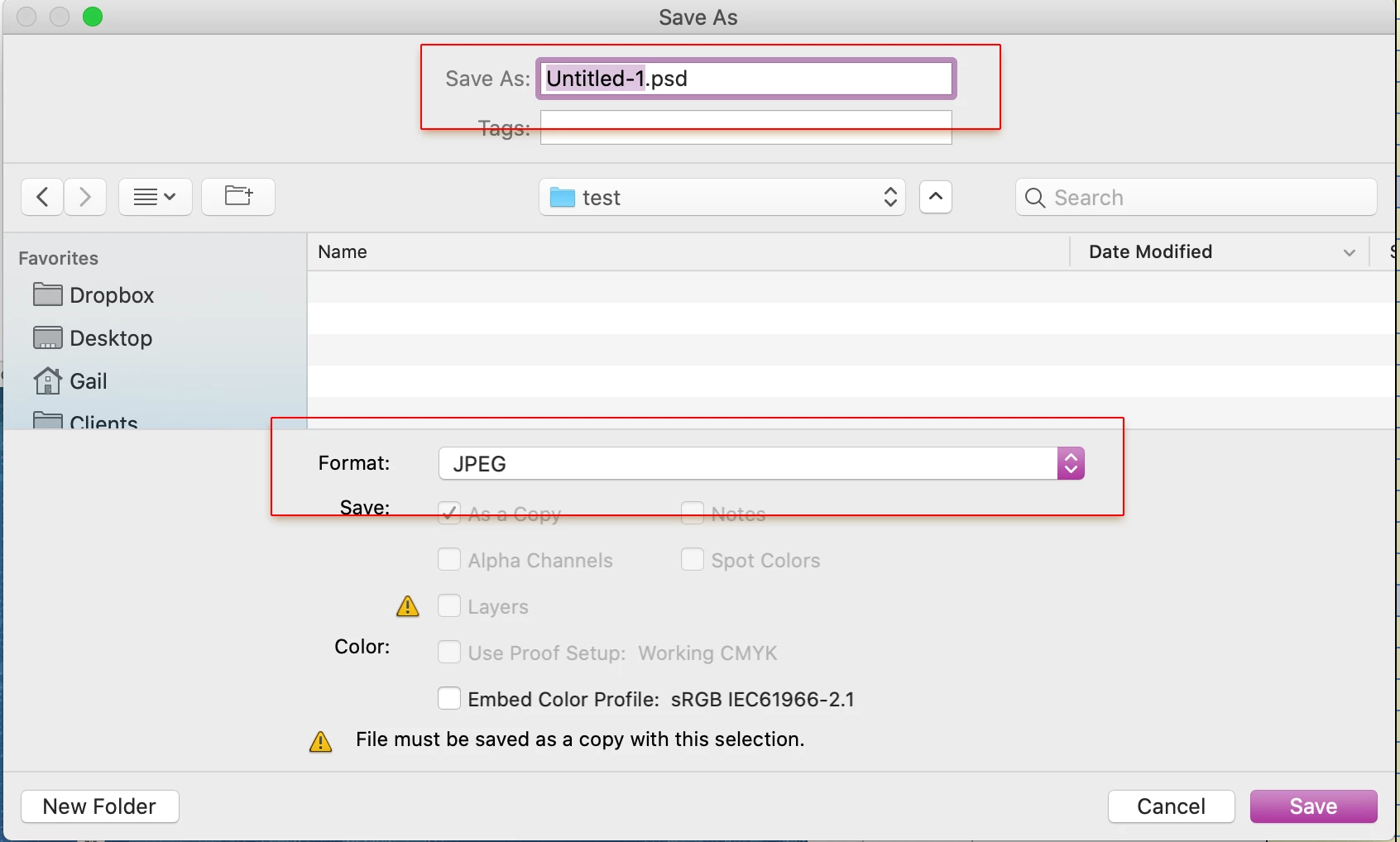

Since updating MacOS to Catalina and updating my Adobe apps (don't remember if PSD was one of them), I'm having an issue with changing the file extensions when saving the file.
When I work on a new file and then go to save, I get a PSD extension by default as usual. However, when I change the format to JPG in the dropdown, the file extension does not change automatically according the format chosen, I have to manually change the extension now. (see screenshot for example)

Hi there,
We apologize for the issue you are facing with Photoshop while trying to save files after the macOS Catalina update.
Would you mind sharing the version of Photoshop you are using by going to the Help menu in Photoshop > System info? Also, when you try to save a file using Save As do you get the Save As dialog box or nothing happens?
There is a known issue with Photoshop on macOS Catalina where the file extension is not changing in the Save as dialog box when selecting a file type from the drop down menu and we are currently working on a fix.
For known issues related to Photoshop on macOS Catalina, please see the below mentioned link.
https://helpx.adobe.com/photoshop/kb/photoshop-and-macos-catalina.html
Nikunj

Hi there,
We are sorry for the issue you are facing with Photoshop while trying to save tiff file on macOS Catalina.
There is a known issue with Photoshop on macOS Catalina where the file extension is not changing if you are selecting a file type from the drop down while saving an image. As a workaround, we need to change the file extension manually in the Save as dialog box after selecting the appropriate file type.
Please check the below mentioned link for the known issue related to Photoshop with masOS Catalina.
https://helpx.adobe.com/photoshop/kb/photoshop-and-macos-catalina.html#CameraRaw
For your files, you can rename the files and change the extension to tif from psd and then try to open the file.
Nikunj
