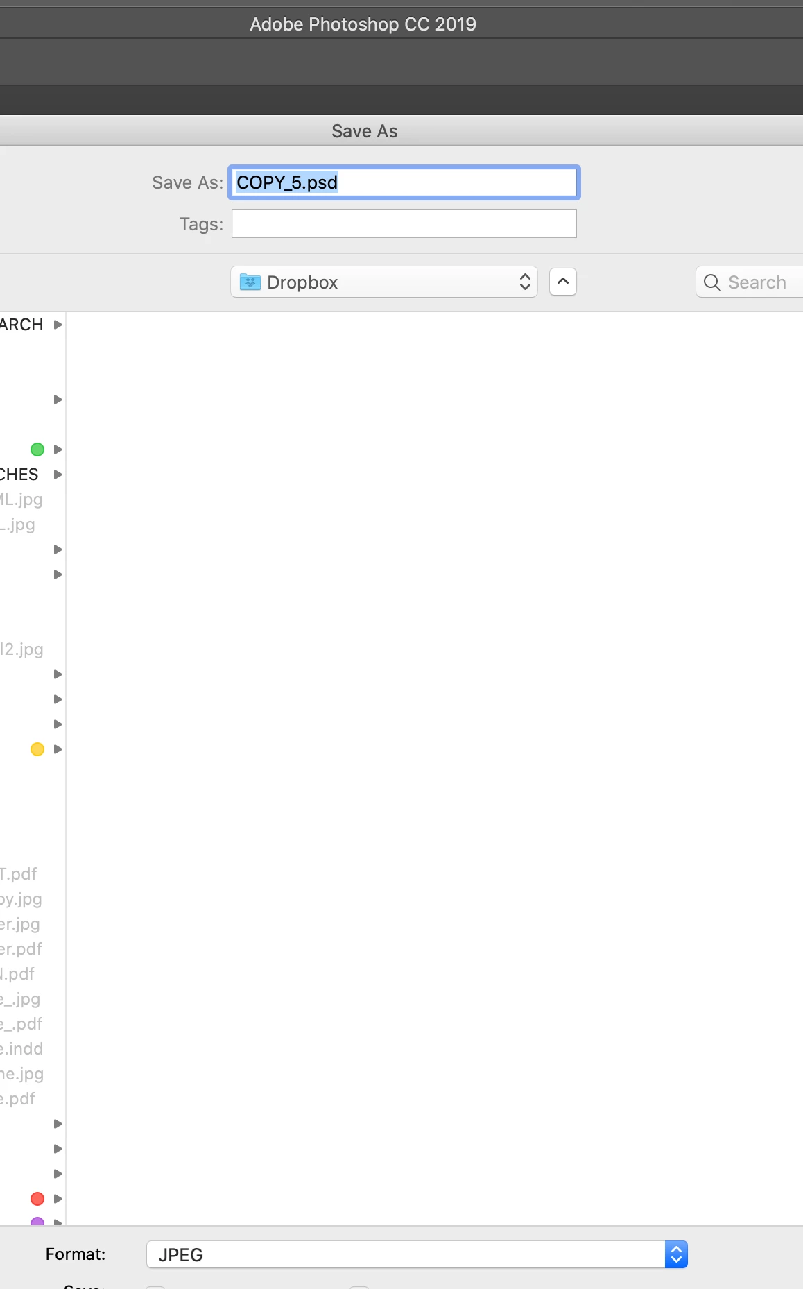

Working on the newest version of Photoshop CC, I noticed when I have, a psd file for example, and I select "jpeg" from the drop down menu in the "save as" dialog box, the file does not change the file extension to the correct format.  I have to manually type .jpg for it to save as a jpeg.  I never had to do this before and was wondering if anyone could provide some insight or a solution?
You can see in my screenshot I have "jpeg" selected and the file name still remains as .psd 😞
The files are already RGB/8 bit, so I'm not sure if there's anything else I should be looking for.  I tried with different types of files as well, help.
