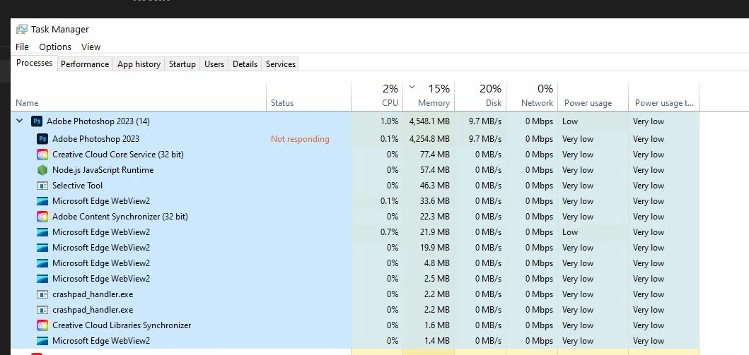

Does anyone know why there are seven instances of Microsoft Edge WebView2 running alongside Photoshop 2022?  I hope I've solved the freezing/crashing issue but Psd is still running sluggishly and  I would still like to know about this change.
I'm looking at Task Manager on Windows 10 Pro, 64-bit (updated just a few days ago).
Thanks, Sidney

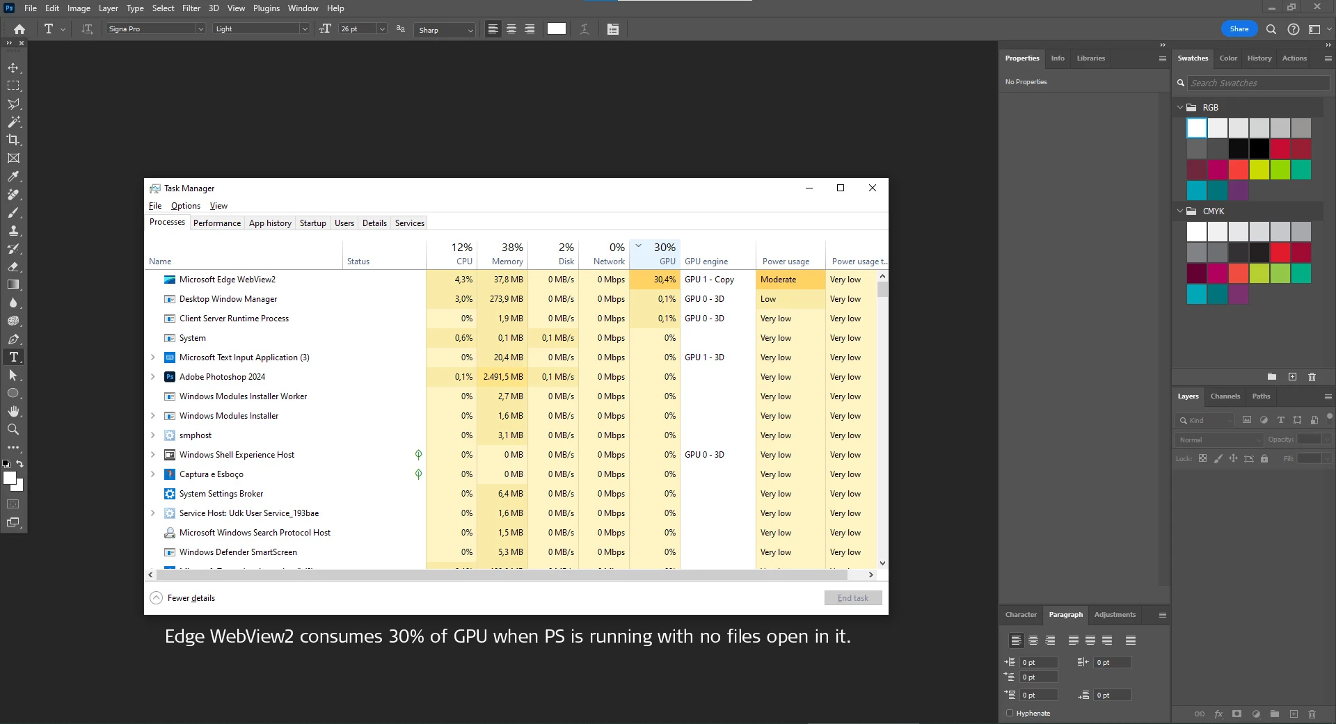

The strangest thing in my case is that when PS is running and there is a file open in it (.psd, jpg, etc), my GPU behaves normally. If I'm doing something to the image, the GPU responds normally, and if I'm not doing anyghing on the file, the GPU stays at 0% usage. But as soon as I close all files and keep PS open, the GPU jumps to a permanent 30-ish% usage by the Edge Webview 2 process... 30% usage of GPU to do absolutely nothing... So, I have to always keep a file open in PS to keep my GPU at 0% (or to behave normally)...

so im having the same problem with it and im a student that is in a digital design class and me and my teacher are trying to  figure out if microsoft edge webview2 is important becasue we both have not seen this before. So we are wanting to know what we should do please let me know  if anyone has a answer yet casue its on all of the computers. Which is making the photoshop appliaction use 50 or more percent of memory. The range of the mbs that are being used are at least 1,000. Please help us out

I'm having the same issue! I can't open most of my files without PS freezing up and having to shut it down on task manager where I see several Microsoft Edge WebView2 running in PS. I use PS for work and my livelihood depends on me being able to get stuff done quickly. It has easily doubled to tripled my processing time and is putting me way behind. How can I fix this? I called PS support and even did a screen share and they said it was my graphics card so I updated all of my drivers and got rid of everything unnecessary that would slow it down and still nothing! I have an intel core i5 10th gen card. Could it use updating? Perhaps. But should I have to go buy a new graphics card just to get PS to work? Heck no! How can I fix this issue before it runs my business and my sanity into the ground?
