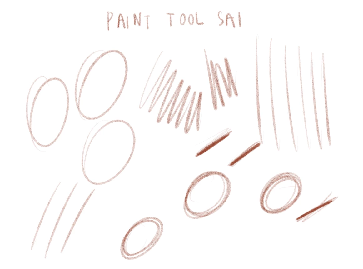

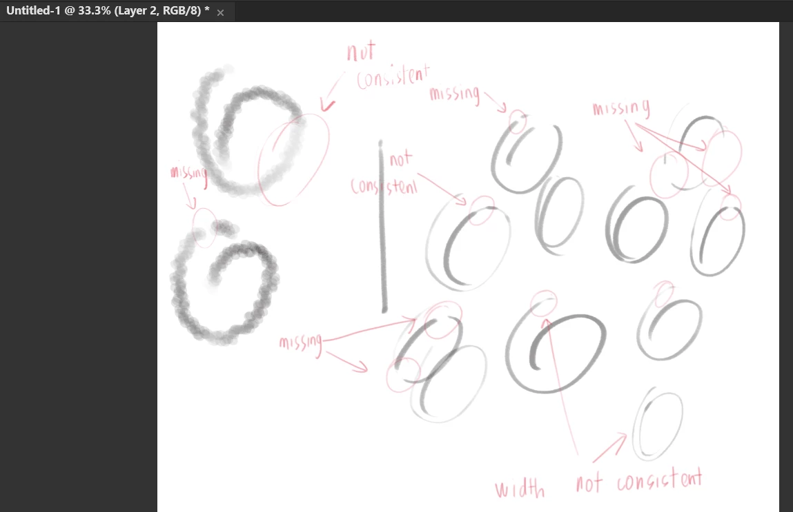

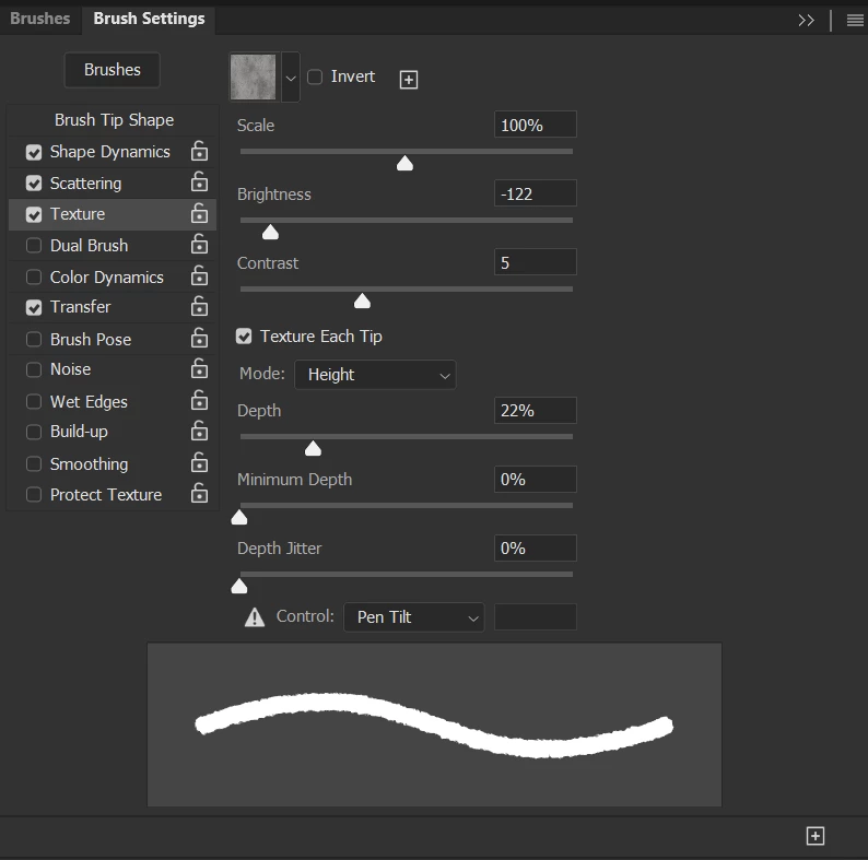

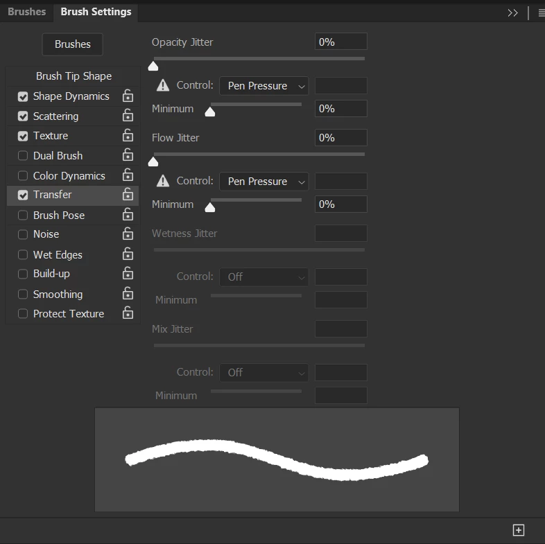

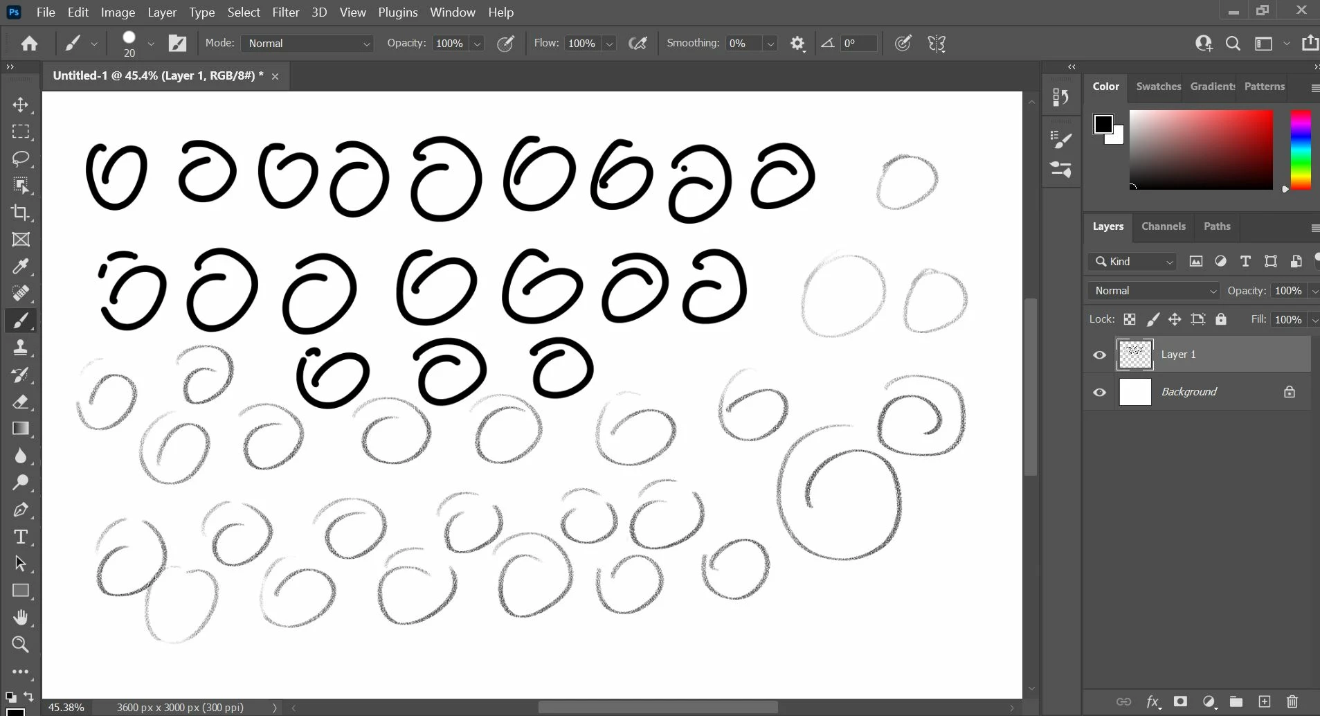

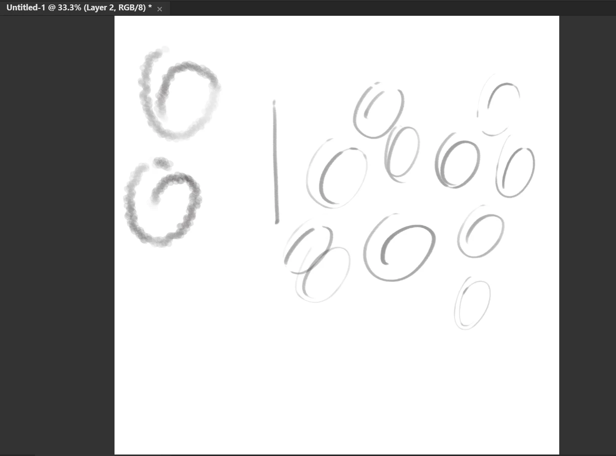

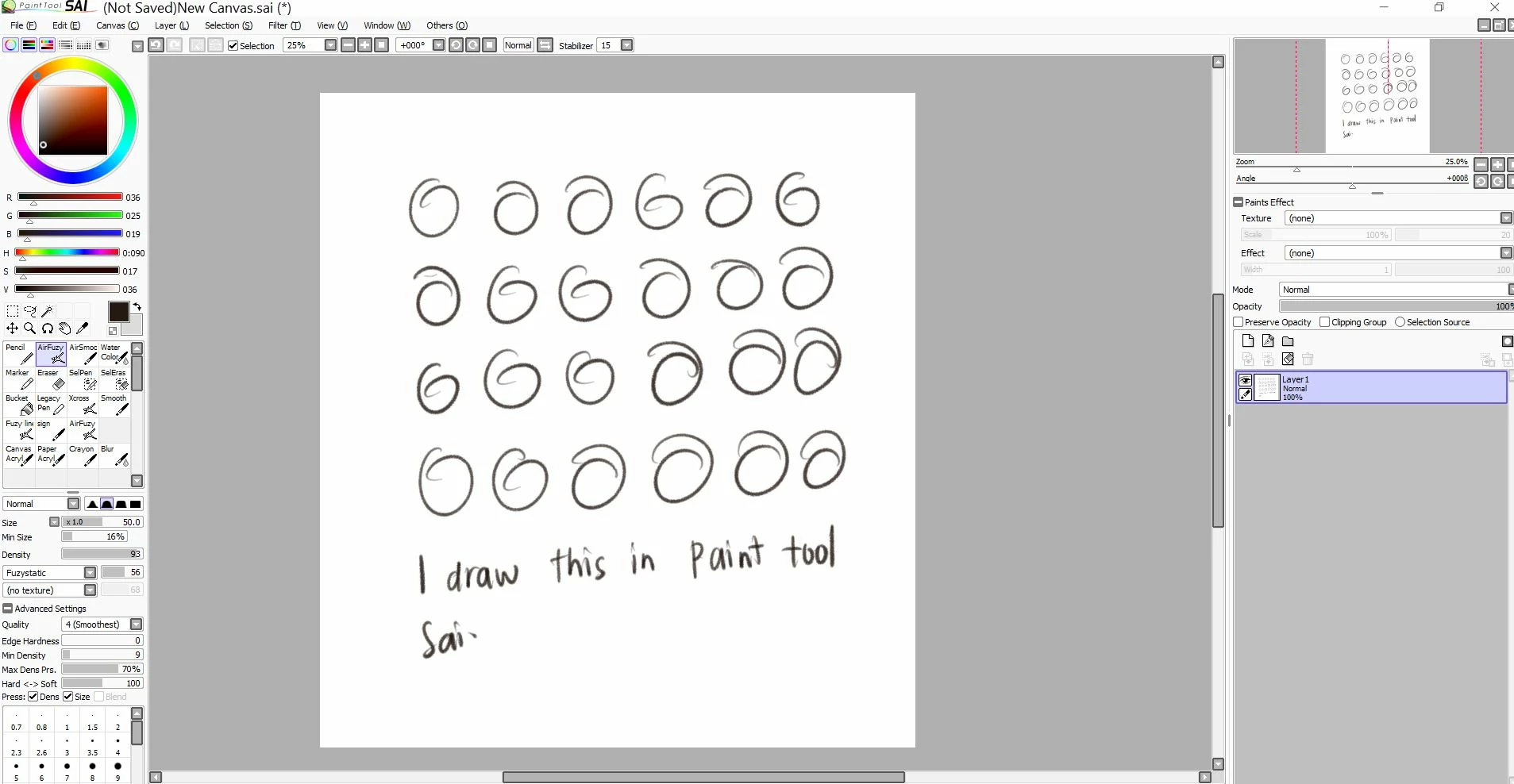

Hi guys, the first two images is what happening to all my Photoshop brushes regardless which brushes do I use. It creates the disconnected lines and its width is not uniform eventhough I draw with the same pressure. I tried to draw in Paint tool Sai and I attached the image here as well. It works perfectly fine. So I don't think my tablet screen or my pen are the issue. Does anyone experience the same thing and how do I fix this? T . T

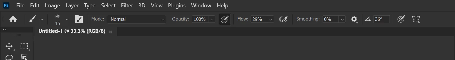

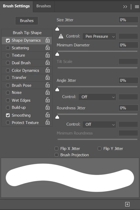

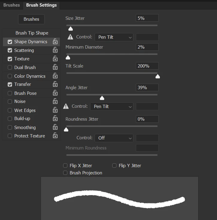

The following screenshots show the setting for one of my brushes. As mentioned previously, the same problem also happened to other brushes. But the brush setting given is what I used the most.

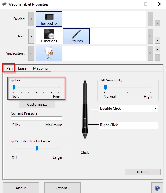

One user solved the same issue by setting pen pressure to its most sensitive position in Wacom Tablet Properties

You say this happens with all presets?  It would have been better if you'd demonstrated with a plain vanilla preset with minimal, or no settings.  From the screen shots you have provided (well done for that btw) the only one that could cause that effect is opacity jitter which have set to Pen Pressure.  So try again after unchecking Transfer.
Something like this, (and I have never seen anything quite like it) should be approached as simply and with as few variables as possible. i.e. a full hard round brush with no settings.
Looking at your later screen shots, I see you have tried with a round hard brush, so that takes that out of the equation.
I don't see how smoothing could cause that, and Shape Dynamics are not going to be a problem if no settings are checked.

Hi there, thank you for your response. I really appreciate it. So here's my answers/update in respect to your questions.
Does it only happen when using the tablet? Yes. I tried to use a mouse to draw and it worked fine. Here's the look. I use round brush with all boxes unticked and also a tetured brush.
I have tried with multiple new documents as well and drawing with mouse is Ok but not with the stylus.

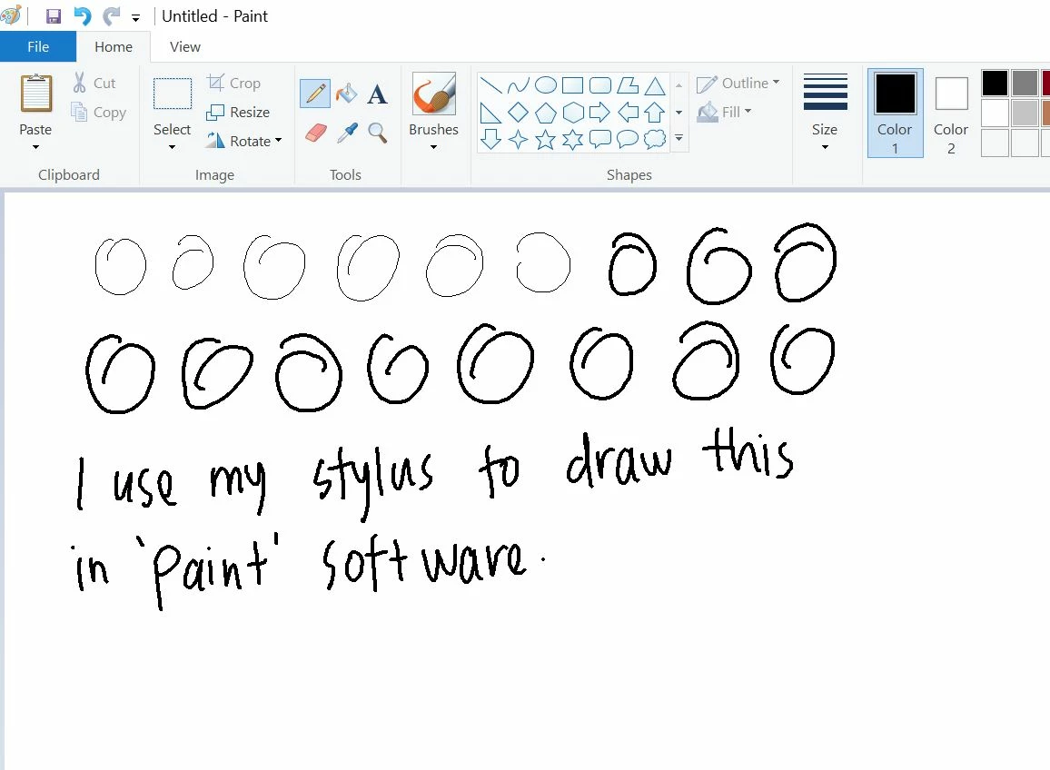

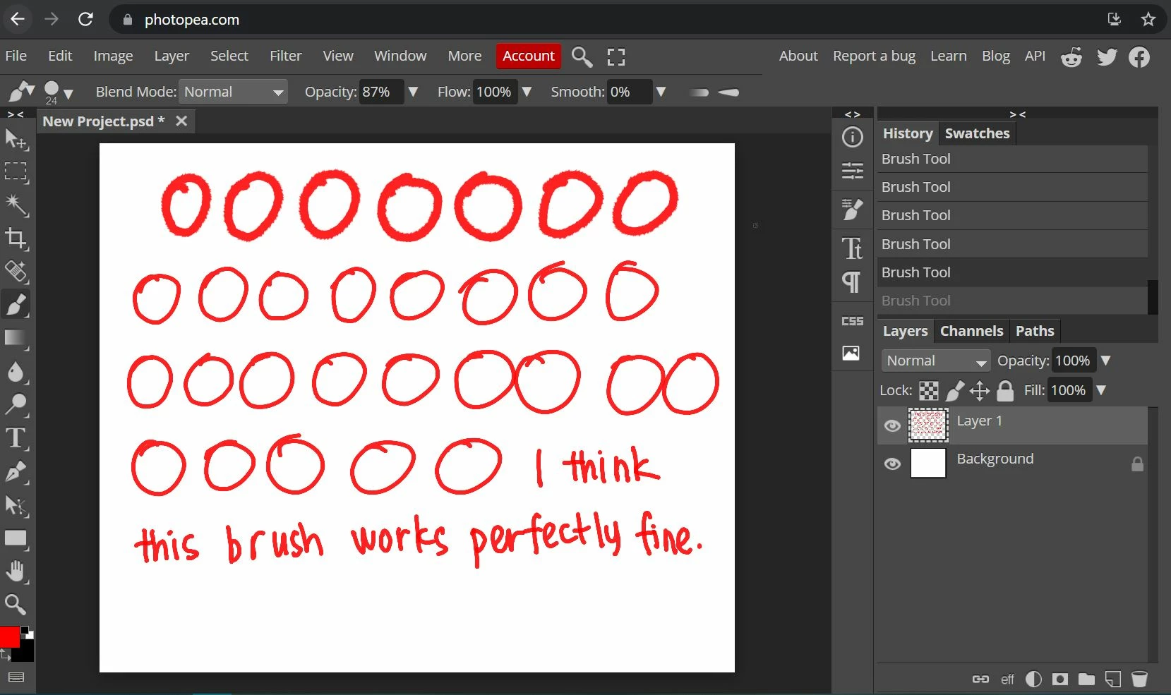

So, I tried to draw with my stylus in other programs to check if the stylus is the problem.
I drew in Paint, Photopea and Paint tool sai.
My stylus work smoothly in all 3 softwares I tested.

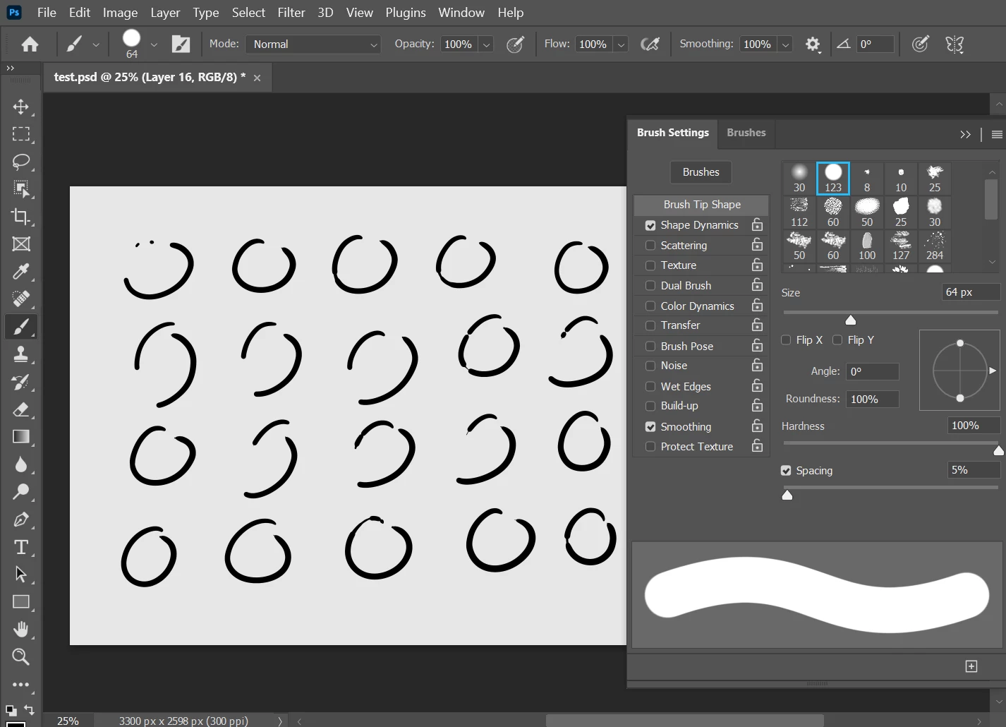

And here's the result when I drew in PSD with a hard round brush (all unticked boxes) and a textured brush. I realised it occcurs more often when I use textured brush.

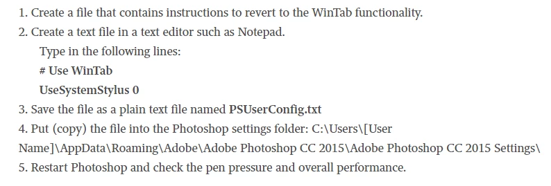

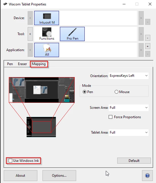

Do you know if you are using the Windows Ink or Wintab API?  Check to see if Windows Ink is checked in the Mapping tab of Wacom Properties
If Windows Ink is checked, turn it off, and follow these instructions:
I have been thinking that Windows ink worked better than it used to with recent Photoshop versions, but I am still using WinTab.

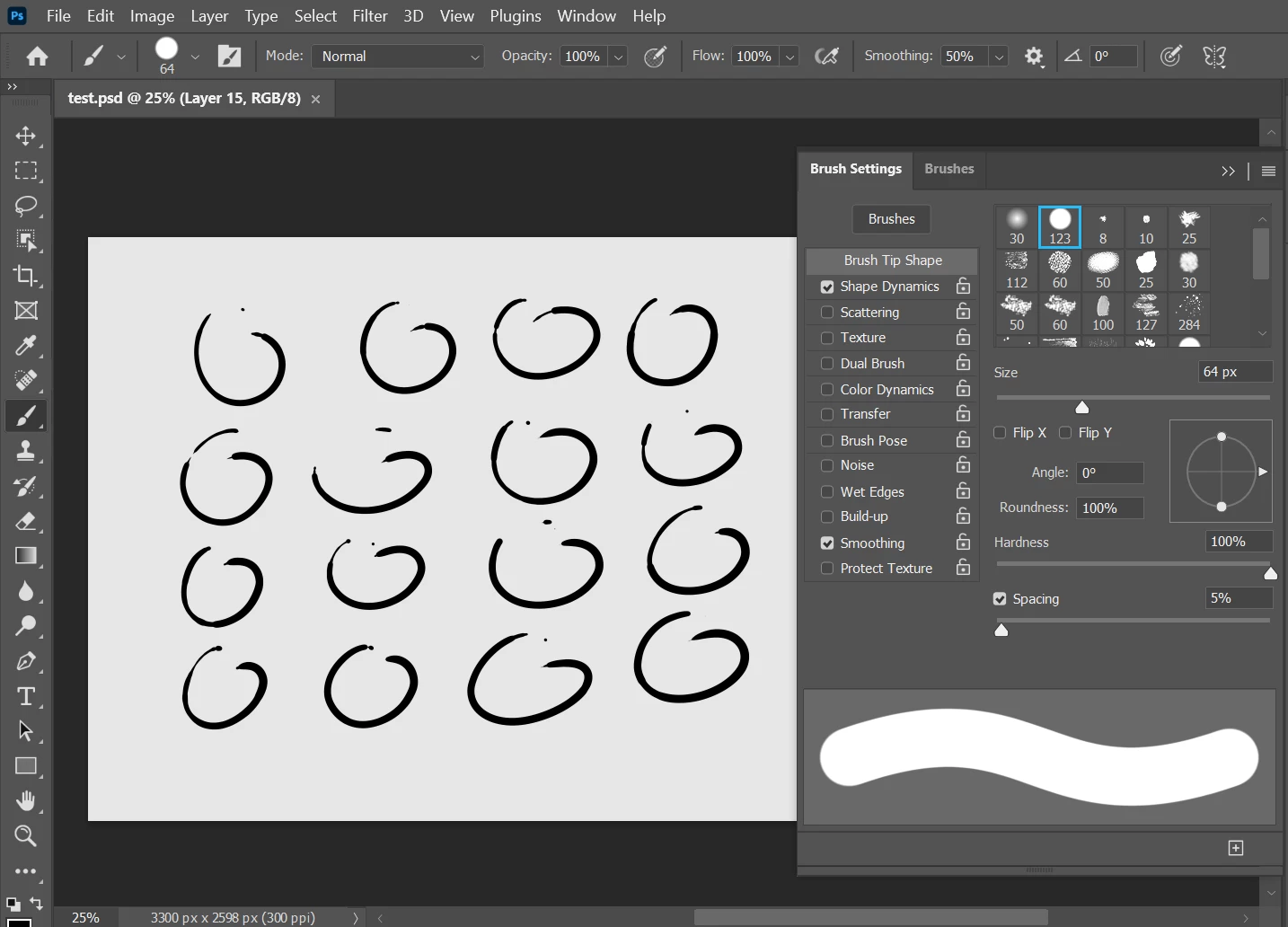

Your smoothing is turned off.

Thank you for your suggestion. But it didnt work out as well.
Heres the outcome with 50% smoothing.
Heres the look with 100% smoothing.

This is the shape dynamic setting if you are wondering about it.
This is the default psd hard round brush and I havent changed any of the setting at all.
