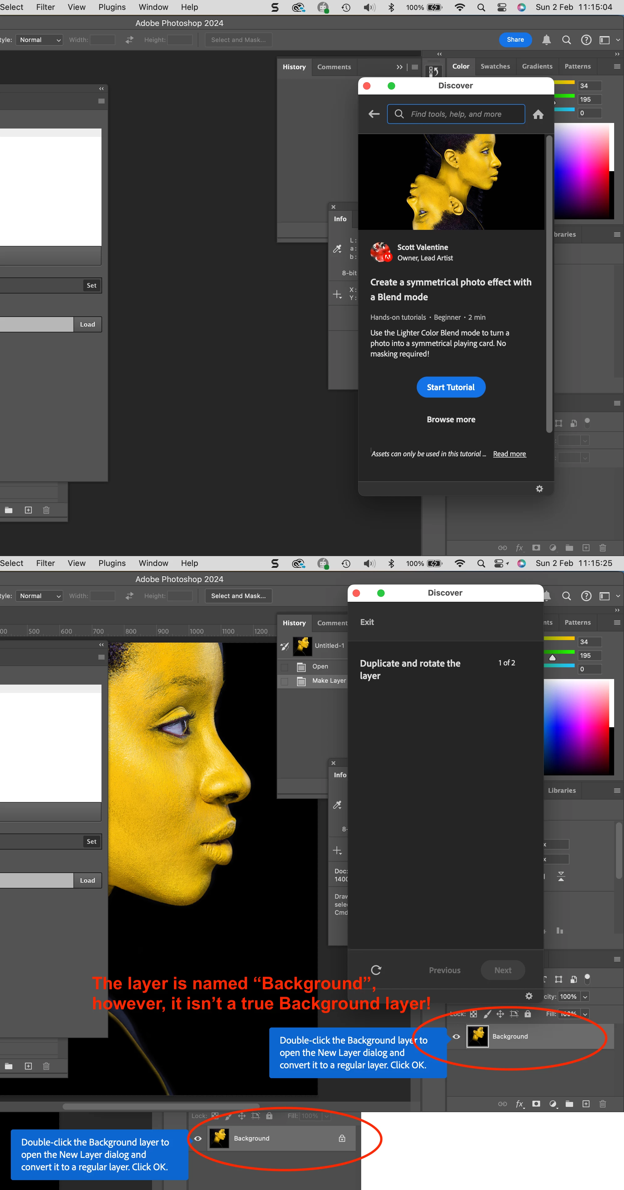

Stephen Marsh
February 2, 2025
I am logging this with Adobe.
jane-e
February 2, 2025
@Stephen Marsh
I looked at this earlier today and found that when I double-clicked the title, it went into rename mode and highlighted the word "Background".
Thinking about it again, the only way this could happen is if it not really a background layer — it's a regular layer named "Background". If it were a true Background layer, it would have been renamed to Layer 0 and the tutorial would have continued.
Do you agree or do you have other thoughts?
Jane
Stephen Marsh
February 2, 2025
@jane-e
I agree that it's not a true Background layer.
I have logged this with Adobe.

New Participant
May 17, 2023
Just want to add that I am having the same problem. The problem is that the file that comes with tutorial is already unlocked an not a background layer to begin with.
Converting the file by selecting New / Background From Layer and then trying to unlock by double clicking as advised by the tutorial pop-up doesn't work for me either. I'm just going to skip this tutorial, which is annoying. Hopefully this will be fixed in future.
