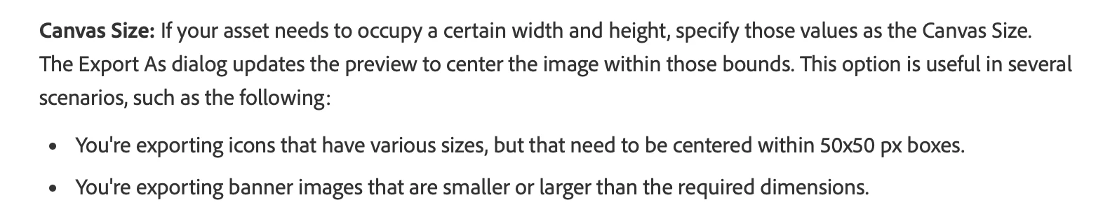

And another thing. This article explains You could alter the canvas size while exporting to have some control on the output size: https://helpx.adobe.com/photoshop/using/export-artboards-layers.html
But when I try this with an image inside an art board (so not just the canvas), the export window crashes.
March 21, 2024
Still no fix for this, Adobe? This really messes with our workflow here. We have to be able to export multiple Layer(folders) to PNG files while keeping control over the file size (in pixels) of those exports. That was possible by applying a mask to those layers to determine the size.
We can not use the size of the canvas or art boards as suggested because the exports all need to have different sizes. Creating an artboard for each individual image would be crazy.
Please fix this.

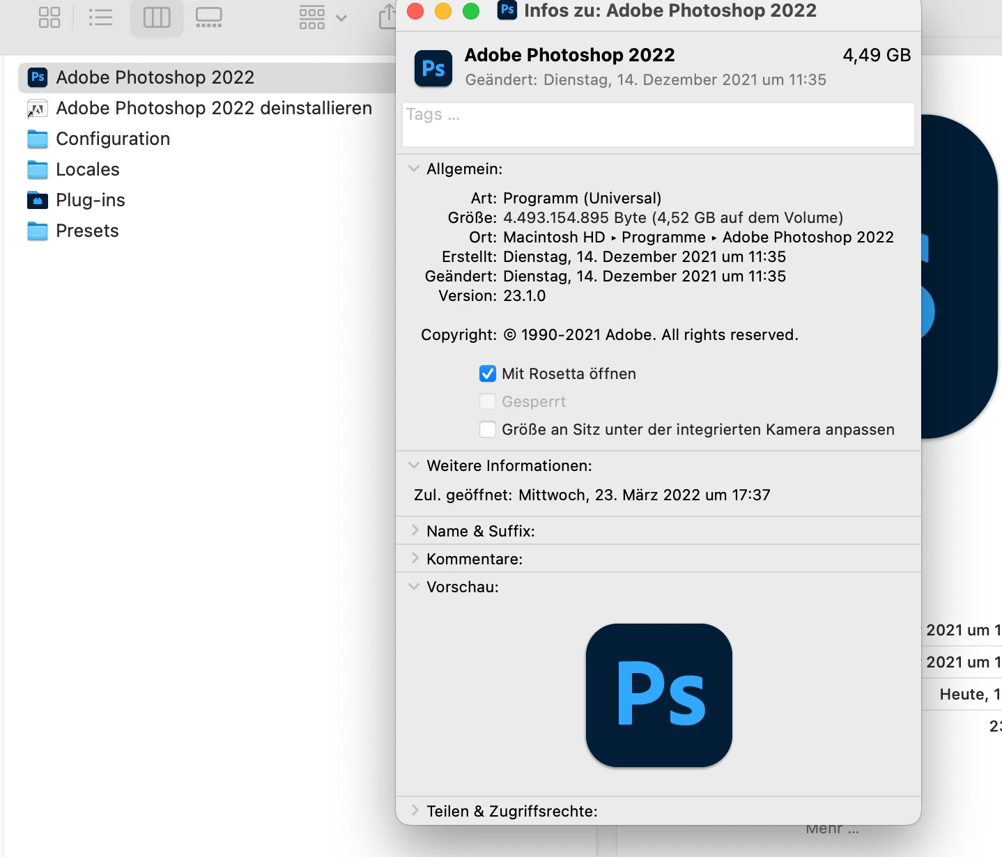

Hey, @julieb28824091
I can only offer a "work around".
Go to programs, right click Photoshop and in the "information" menu – select open with Rosetta.  
That way it behaves like it used to for me. But it is also slower this way and there's a bug in this mode, where PS might crash if you try to move a shape's point and transform the shape into a regular path. (Can happen, but doesn't always.)

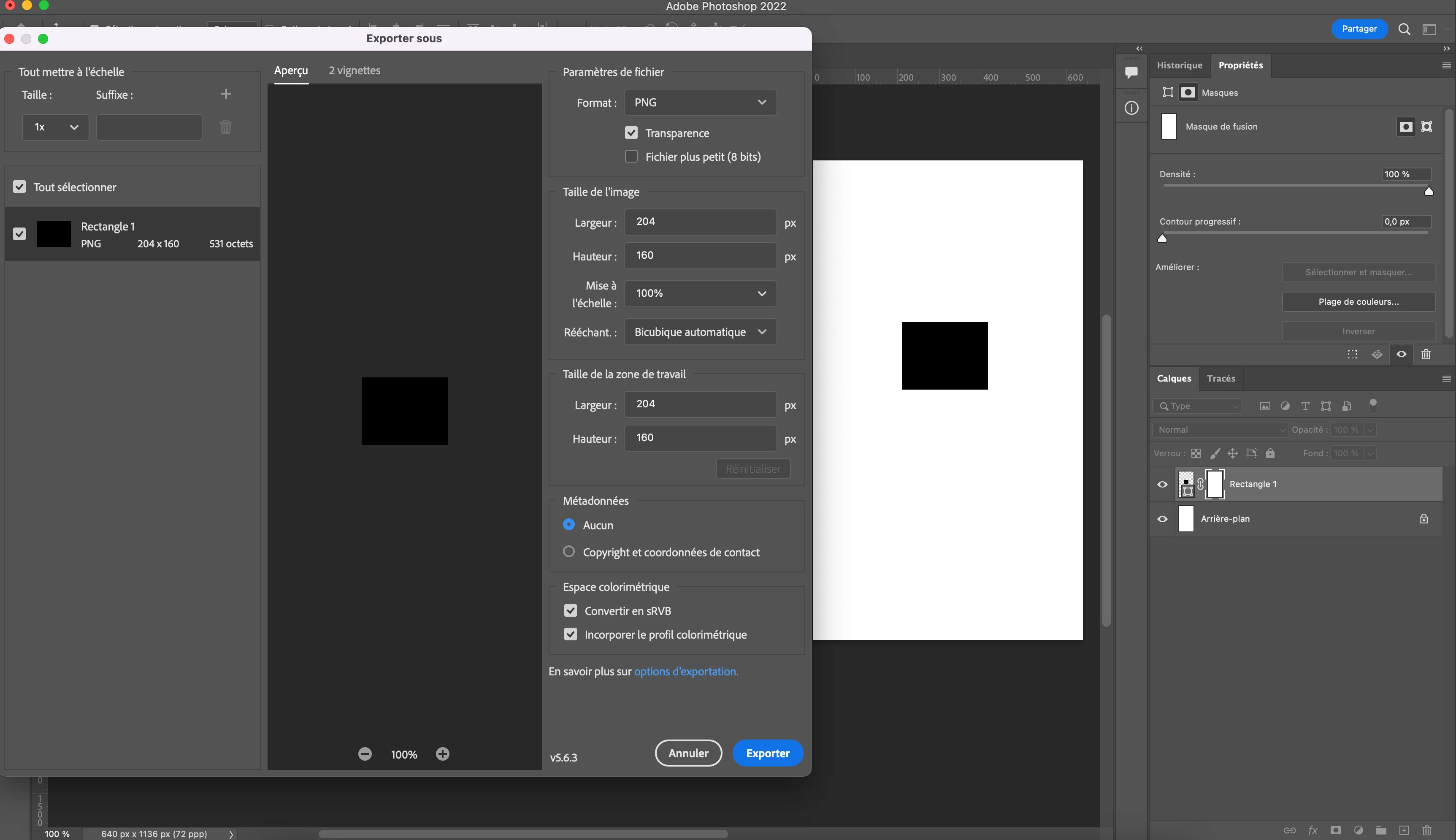

julieb28824091
March 23, 2022
I would like to export a layer with a mask, in PNG, with my layer taking the size of the mask.
I could do it before, but now I have a new computer it doesn't work anymore, my element keeps its size but not the size of the mask.
Do you know how I can fix it please?
Thank you!
NB:
macOS Monterey - 12.2 // Photoshop 2022
PECourtejoie
PECourtejoieCommunity ExpertCorrect answer
March 23, 2022
HEllo, I think this function exists only in the legacy export as function that you activate with the menu Edit Photoshop/Preferences/Export
