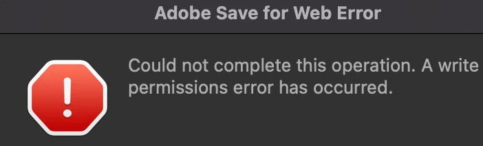

P: Save For Web error A write permissions error has occurred Photoshop 22.1.1
I am using the PS 22.1.1 version and when I try to save for web I get the error. "Adobe Save For Web Error A write permissions error has occurred "
Any help?

Photoshop still not able to <Save for web> with Dropbox backup enabled. Fiddly and inconvenient to disable.
Workaround : In Photoshop <Save for web>, Click <Preview> button bottom-left; your animated GIF will open in your default browser, right-click the gif in the browser and <Save image …> either to Downlaods or nominated folder.

I think this is the thread I replied on earlier in abject frustration. I am using PS 22.4.3 on an M1 MacMini (16GB RAM/2TB HD) I was getting this error from the first time I used it. I uninstalled, reinstalled. I wiped the disk, set alternative admin logins and looked around in vain trying to follow that stupid Link that has been offered as a solution for this stupid problem that revovles around resetting or setting permissions that every other version of Photoshop has managed to do just fine on its own.
ALL TO NO AVAIL.
I caught mention from a poster - not sure who it was who mentioned that they were backing up their desktop. I realized that I was also backing up my desktop with DROPBOX (I work on several machines so its helpful to do this). As SOON as I disabled BACKUP DESKTOP AND DOCUMENTS in Dropbox, I could go back to using the Save As function as normal.
I dont know why (other than permissions that take over in DropBox to allow for persistent Desktop backup) but it didnt work before I disabled and it worked after so....
Anyway, fair is fair. I was whining about it when it was happening, so thought I'd share my experience with how I stopped it.
Hope it helps out, it is a frustrating error.
