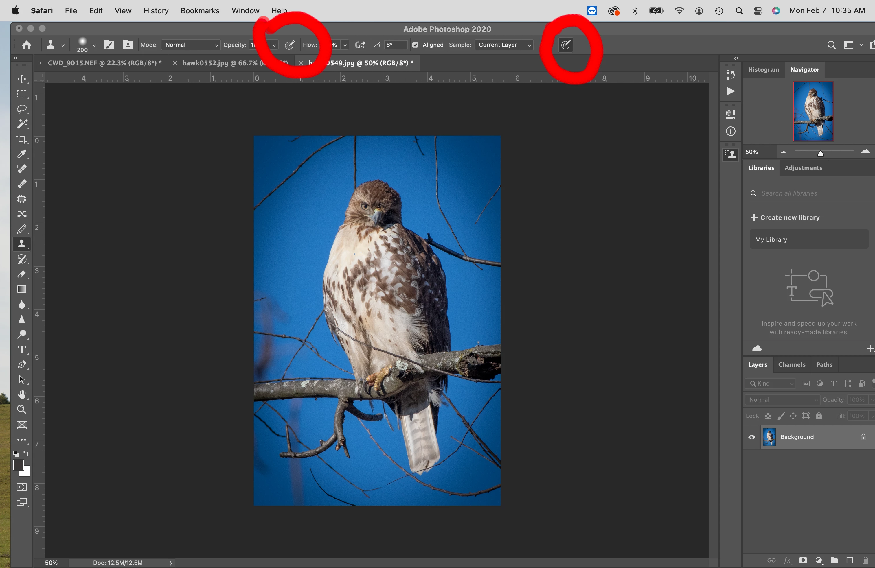

I had the same problem on my Mac M1 with PS 21.2.12  I solved it by clicking on these:

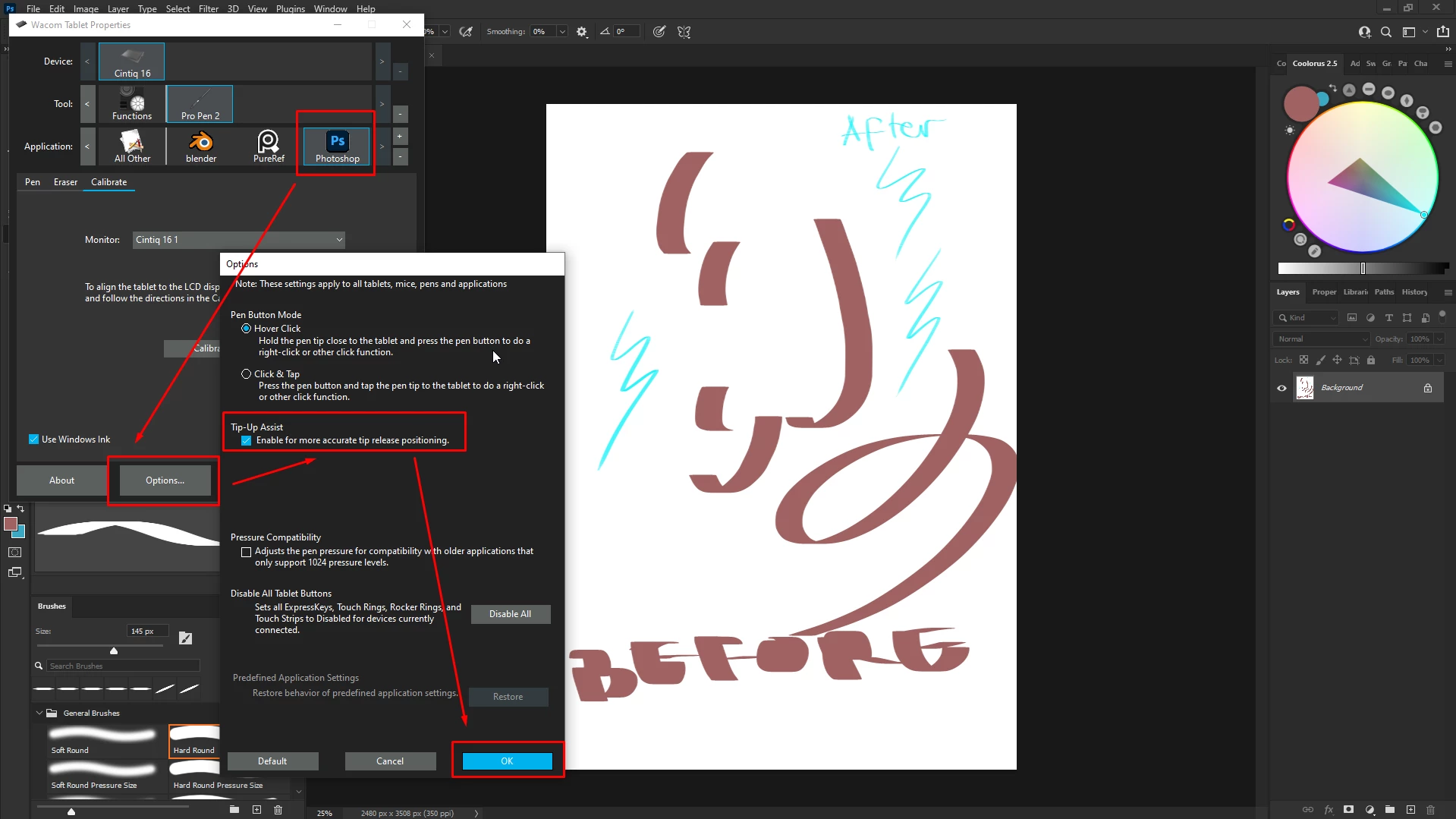

WORKS FOR ME!!
1. I just install photoshop I got from "photography" plan
2. My Cintiq pressure doesn't work
3. I read and tried tips and tricks above but it doesn't work
4. I add photoshop into my wacom "application" setting
5. I disable "Tip-Up Assist"
6. My Cintiq pressure works
7. I re-enable my "Tip-Up Assist"
8. My Cintiq pressure still works
9. I hope my tips works for you also
