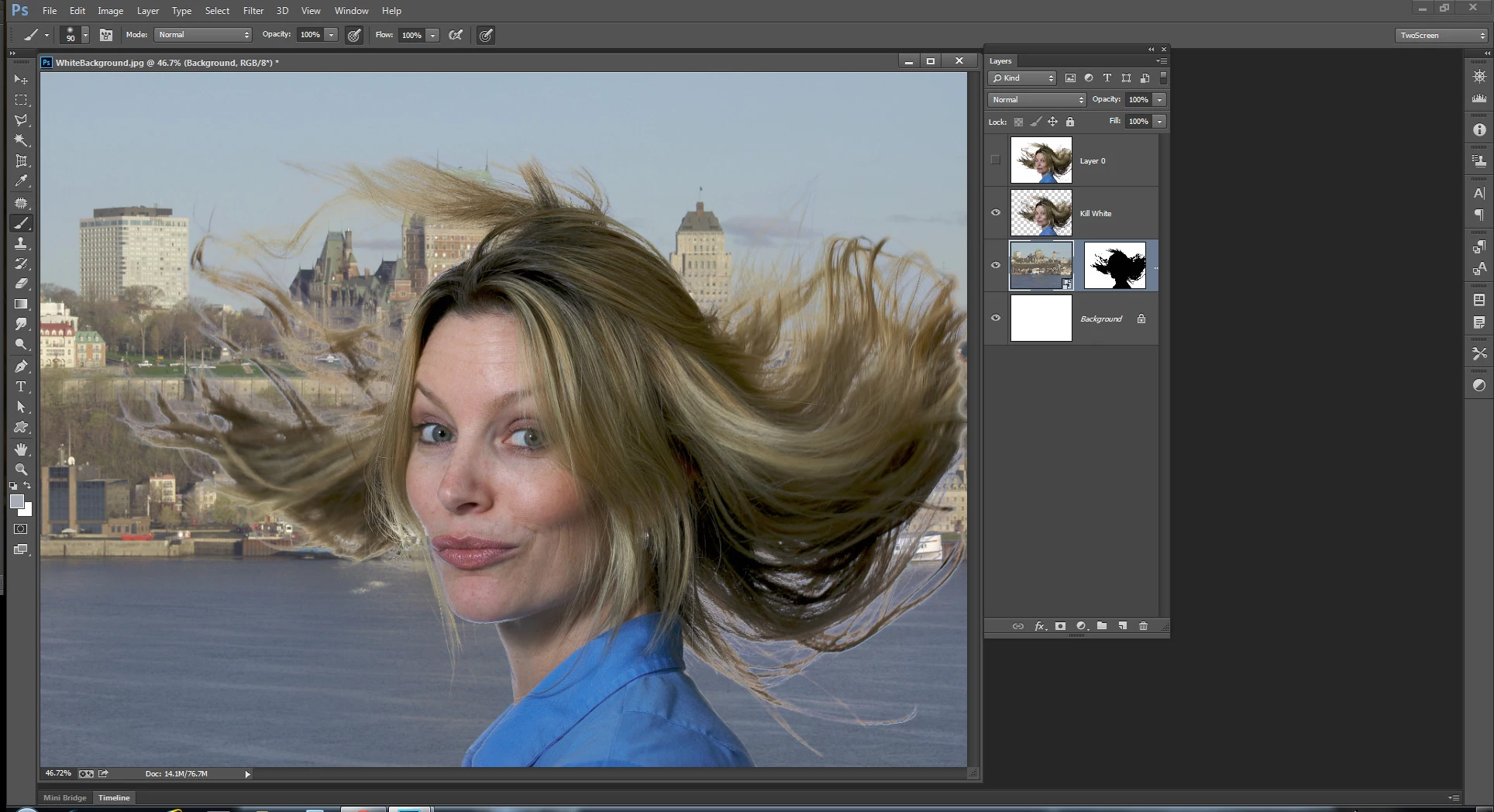

    Hi JJMack.  Thanks for the comment.  Perhaps I should have more clearly stated in step 1 that you should open a document containing an image with a white background, from which you would like to drop all the white.  AT the completion of the process, your document should look something like this....

    Looks like you loose white inside your subject as well. There are plug-ins like "Kill white" that will also do that also without all the layers.. You could also automate your process using Photoshop action support, Then your memory just need to remember the action name and where you store the action. The action may also generate some warning massages about the number of pixels selected. Since I do use Kill White Plug-in once in a while and it only a 32bit Plug-in I recorded your solution into an action however I merged your three layers into a layer name Kill White. So I can use it the Photoshop 64 bit version. However complex edges will have bleed for the white will not be 100% white in the fringe areas.
    http://mikes3d.com/extra/wp-content/uploads/2010/07/apple.png
    http://mikes3d.com/extra/wp-content/uploads/2010/07/drawing.png
    http://mikes3d.com/extra/wp-content/uploads/2010/07/flower1.png
    Trying to use for an extraction still produces bleed in the fring areas

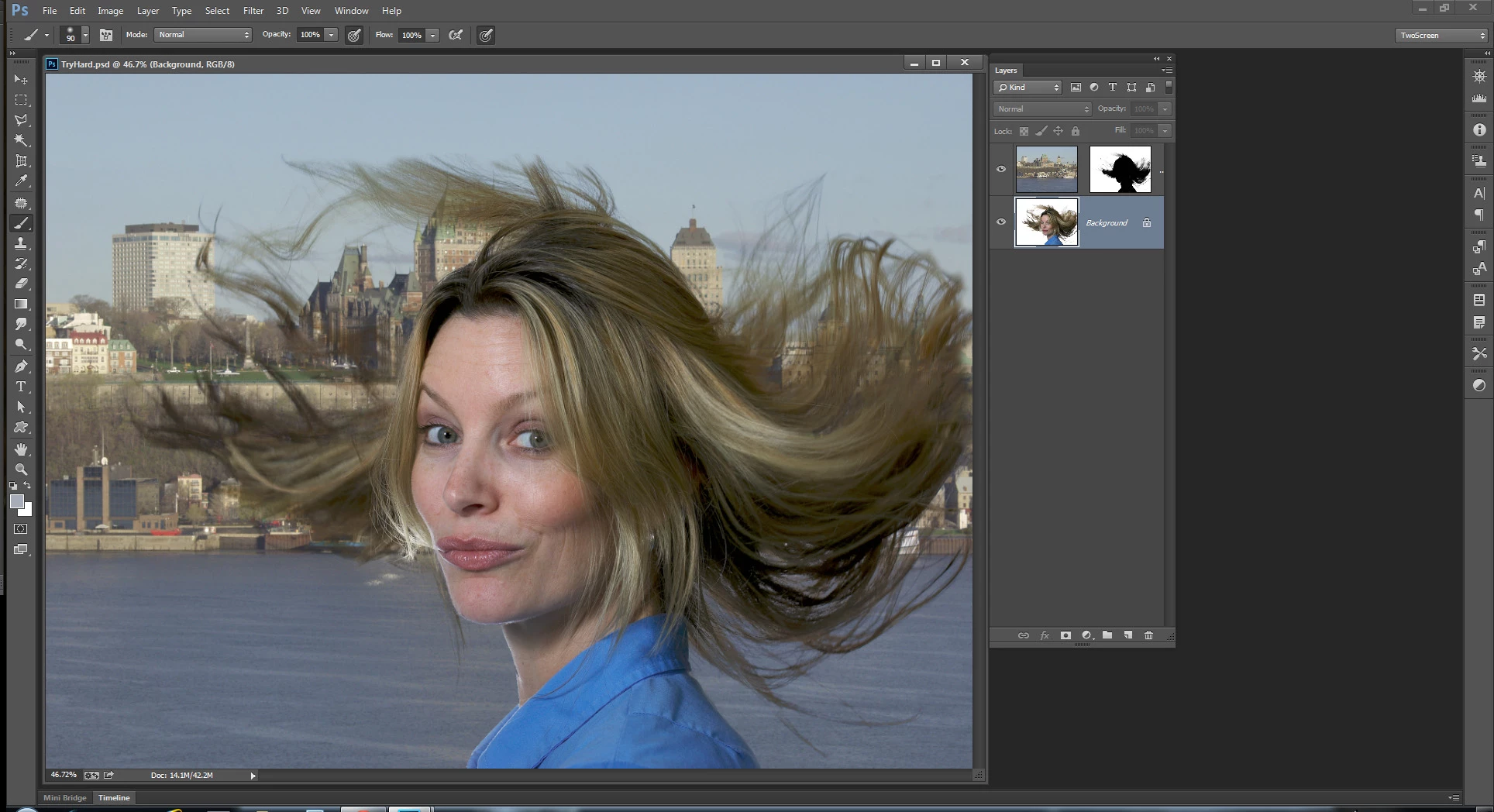

    Adding a new background replacement on top add a mask to that the cutsmask  some hair and the the fring, Hair can be recovered by change the replament layer blending mode to multiply for the original white background will change nothing but the hair masked off will blend in and darken composite. The white fringe will not darken the composite.
