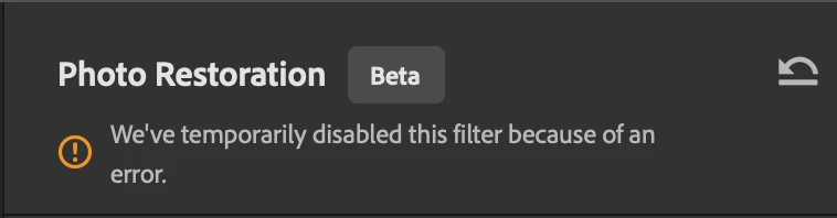

Photo Restoration Neural Filter Temporarily Disabled
The Photo Restoration filter inside the Neural Filters is temporarily disabled due to an error. I'm currently running macOS Ventura 13.0 and Photoshop 24.0. Is there a fix for this, or will I need to wait for a PS dot update?

I have reported this too, but have found a temporary work-around which appears to work for me. By default, the Neural Filter for Photo Restoration has the values set at Photo Enhancement: 50, Enhance Face 60.  When processing at these values on some photos of lower quality *say old B&W images.. you occasionally get the errror.
However if you turn the Enhance Face down to 0, and run the filter with just the Photo Enhancement & Scratch Reduction values set, accept the result and THEN, open Neural Filters again, setting the Photo Enhancement & Scratch Reduction to 0 (switching these off)  and then adjust the Enhance Face to a value, it processes it with no error.

Might be a good idea to change the syntax from "Weve disabled this filter because of an error" to "try setting face enhancement to 0" or such like. As that seems to cure it for me also, although I do actually want to use the face enhancement feature so its still broken for my intent and purpose.

So, here's my workaround while this error is occuring: The error usually occurs when there are too many faces in the photo (a group portrait for example). What I do is, restore the photo with no face enhancement, crop the photo down to contain only one or two faces, run the filter, copy the result, step back in history to the restored group shot again and paste the faces over the portrait. Then, I erase the surrounding elements, leaving just the restored faces.

Ok, I turned the "enhance face" to 0 and it worked on the picture that I had previously gotten the error on.

yeah...I hope it improves over time. You need to pull down the face enhancement tab to zero after it fails and then it will apply it's degraining but not do the face enhancement. No need to re run the filter. The message it gives you is really misleading.

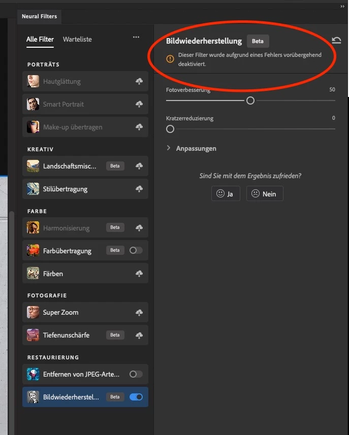

Fotowerkstatt2026
Mar 1, 2023 1:08 PM UTC
Is there any solution? I have the same problem on PS24.2 and actual Beta, the Neural Filters is temporarily disabled due to an error. New installation of flter and PS do not fix the problem.
Fotowerkstatt2026
Mar 1, 2023 8:44 AM UTC
Photo Restoration neural filter is deaktivated because an error (i don´t know which one?).
How i can aktivate this filter?
I have also renewed ths folder: Mac: ~/Library/Application Support/Adobe/UXP/PluginsStorage/
PHSP/22/Internal/com.adobe.nfp.gallery/PluginData
PS 24.2, mac

Fotowerkstatt2026
Mar 2, 2023 9:30 AM UTC
Hello Sameer,
thanks for your support.
A image with an identifiable face works on PS24.2 and on PS Beta.
My image has no persons, so there is an report "the Neural Filters is temporarily disabled due to an error".
