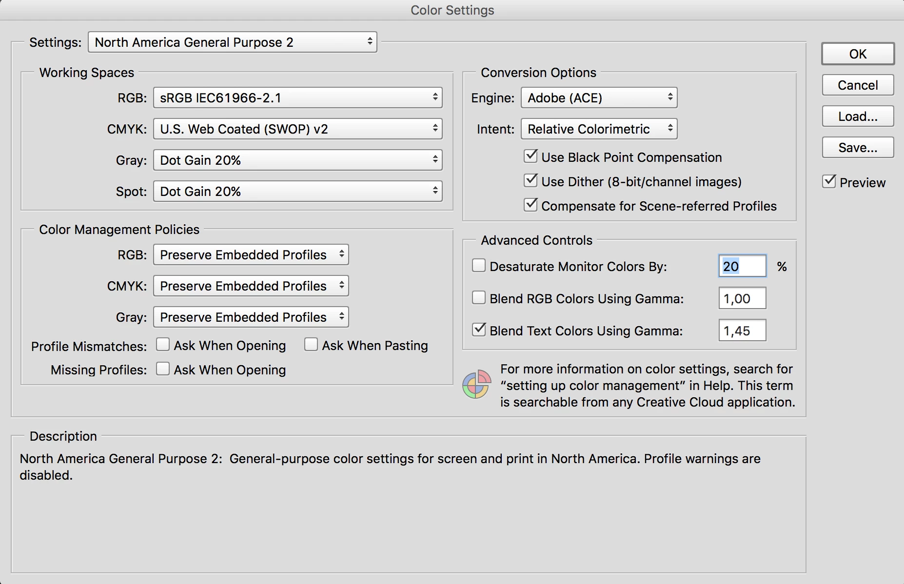

    November 16, 2015
    The result is to adjust the color settings in Photoshop and select Monitor RGB. Also select Bicubic (best for smooth gradients, then restart Photoshop.
    D Fosse
    November 16, 2015
    <sigh>
    No, monitor RGB isn't the solution to anything. If monitor RGB has an effect on this, that shows you have a broken/corrupt display profile and fixing that is the solution.

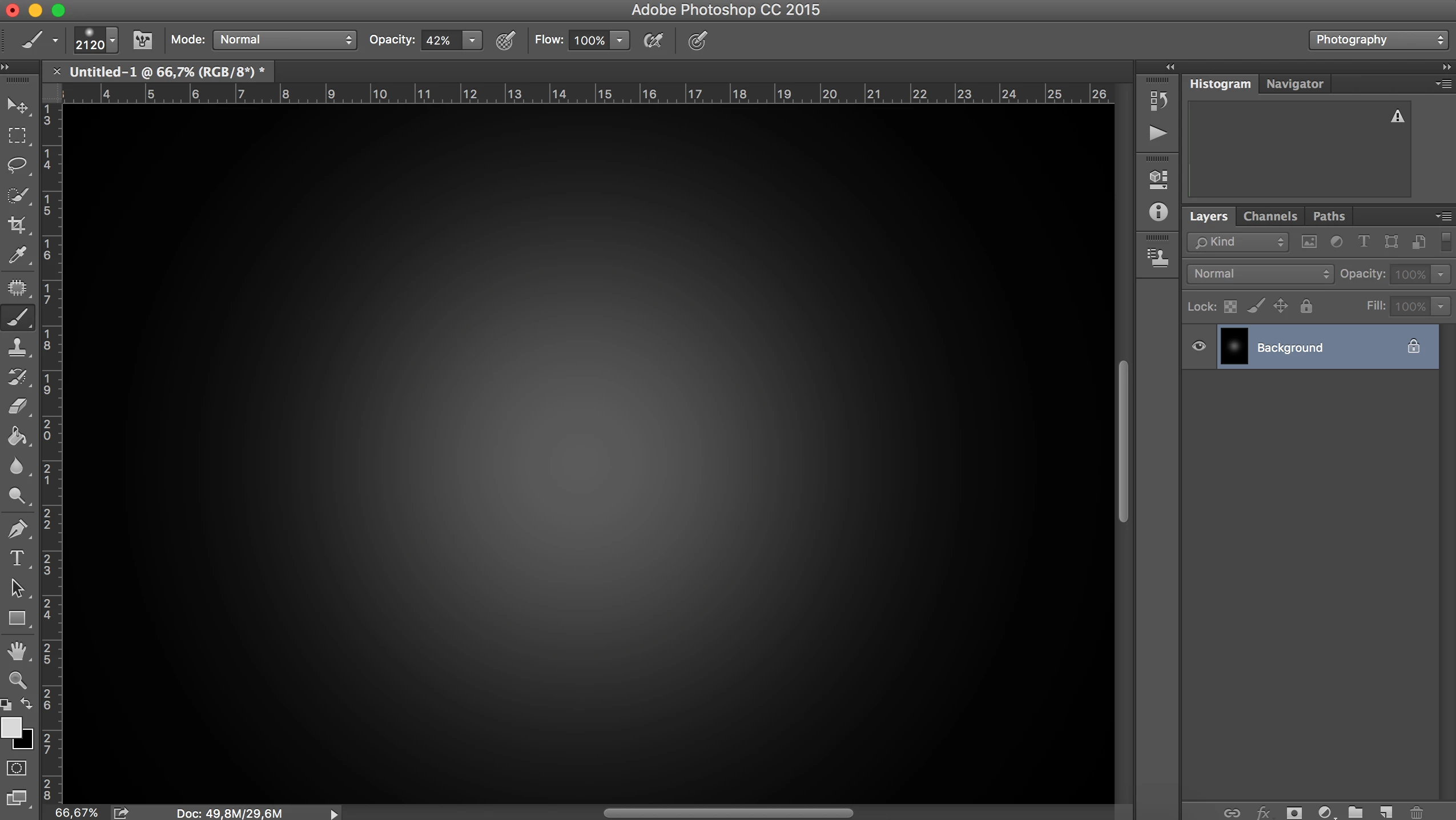

    Hi Guys. I am new on Mac and i have the same issue: Gradient Banding and also when i use brush with hardness 0% and opacity for example 35%.
    I recently buy macbook pro retina 2015 and I am dissapointed to find this issue on Photoshop CC 2015.
    Is there a solution? Thanks in advance.
    Herbert2001
    November 10, 2015
    What image mode are you working in? If 16bpc, there may be no fix. Switch to 8bit per channel or 32bit per channel. or do not zoom out.

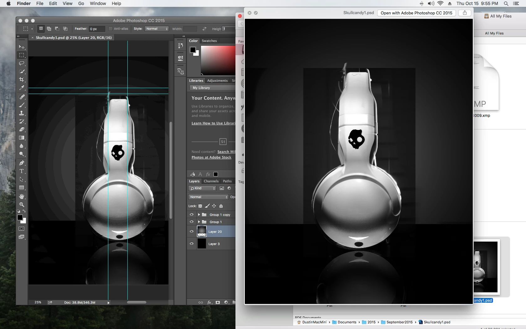

    Dustin157
    October 16, 2015
    Here is what is happening. Smooth gradient on the right in Mac OS X El Capitan's Preview, but the so-called "banding" occurs when I open and begin to work on the same file in Photoshop on the left. CMD+Option+Shift is pressed to reset Photoshop when the image is opened, but the problem still occurs.
    I've uploaded a picture here to show.
    Herbert2001
    October 16, 2015
    That is a known issue in Photoshop. Please read the earlier posts. It occurs when:
    1) you work with a 16bpc image
    2) you zoom out more than 64% (in my case it occurs at 65% and lower)
    According to Chris Cox (senior dev for Photoshop):
    The image zoom factor has everything to do with the image pyramid/cache levels. When you are at 100% or greater you are looking at the true image. When you zoom out to 50% or less you are looking at the downsampled image pyramid. 16 bit/channel images use an 8 bit/channel image pyramid to improve performance when you are zoomed out. In 8 bit/channel images and 32 bit/channel images this is not a problem, because the pyramid level bit depth matches the base level bit depth. Though in 1 bit/channel images the upper levels are 8 bit/channel, and can cause some confusion when bilevel images start showing averaged gray levels.
    I think this is a legacy "feature" to speed up calculations when 16bpc was first introduced in Photoshop. At the time the extra processing power to calculate a full image pyramid at 16bpc might have been an issue, but of course nowadays it is a extremely silly semi-buggy behaviour.
    You should also be aware of the fact that 16bpc mode in Photoshop is actually a 15bpc mode. If you import a true 16bpc image into Photoshop, part of the data is thrown away. This might be problematic in certain cases for 3d rendering and game textures.
    Anyway, to confirm whether you are experiencing the same issue, please convert to 32bpc mode (flatten if necessary). If the gradient banding disappears, you know that it is due to this legacy "feature".
    Ridiculous situation. Let's hope this "feature" will soon be removed - it makes working with 16bpc high resolution images in Photoshop rather difficult, if not impossible under circumstances.
