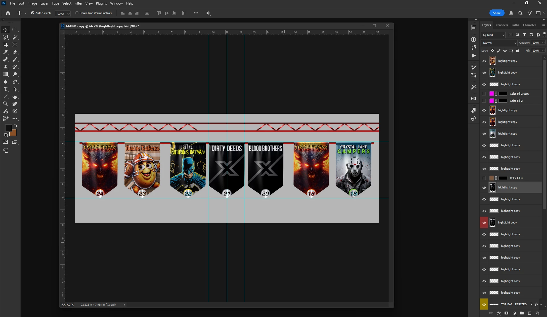

Hello Group,
I am pretty solid in PS and familiar with the distribution tool and it works nicely for setting layers at the same height or even the same width (evenly) across all layers in a row.
What i would like to know is there a way to set for example 1 layer center of the canvas and then subsequent layers to align from that center image a custom width value from it. (see examples).
I have been using guides to help me do this over the years and would like a better systematic way to do this approach if available.
Thank you

Chuck Uebele
February 9, 2025
Ha! I found the script and found another script that does what you want, except that it doesn't center the middle layer. It just spaces all the layers on a custom value in pixels. Here it is. For it to work, you have to select the layers that you want distributed.

umaynome
umaynomeAuthor
February 9, 2025
Nice, thank you again! I will try it out tomorrow and see how it works. The center default layer I automatically center it on the canvas myself so that isn't a issue.
Chuck Uebele
February 9, 2025
Well, after using the script, it will move the centered layer, so you would need to to select all the layers and snaps the group to the center. Not a big deal.
Chuck Uebele
February 9, 2025
I would say you need a script for that. I wrote one back before Adobe released the distribute with even spaces, but it would just be a matter of using input for the spacing rather than dividing the space between the objects.

c.pfaffenbichler
February 7, 2025
Could you please post screenshots with the pertinent Panels (Toolbar, Layers, Options Bar, …) visible?
I suspect this would need a Script, but that might need additional checks/rules in case the left and the right distance between the three layers are actually not exactly identical.
umaynome
umaynomeAuthor
February 7, 2025
C.Pfaffenbichler.... Thank you for the reply and i have posted the art. I can use guides to make this work as i have been but if PS allowed custom widths to be entered that would be ideal of course.
umaynome
umaynomeAuthor
February 8, 2025
I tried to get AI to make a script for this but to no avail as PS UI locks up when the script is running so you cant pick the next layer and next layer to sort out. I will try to rethink it with AI scripting but its not that big of a deal to manually do this with guides really.

umaynome
umaynomeAuthor
February 7, 2025
CE thank you for the reply and video, appreciated. However, I am aware of the distribute evenly in PS per my posting above, and if someone needed them evenly spaced that works wonders. However, i posted 5 compressed layers (no text), and what i am looking for is a way to custom set my width apart from layer 21, on layers 20 and 22, and then subesquently get the following layers 18-24 to fall in line at that custom width i set, rather then the evenly distribute width.
Hope that helps.
