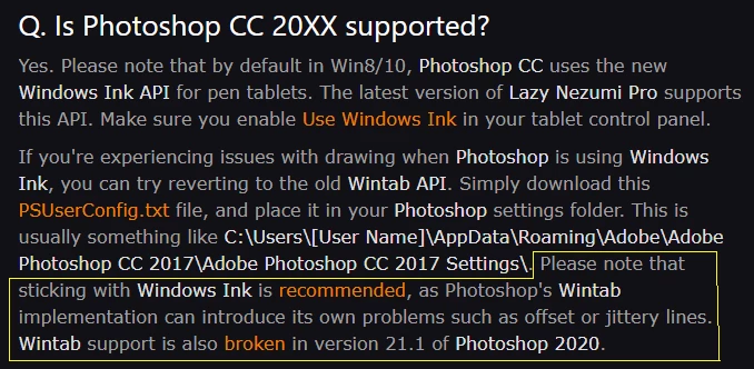

    I know this is an old post but leaving it here to help other people who are having the same issues. Follow the steps on how to disable Windows Ink. But if the issue still persists. Go to Wacom Preferences> Click on Pen> then under the Double Click Distance put it all the way to the left of the slider to turn it to small or turn it off entirely. This fixed the issue for me completely.

    We generally recomment the Windows Ink API with recent Photoshop versions, but if Wintab is working for you, go with that.  This comes from the Lazy Nezumi Pro FAQ
