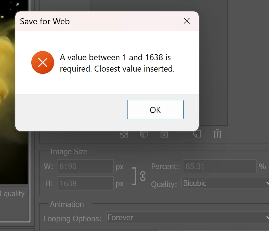

Ok, how can I check what are limitations?
The dimension limitations for Save for Web are 8192 × 8192 pixels. That is why a long dimension above 8192 is reduced to 8192. The limit exists because Save for Web is very old code, and that is why Adobe has named it Save for Web (Legacy). They want to remove this old command eventually.
There is a much newer command for web graphics export, intended to eventually replace Save for Web (Legacy). The new command is File > Export > Export As. The Export As command has no problem allowing and exporting a 9000 × 1920 px image in JPEG format.

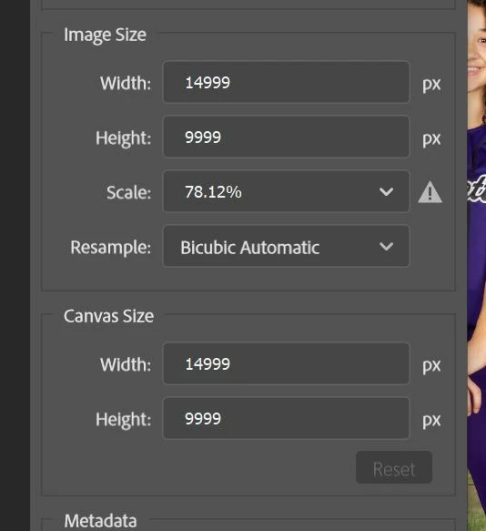

Jan 14, 2024 3:27 PM UTC
Although rare, I need a relatively large image size, about 20,000 pixels, for printing on a blanket to achieve 300 dpi with Printful's printer. However, when I upload an image at 15,000 pixels, which appears to be the maximum resolution Photoshop accepts, it only results in 126 dpi, which is below the desired quality.

Apr 27, 2023 2:00 PM UTC
I have the same issue, my image is 9,000 x 1920 px and when I tried to save for web as jpeg the sizi is changing to 8,192 x 1638 (85,33%)
Apr 27, 2023 2:05 PM UTC
This should not be a problem. The image is too big for the web. For the web, make it smaller. For non-web use, use SAVE AS or SAVE A COPY in the usual way.
Apr 27, 2023 2:44 PM UTC

Mar 24, 2022 7:24 AM UTC
I seem to have same or similar issue, but it's not always happening.
I have large file, 19200x12800 pixels. First time using "export as", it came out as expected full resolution. Next day it wouldn't export anything higher than 15000 on the long edge.
Couple days ago as I was editing further, export worked ok again. And now today it's again setting maximum 15000 pix on the long edge. Same PC, same PS, and same-ish file.
Mar 24, 2022 8:07 AM UTC
Tried restarting PS, still failed. Rebooted whole computer, then it exported at full resolution. Very strange.
Mar 24, 2022 8:34 AM UTC
The basic message above is: Export is for web use. This is, yes, a very bad name for a limited function. Since your file is way too large for use on the web, Adobe expect you to use Save as or Save a copy.

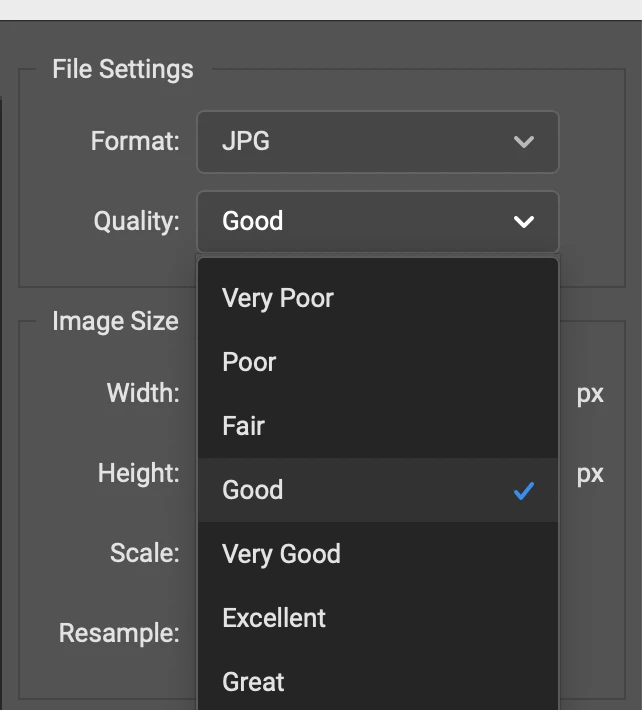

Jul 6, 2021 3:30 AM UTC
This is important...
There is no longer a way to specify the quality target percentage. Now you cant set the quality by numbers but only by adjectives (Good, Poor, great, and so on).
Please advice
D Fosse
Jul 6, 2021 1:00 PM UTC
The jpeg compression algorithm always worked in fixed increments, so the gliding % scale is a bit of a smokescreen.
I don't know how many steps are allowed in the jpeg specification. Photoshop itself has 12 steps, so this is apparently a simplified scale. Whether you can tell any difference in practice, I don't know. But I do suspect that this 7-step scale is the one that was used all along, just masked behind the % scale.
Another thing is that it was misleading. "100%" could easily mislead people into thinking the image wasn't damaged at all - which of course it was. Jpeg compression is always destructive, even at max setting.
Jul 6, 2021 2:03 PM UTC
Hi, thank you for the quick reply.
I hope I'm not derailing the original conversation but there was no other place I found about this topic.
Here is the thing....Before you were able to see and even set a target file size for the export. Now is a hit or miss.
