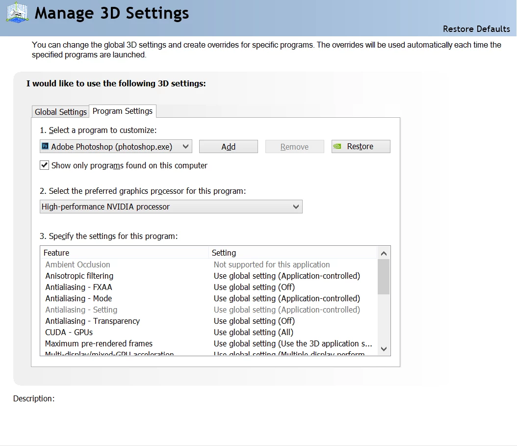

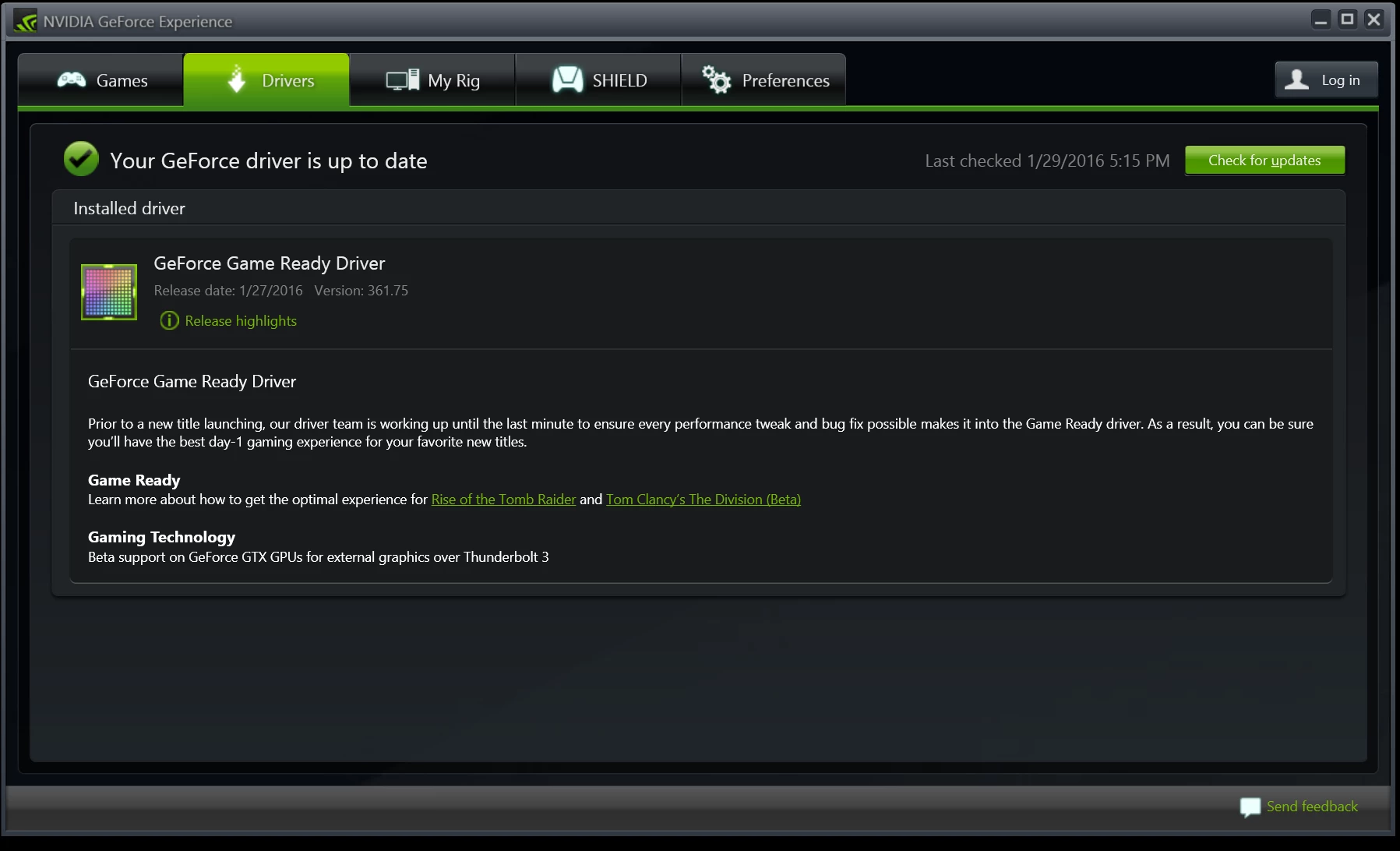

    I got this error today, as well. It was on a fresh install of both Photoshop and Windows 8.1, but not the latest driver for my 750m nvidia card.
    First, I tried rolling back to the driver from 12/1/2015, and it did actually prevent the BSOD from being triggered when photoshop tried to use the driver. Instead, it simply disabled the driver and was running with the integrated intel card. Not ideal, because then you're missing out on all of the power of the nvidia card.
    Then, I quit photoshop and updated to the latest nvidia driver, released 1/27/2016: 361.75. I performed a clean installation and did not install the physx engine.

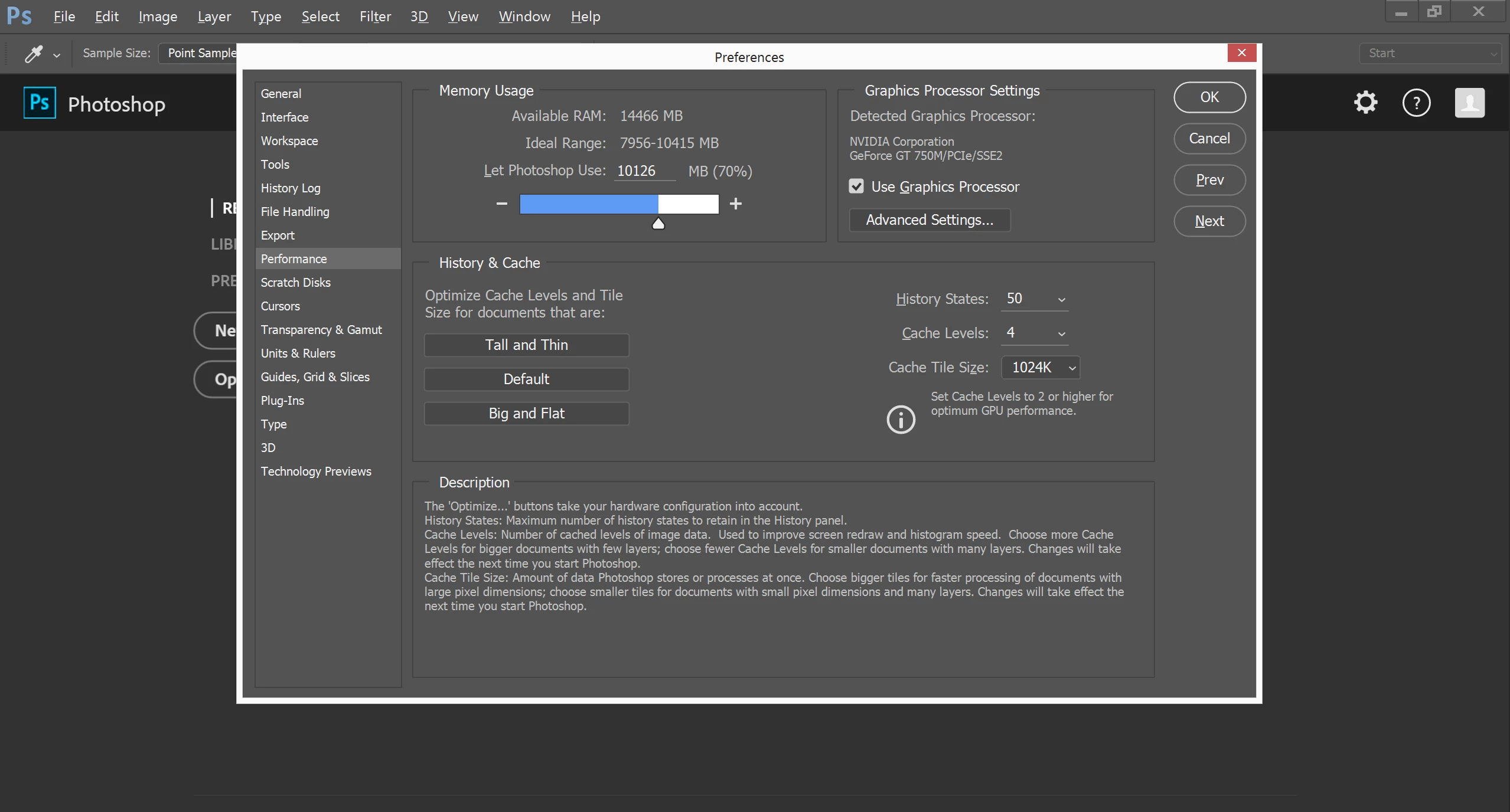

    After that, I launched photoshop again, and it still had the video card disabled in edit > preferences > performance. The button to change it was grayed out, too.
    So I launched the nvidia control panel, and explicitly set the graphics card for photoshop to always use the nvidia card. The next time I launched it, no immediate BSOD, and the nvidia card was enabled automatically in the performance preferences.
    Haven't played around with it much, so other people's mileage might vary.
    January 30, 2016
    Nevermind, I might have been a bit too hasty. While it says that the card is working, when I went to enable "advanced drawing mode" it disabled the card again. Was able to get back to the same spot displayed here, but still got a warning about it. So I'm not sure if it's actually using the card or just saying that it is...
