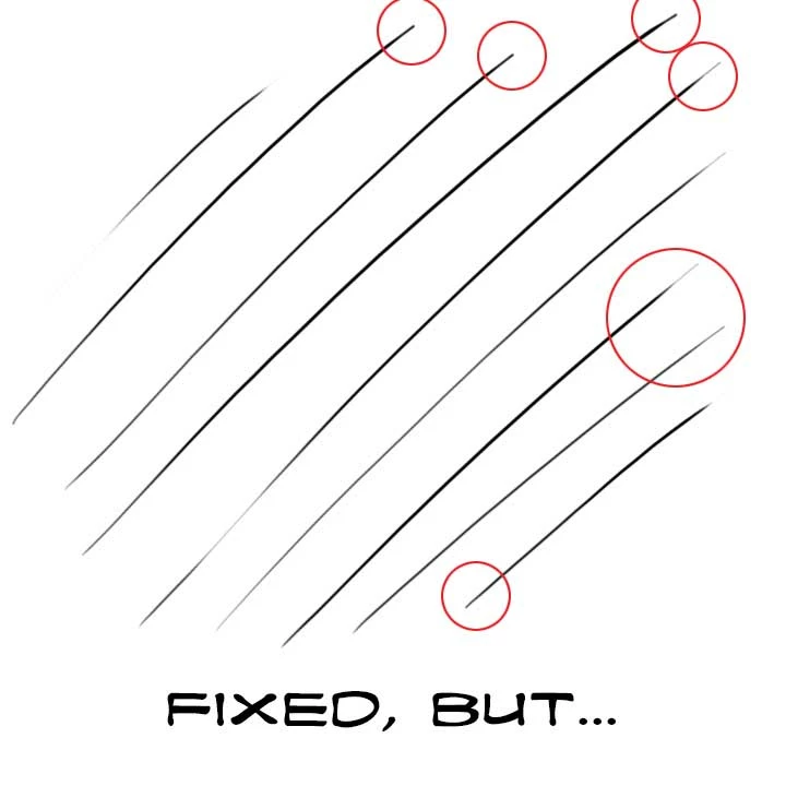

After installing the latest Wacom Driver (6.3.15-1) my brush sensitivity works, but the lines are strange & unpredictable. Strange enough, the line tapering still worked fine in all my other drawing programs (Manga Studio EX5, Sketchbook Pro 7, FlipBook Pro 6, Painter 13, ArtRage, Quixel Suite 2, ZBrush 4R7, Maya 2016 & Mari 2), so it's obvious that the issue resided uniquely between Photoshop and the new Wacom drivers. Here's what the lines looked like.
... and here's what I tried (in no particular order, but in many combinations of the following) within the Tablet Properties before resorting to reinstalling drivers and those endless reboots:
  • Adjusted the firmness
  • Checked & unchecked "Use Windows Ink"
  • Turned on & off "Tip Double Click Distance"
  • Uninstalled and reinstalled the Wacom Drivers
  • Boots & Reboots of OS and Photoshop
All to no avail. The line quality was still strange & unpredictable.
So it was now time to begin kicking around the drivers. After the latest uninstall/reinstall, and on a hunch, I decided to fire up Photoshop BEFORE loading my Wacom preferences. Lo and behold, the tapering was working as hoped. At that point I reloaded the prefs, but the lines were—again—strange and unpredictable. Even when I deleted the prefs from the Wacom Tablet Properties, the problem persisted but it was obvious to me the line quality was even worse now.
Okay, obviously it wasn't either the drivers or Photoshop entirely at fault, but some kind of legacy issue with my old preferences that was jacking the brush sensitivity inside of Photoshop. I went back into the prefs utility and removed ALL the preferences, rebooted my machine and voilà! Sensitivity restored! Drawing lines is consistent and predictable. The following image shows that in spite of being an amazing piece of imaging software, PS has a few shortcoming when drawing lines. It's not great, but it works!!
Okay, so everything is working again. However, it appears I'll have to reconstruct all my prefs from scratch (which completely blows) but at least there's a way for me to get back the functionality of Photoshop's brush sensitivity "per spec". Ultimately I don't know if the problem resides with Adobe, Wacom, Nvidia, Apple (Boot Camp) or even Microsoft—but rather than scream into the wind—it's simply easier to launch whatever software best suits the creative requirements at the moment. In my case, there's at least two really good companies that simply haven't hit that sweet spot "yet".
On a side note it's easy to bash developers, but keep in mind the scope of the feature sets, stability, capabilities & compatibilities .. and you may begin to understand just how amazing it is to create something for mass consumption, let alone at the quality Adobe does so with consistency. Sure there will be hiccups and shortcomings, but overall it's a stellar piece of software. Don't get me wrong, I'm a huge fan of many competing products, but Photoshop still remains my "go-to" imaging software. Is it perfect? No, but it's still a premium tool.

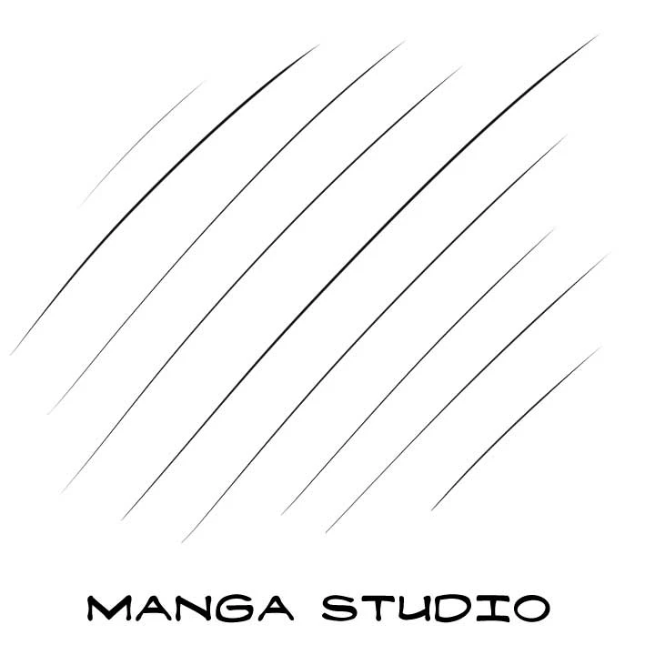

It'd be awesome to one day see Photoshop match the quality of line-weighting available in Manga Studio, but I'd rather see a better Typeface and Font family management tool first ... among other things. Here's a sample of the line quality from Manga Studio. By far the best and most accurate I've ever experienced to date.
BTW, I'm not affiliated with any software company in any capacity. I simply wanted to provide some visual context to my aforementioned opinions.
Anyway, hopefully this helps someone.

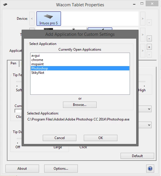

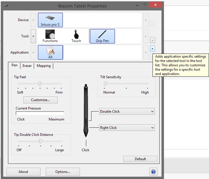

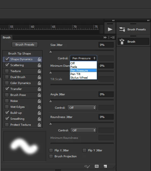

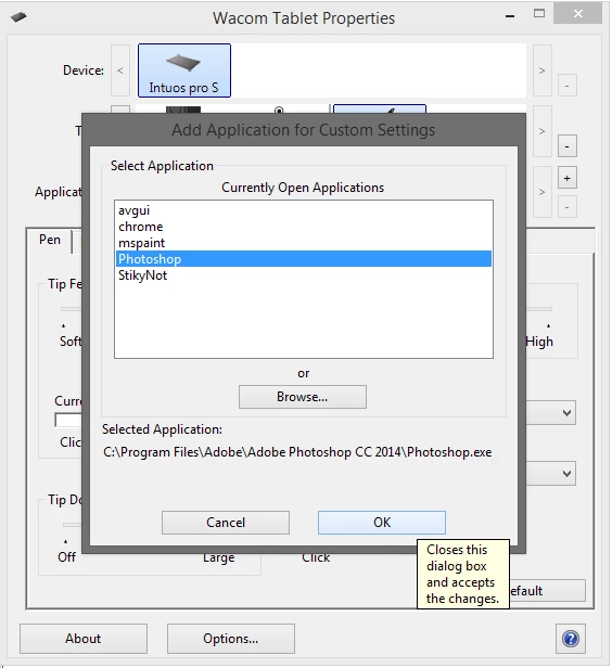

Firstly i Fix this issue out by: For Windows
Make sure you have the latest drivers for your Wacom model before you do this!
Drivers | Wacom
1:      Close and reopen Photoshop.
2:      While Photoshop is open, go to your Wacom tablet properties. ( by clicking on it in your notification area of your task-bar desktop.)
3:      Then delete the current Photoshop application if you had added and add it back in by clicking on the "+" on the left of the interface in the row "application".
Now go back to Photoshop and try your pen pressure, make sure you choose (bush>Shape dynamics>Control > Pen pressure
