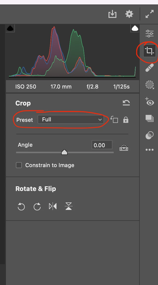

Correct answer Vanessza
I ran into the same problem, and this is the solution I've found: After you open the raw file in Photshop Camera raw go to the Crop section on the right side and set the Preset to Full.

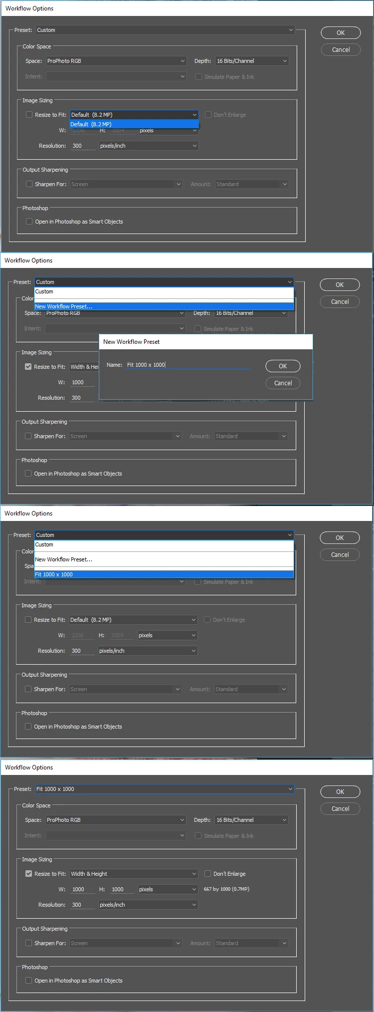

Hey James,
Open preference dialog (CMD K) > Workflow > Image Resizing > Untick resize to fit > Change your height parameter from 5120 to 5760.

VanesszaCorrect answer
September 19, 2022
October 23, 2022
This cropping problem just started with me when the automatic PS version update happened a few days ago. JPEG files ooen fune, but raw files are cropped. My crop setting is at "full", but I still have to go in and adjust it manually for each image imported. I don't know how many version updates I've gone thru over the last 10+ years and this never happened with any of them. The Adobe help desk didn't or couldn't....

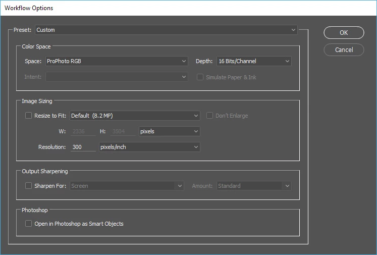

Check your ACR worflow options.
JJMack
JamesCrow
JamesCrowAuthor
October 26, 2017
I've tried going to here sadly. All I get is the default image option in sizing?
JJMack
October 26, 2017
Did you save any workflow presets?
