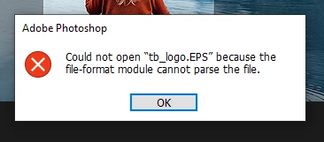

Hi. I tried workaround but it isn't work.

I'm assuming you are on Windows? Is this the latest Photoshop? (22.4.x)
What program made the EPS?
If you select Generic EPS in the Open dialog (as opposed to Photoshop EPS), does it sill error out?
Does it happen if you drag the file to the PS App icon?

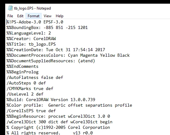

Open the file with Notepad. A proper EPS file will have this somewhere in the first line : %!PS-Adobe-3.1 EPSF-3.0
It will also tell you the Creator : (program and version) a couple of lines down.

Hi. I work on windows 10 and PS 22.4.3. I tried to open different eps file, most of them exported from Corel Draw and Ilustraotor.
If I select Generic EPS in the Open dialog I got error like above.

August 10, 2021
Well that looks a proper header, so there must be some corruption further into it.
Two suggestions:
1. Do you have Illustrator? Maybe try and open it in that and resave as a new file. (the danger there is that there may be something that doesn't translate properly)
2. Open it in Acrobat, which can force it to be distilled into a PDF
I can take a look at the file to narrow down the problem in case it is an issue with PS and not the EPS itself.

August 5, 2021
Hi @Tomasz5E4E
I don't think you have the same issue as the thread where you posted, so I've branched it. The most likely reason for your error message is that the file has the wrong extension. Try a few other extensions (such as jpeg) and see if that works.
There was an issue that was fixed in 2018, so please tell us you OS, PS version, and computer specs if the above does not work.
