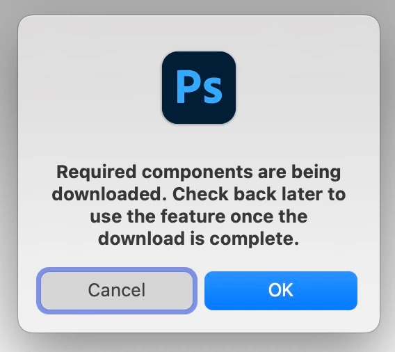

Remove tool doesn't work, needs to download components
Hello, I have installed the latest version of PS but when I try to use the Remove tool, I receive the message "Required components are being downloaded. Check back later to use the feature once the download is complete.
It actually downloads nothing and every time I try to use this tool, the warning message appears.
any ideas how to fix this?

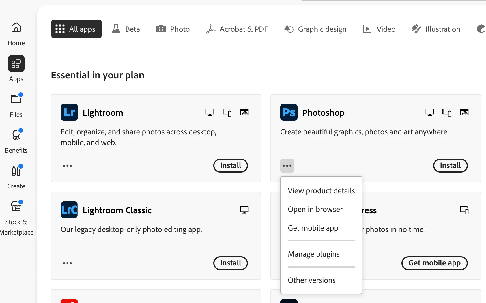

Hi @teokefalopoulos,
I understand how frustrating this can be, especially when you’re eager to use the Remove tool. To resolve this, please follow these steps:
1. Open the Creative Cloud Desktop app.
2. Navigate to Apps > All Apps and locate Photoshop.
3. Click on the three-dot menu (ellipses) next to Photoshop.
4. Select Get Add-ons.
5. Under Add-ons, find the components for the Remove tool and click Add to download them.
Once the components are installed, the tool should function as expected. Let us know if this helps or if you need further assistance!
Best,
Anshul Saini

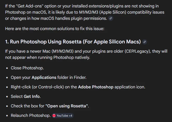

Get Add-ons is not an option on my macbook pro.
With regards to hardware and software:  I have a Macbook Pro M5 Pro, everything is up to date.
Ged_Traynor
Apr 21, 2026 7:23 AM UTC
​@CW_McGowen you may need to run Photoshop under Rosetta, the below is from a Google search

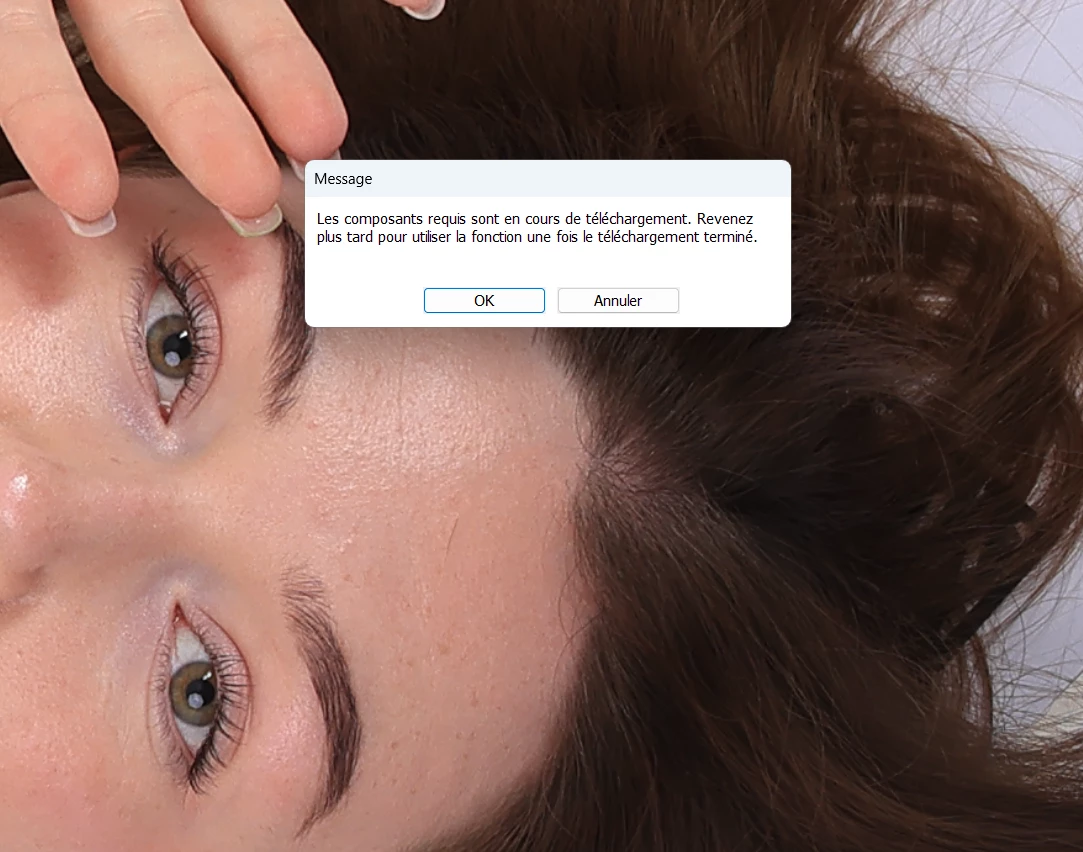

May 28, 2025 8:00 AM UTC
depuis la derniere mise à jour l'outil supprimer  ne fonctionne plus photoshop me dis  que lesq composant sont en cours de telechargement mais rien !!
