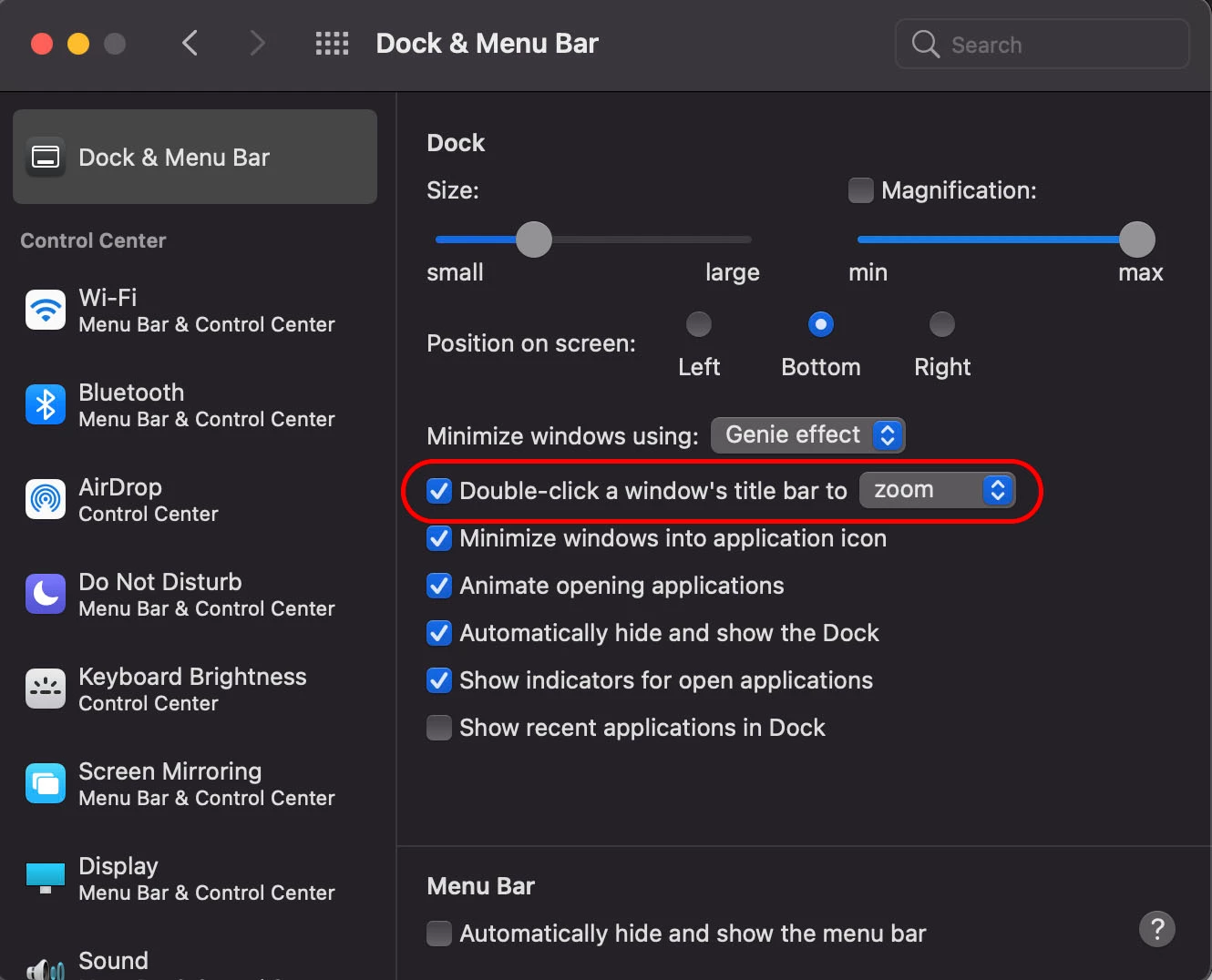

My issue was a little different. After unplugging from external monitor, my Adobe application windows (PS, AI, ID) would be off screen to the side of my laptop screen, and hard to move it over into my view just to get the green dot in the top left corner. In the past, I would double-click the top bar and it would fit to screen. Now with the Big Sur update, you have to specify this action in dock settings. Wanted to share for anyone having the same issue.
Mar 28, 2021 5:28 PM UTC
Design_Girl
Mar 28, 2021 6:40 PM UTC
@Lacey Blair Can you please specify where this is located and the OS? Thanks!

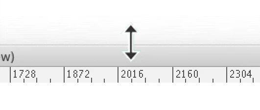

Sep 27, 2019 7:58 PM UTC
 Put your cursor over the window bar (so it turns to the ma-bob shown). Resize. Done. Both Apple and Adobe are legacy product companies, which is meh.
