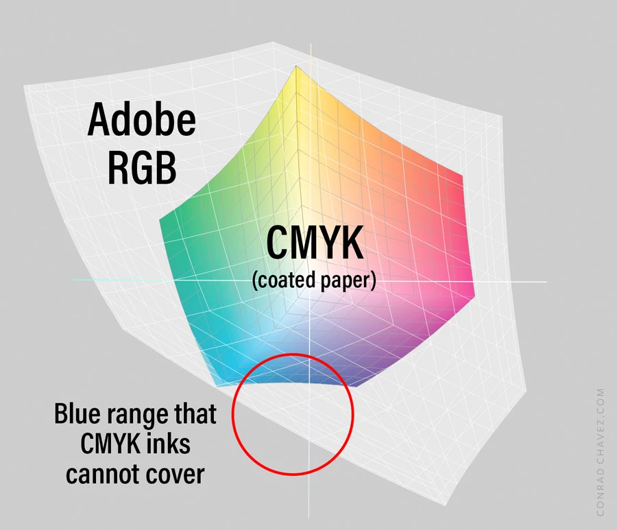

The picture below, made with Apple ColorSync Utility (which comes with every Mac so you can try this yourself), shows the color coverage of Adobe RGB compared to the profile for a CMYK standard for coated paper. If your job targets a CMYK profile representing uncoated or lower quality paper, the CMYK color coverage is even smaller.
