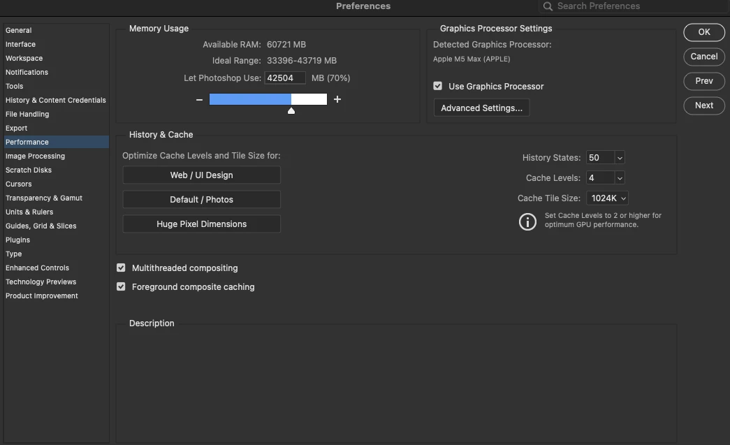

    ​@KSNelson I normally take one of the corner handles in the ‘white squares’ and rotate that. I am on a MacBook Pro M5 Max, so, not able to replicate your same issue. But it shouldn't be an OS issue. I can see that you have rotated the duckling. I would look at Photoshop Preferences > Performance and try turning Use Graphics Processor off. Click OK, then restart Photoshop. This step is important because I don't know whether Photoshop fully applies the new GPU configuration immediately. Test the Rotate Object tool again. If it rotates without any issues, then the problem may be related to GPU acceleration, the graphics driver, or Photoshop's interaction with the GPU. It doesn't necessarily mean you should leave the GPU disabled permanently, but it would help narrow down the cause.
