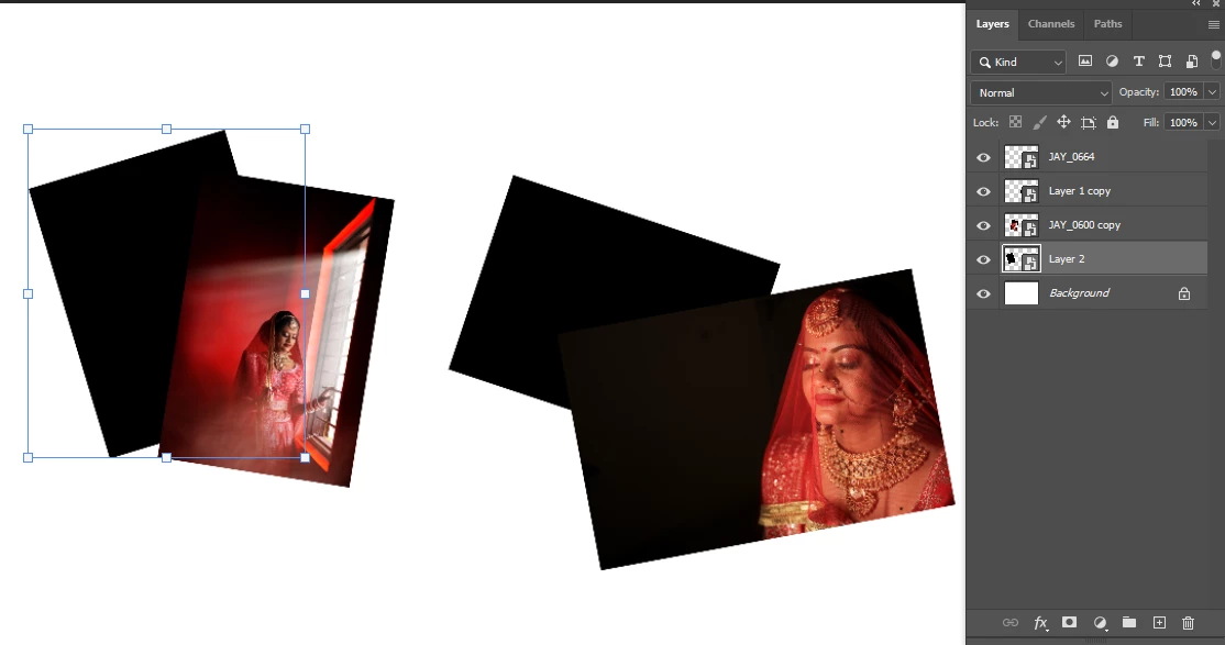

Rotate the selected layer according to the layer below
First fit the selected layer according to the layer below then rotate the selected layer according to the position the layer below is rotated.

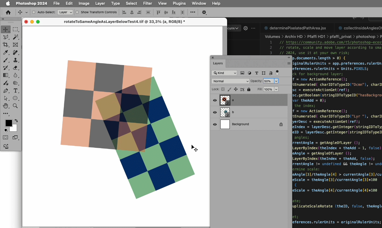

Sep 21, 2024 12:10 PM UTC
https://youtu.be/QZoYYLSABVs?si=kJf1onjcRinp007W
Sir this is a common problem. This problem occurs because the layer height size and layer width size are not fixed. Space is left above and below the level. The level does not fit. This space should not be left. The top and bottom layers should fit. It doesn't matter if the left and right sides of the side don't fit.
// rotate, scale and move layer according to smart object immediately below;
// 2024, use it at your own risk;

c.pfaffenbichler
Sep 28, 2024 1:27 PM UTC
There was a mistake indeed; I updated the code, please try again.

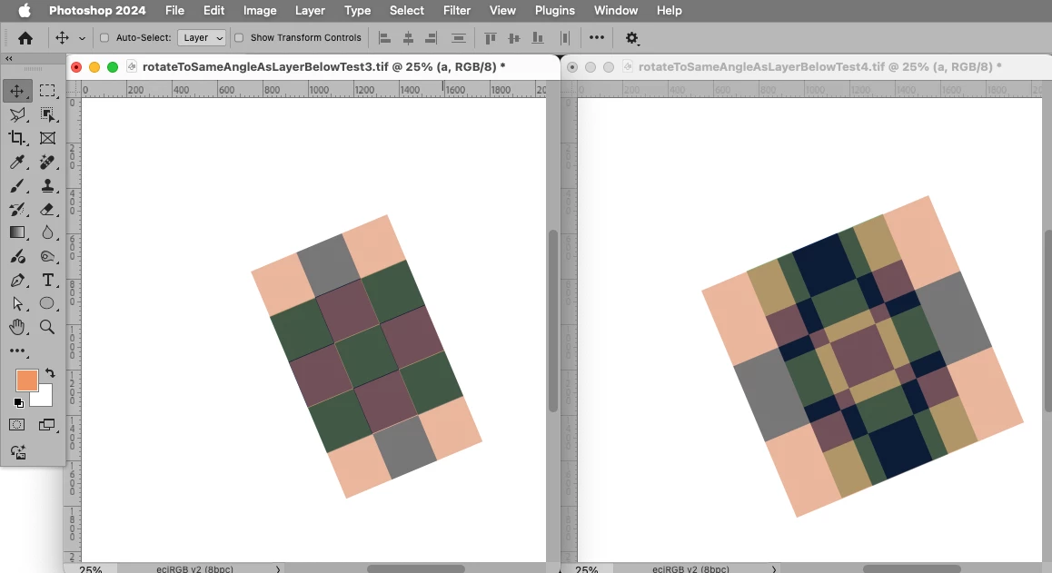

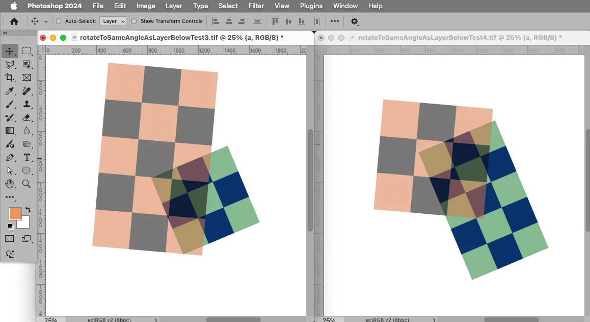

Sep 1, 2024 9:53 AM UTC
Could you please post screenshots with the pertinent Panels (Toolbar, Layers, Options Bar, …) visible?
Is the lower Layer a Smart Object? If it is not, but rather a plain pixel Layer, the concept of »rotation« would not apply because the Bounds define a rectangle with vertical and horicontal sides.
Sep 2, 2024 5:15 AM UTC
c.pfaffenbichler
Sep 4, 2024 7:11 AM UTC
