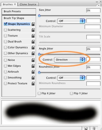

    Mar 30, 2010 9:28 PM UTC
    Try this. The angle orients itself to the direction of your stroke. Edit: adjusting the jitter % will throw in some randomness to the orientation.
