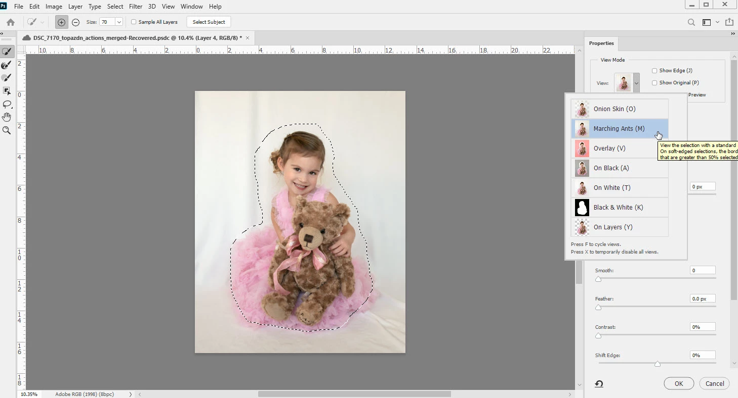

I made a selection and opened it in Select and mask with "Marching Ants" selected in view
That does show the marching ants :

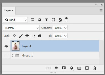

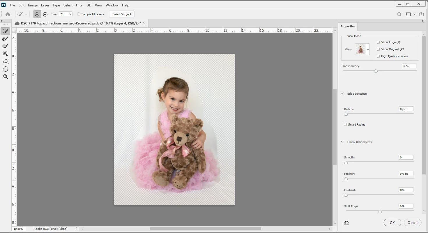

At first onion skin and View on layers appeared to do nothing. But the reason was simple.
The layer being used in Select and mask was a merged copy of the layers below. So any onion skin or view showing selection against the layers below was showing against exactly the same image.
I grouped all the other layers and turned off visibility - now onion skin and view on layers show against transparency.
In other words "onion skin" and "View on layers" were working correctly. They just appeared not to be working as the subject layer and the composite of the layers behind it were identical.

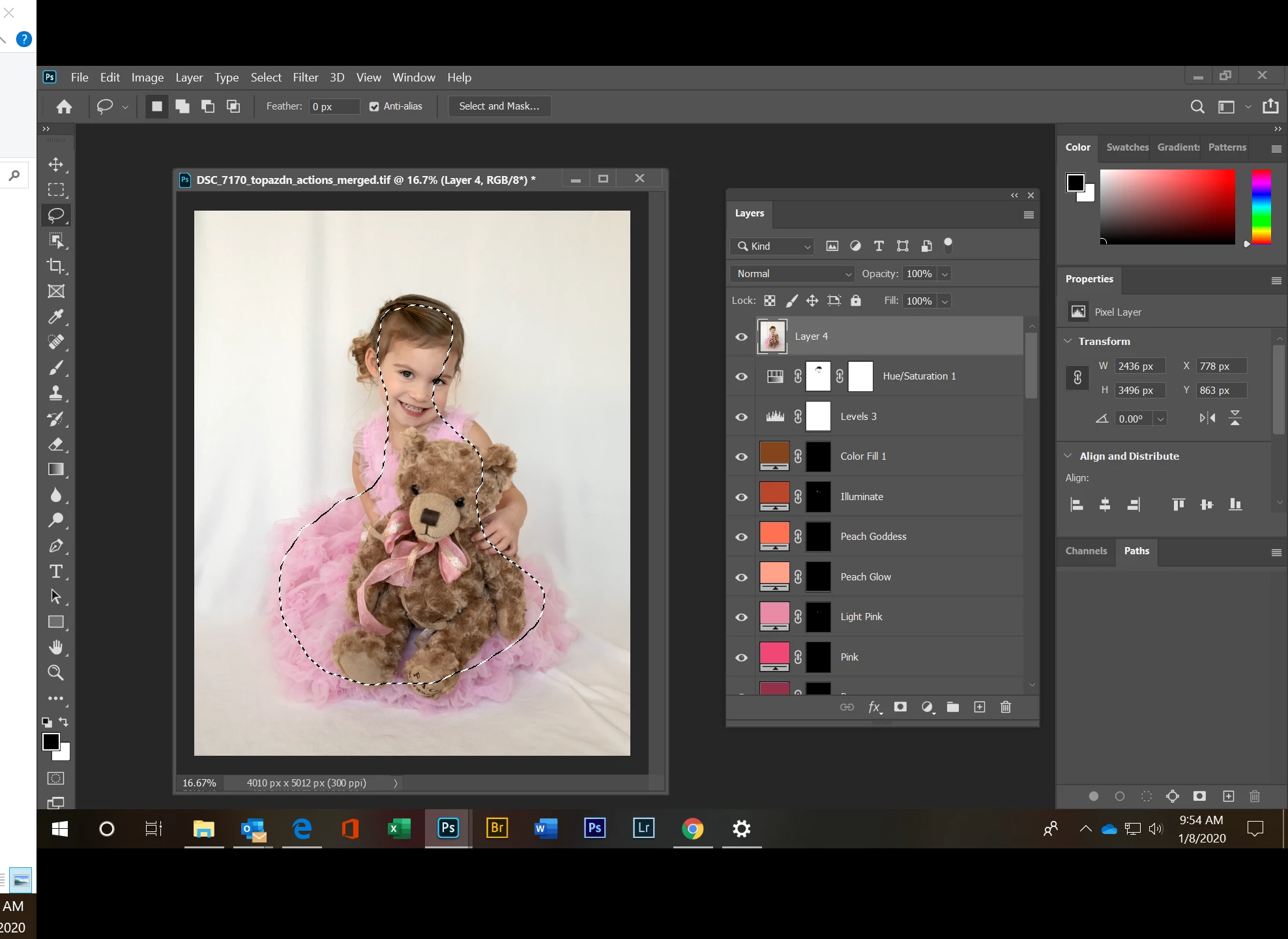

Can you show two fullscreen screenshots.
The first showing your selection just before you enter select and mask - please make sure the layers panel is visible.
The second immediately after opening select and mask

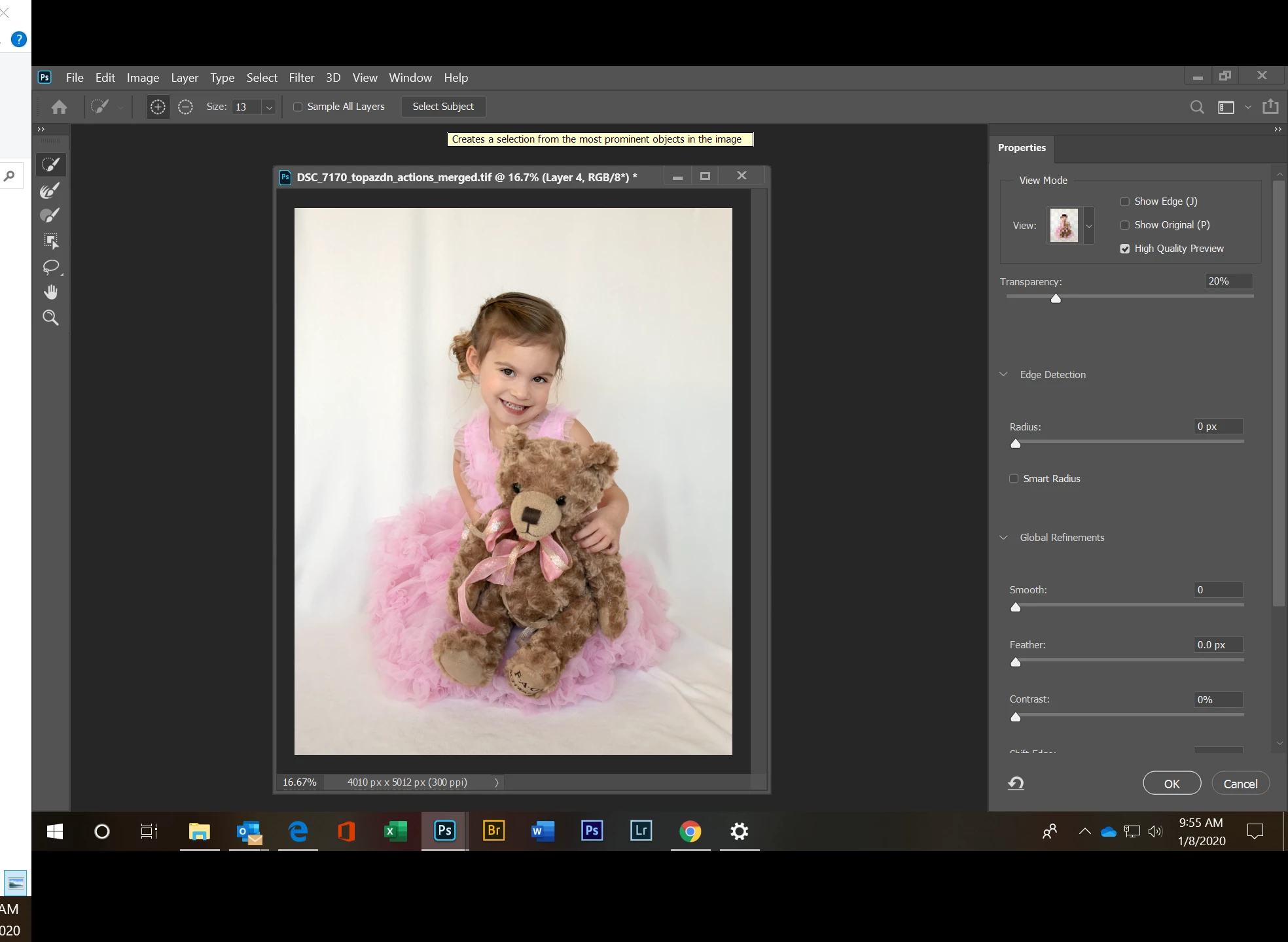

cindyb5858
Jan 8, 2020 3:14 PM UTC
First with selection, second in select and mask.  Notice that my layers panel is gone.  Everything is gone.

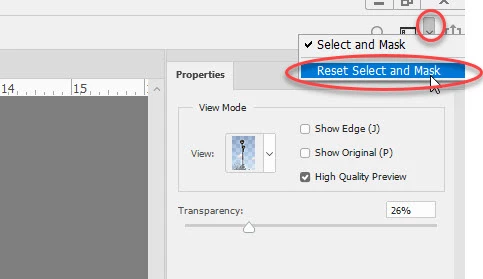

davescm
Jan 8, 2020 11:18 AM UTC
Hi
Try going to the top right of the Select and Mask workspace and press "Reset Select and Mask"
Dave
