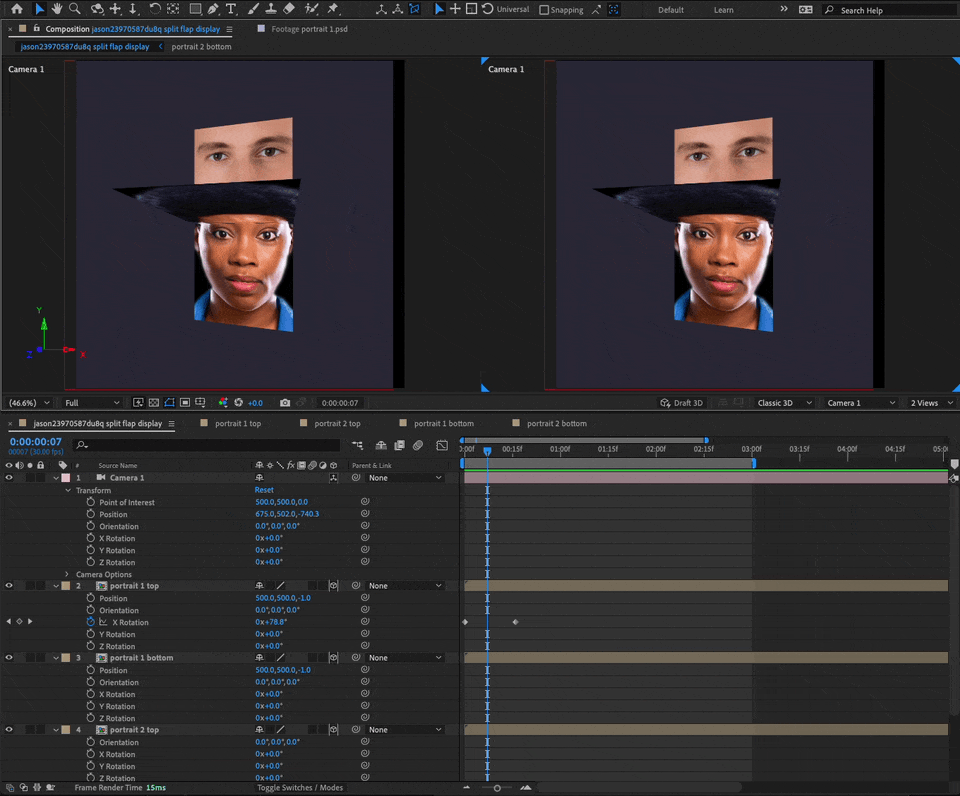

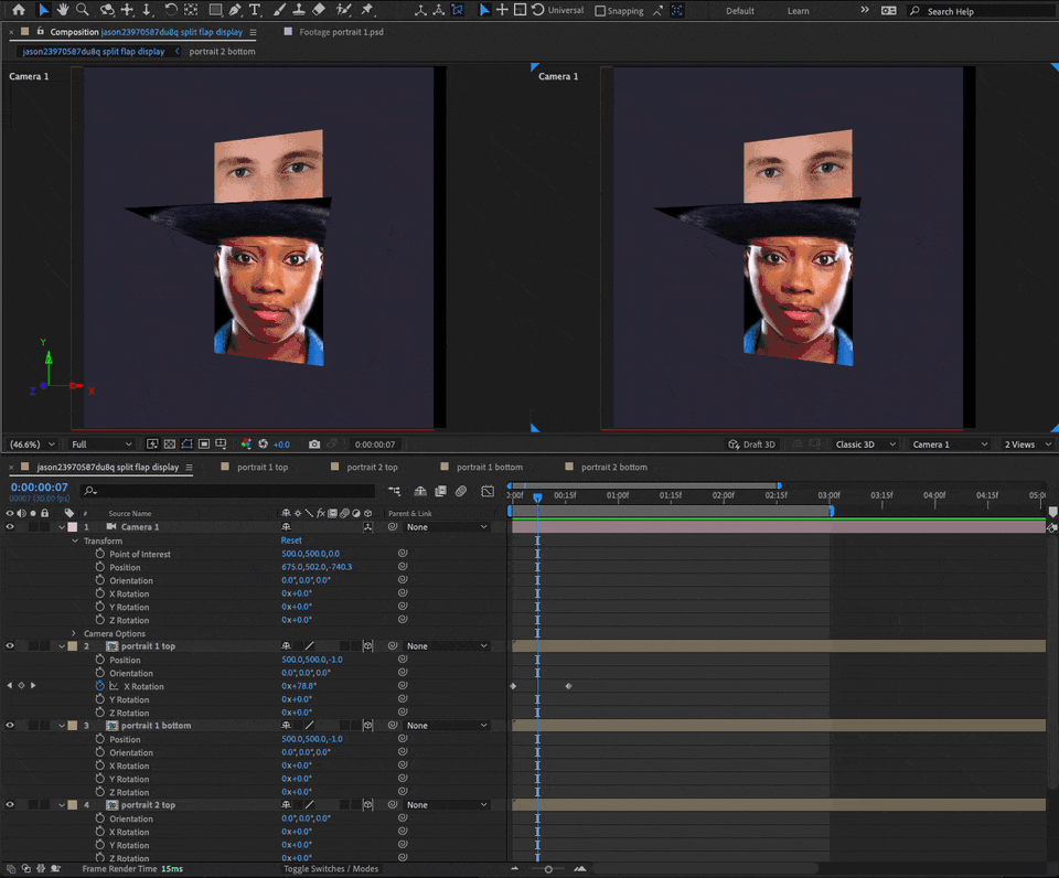

Decided to give it a shot…the demo below was created by prepping two portraits in Photoshop, and bringing them into Adobe After Effects. It was created using 3D layers so that you could see what was going on from the side, but you could just show it from the front if you want. But setting it up as 3D would allow things such as seeing the ends of the flaps come forward and the flap itself in perspective as it falls around.
I’ll caution that this might take a very long time for a beginner, because many steps require familiarity with a long list of After Effects fundamental skills. I am not a pro at this but I know just enough to suggest how this might work.
Edit: Also, Mylenium reminds us in another reply here that there might already be effects in After Effects that do this kind of thing, so maybe you don’t actually have to set up everything I show below.
Ingredients:
  • Each portrait set up in Photoshop in a single image of the correct proportions for a top and bottom flap.
  • In After Effects, set up a parent composition at the pixel dimensions of a single flap pair.
  • Each portrait image is in its own composition.
  • In each of those, add a vector mask to reveal only the top half. Duplicate the composition and move the mask to reveal only the bottom half.
  • Add this pair of compositions to the parent composition, so that this “flap pair” becomes nested comps within the parent composition.
  • Add another pair of compositions set up for the second portrait.
  • For the layer of the top flap of the first portrait, set up X axis keyframes for the Rotation property. Between the first and second keyframes, apply +180 degrees rotation.
  • Repeat for the layer of the bottom flap of the second portrait, but it should start at -180 degrees and end at 0 degrees. (After Effects pros would probably tell me I need to just parent that property to the other flap so that it follows along.)
This is only a quick and dirty attempt, so I left out lots of details, and there will be refining to do, such as making sure the layers of the first and second portrait are offset so that they don’t show through each other during the rotation. Again, someone with After Effects training would look at the steps and say “Ah, I get it, and here are the further problems we need to solve to make it look really convincing.”

Nice job Conrad.   I had planned to make use of the flicker effect we might see with a real life split flap noticeboard at a railway station, by way of example.  That would work with the jerky stutter effect we associate with Frame animations. In fact, if I was doing it with video I'd slow the flap movement to 12fps.
You have done a lovely job of pivoting the flap, so to speak, complete with perspective.  I was going to cheat and try for a Rollerdex effect with intermittent frames of black and the top of a random character.  A dozen such frames before snapping to the end text and hope that the viewer's eyes and brain would put it together.  This would be easy to edit, but you need to Export > Save for web every time you edit.  That's why I was saying that an interactive display was beyond my skill set.

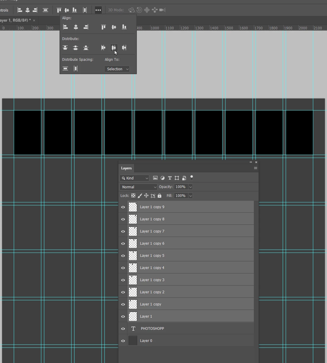

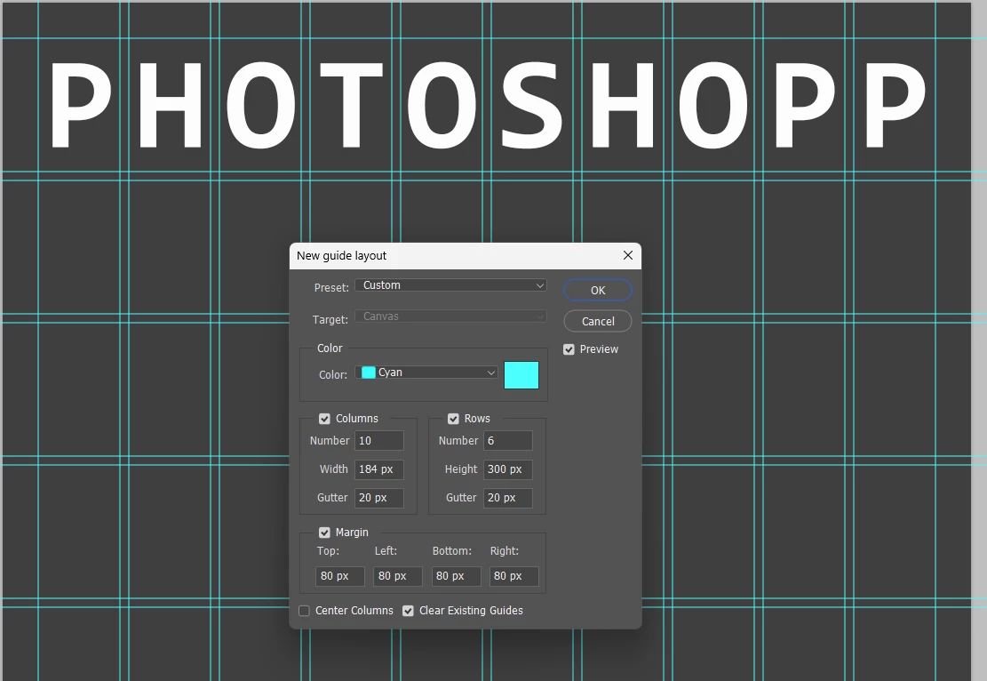

It would be easy enough to build from scratch and design to your liking.  You'd need a monospaced (Fixed width) font like Courier (Consolas Bold worked better).  Using this ready made one as a template, which has ten characters wide and seven deep, (but make it any size you like.
What I did is lay some text on top of the the above template and matched its hieght, and adjusted tracking to match the spacing.  It was then fairly easy to work out a guide layout that fitted, but I could have set the guide layout first and adjusted tracking to fit.  Bother ways work.  I am not sure that Consolas is perfectly monospaced — what do you think?
Set up blanks to knock out the holes for the letters
Merge those layers, copy again and space for the rows.
New layer at the top of the stack for the front face.
Ctrl click our merged blanks layer to load the selection, and add a layer mask to the front face.
You can lose the blanks now. We don't need it any more.
OK, Layer style bevel & Emboss for the depth, and outer glow rather than drop shadow when you want a fairly hard  and centralised shadow.  You need to change the default blend mode to Multiply.
The flip panels will be easy, but I am having to think about the line through the letters.  And I can see that those flip panels are going to cover most of the outer glow I thought I was being so clever to use.  Hmmm.
OK< that surely gives you a start.  You can use a simple frame animation to animate the text change, and two layers of text with a blank between so one reveals the other when changing.  I'd like to see a video of that operation so we'd know how to animate it.
